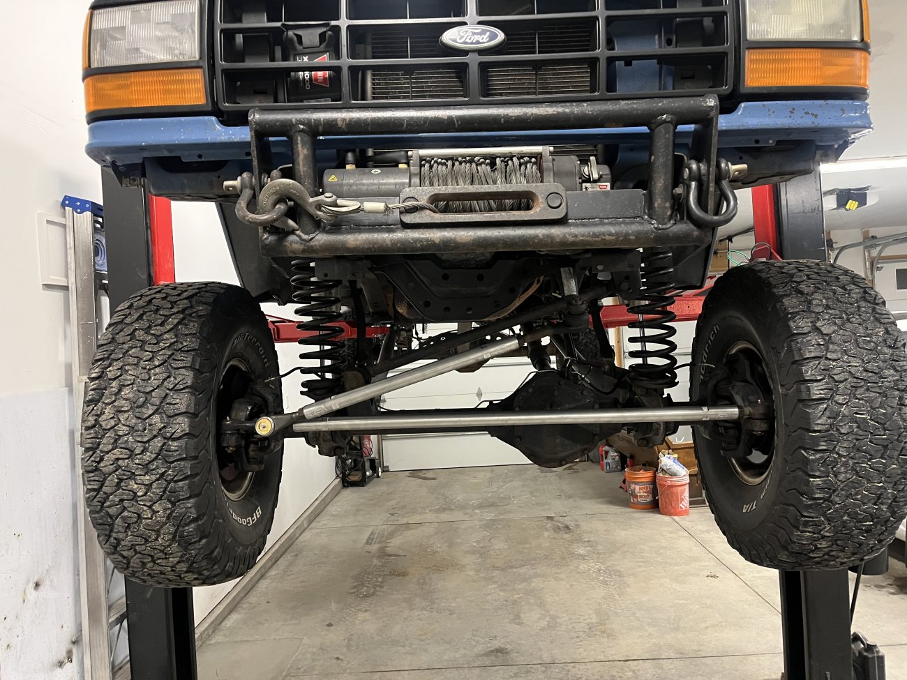

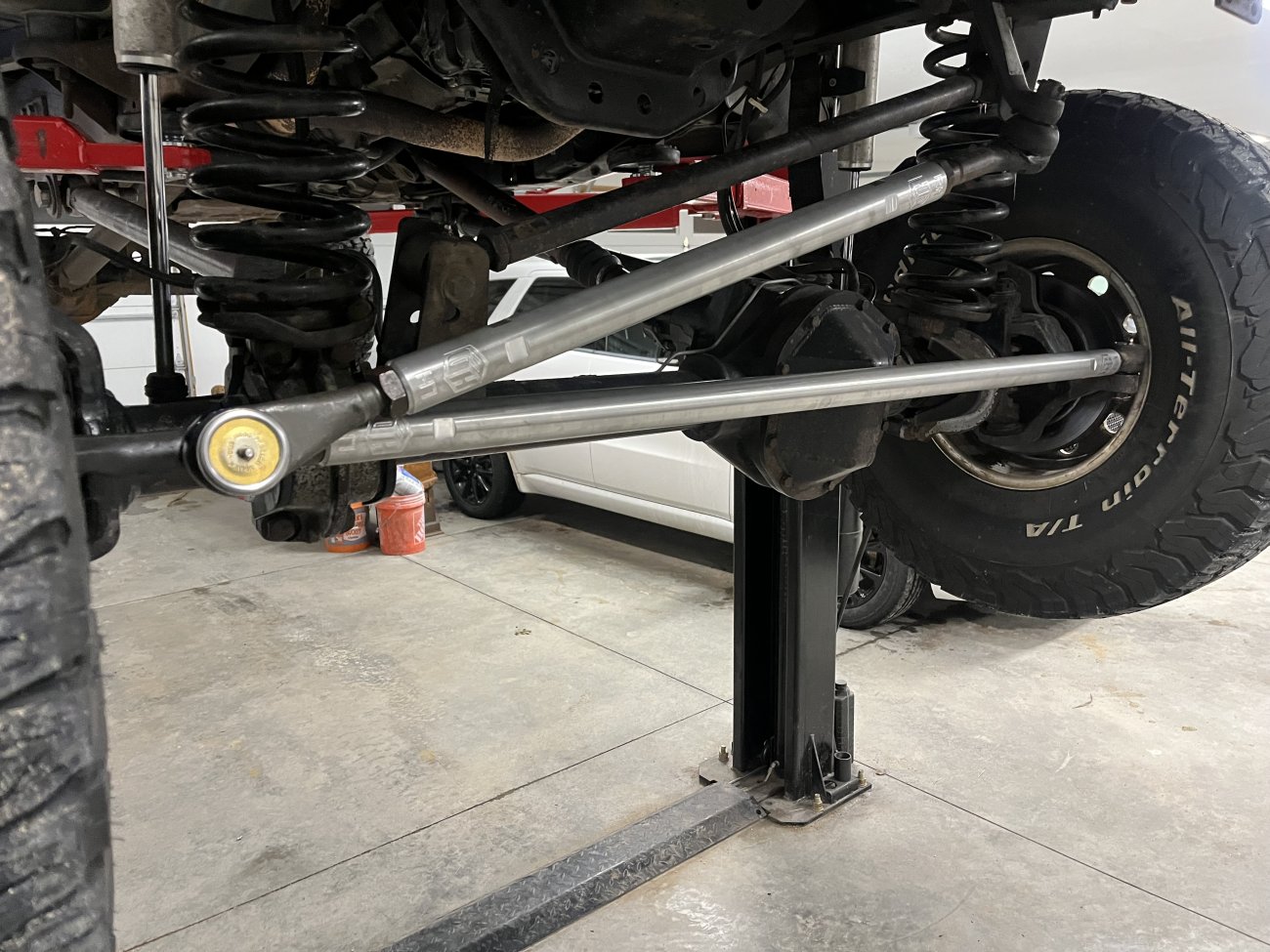

I am unable to find it now, but back when I was doing my steering I found a company that makes billet pitman arms that you heat and bend to suit your application.
I ended up moving my steering box forward about 2", it wasn't too much work. Just can't move it much further than that as the lower radiator hose is right in the way - at least on my 4.0
Here you can see the 3 bolts holding the steering gear to the frame, and about 2" behind them the original holes
Man this is super helpful. Thank you sir. What did you do on the holes for the box? Did you sleeve them? Also for the frame- it seems like it is shaped around the box there- was that an issue? How did you extend the steering shaft?
The factory bolts are sleeved; there's a sheet metal piece inside the frame rail that has 3 sleeves in it. I just reused that, but I did sleeve the bolts on the passenger side by welding in some DOM so that the torque on the bolts doesn't pinch the boxed frame rail. The inside of the frame rail does have a funky curve to it, so I cut it out and welded in a 3/16 steel plate to give the steering box a flat surface to bolt to
Hmm. That sounds like a ton of work. I was thinking about sectioning the frame and moving it forward. But that’s a lot of work too. Maybe I’ll just go back to my old steering. I realized I could use a grade 8 bolt for an inside sleeve for the cut if I chop my original drag link. Also thinking about getting the big skyjacker arm and heating it up and bending it flatter- that would get me some length. I am not sure of the metallurgy of that- if it is wise. I don’t want it coming apart at 95mph.
