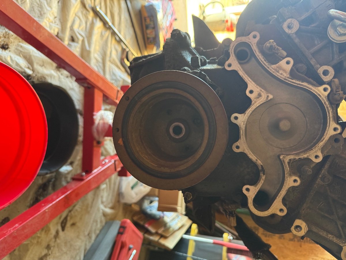

Any ideas on how to remove this dampener? It’s different than the one in the video I’m following. Just use a traditional pulley remover?

Thread the bolt back in part ways and use a steering wheel puller to remove it - the center pin on puller pushes against the bolt head and you'll need two bolts to screw into the holes in the pulley. If this is anything like an OHV 4.0, you can use two of the long thin bolts that hold the AC compressor on instead of buying new ones. Life hack for ya right there.
I’ll have to dig out my steering wheel puller. Not sure what I did with it
Any of those slotted pullers with a center bolt should work fine, steering wheel one is usually just the most common one people have. I imagine you could use a two or three jaw puller and push against the bolt in the same fashion but there is a small risk of the pulley getting bunged up/bent.

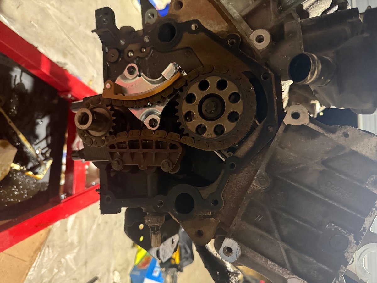

Having trouble putting the drivers side cam gear on. I need the chain to be about a 1/16” longer. Anybody have any tips? I’m going try again tomorrow when it’s warmer
I got the drivers side cam sprocket on. Put the chain on it and rotated it with one hand. Used my other hand to poke the chain down on the jack shaft with a ratchet and it slipped on. Must not have been on right. Now I’m just waiting for my front jack shaft bolt to come in to reassemble.
