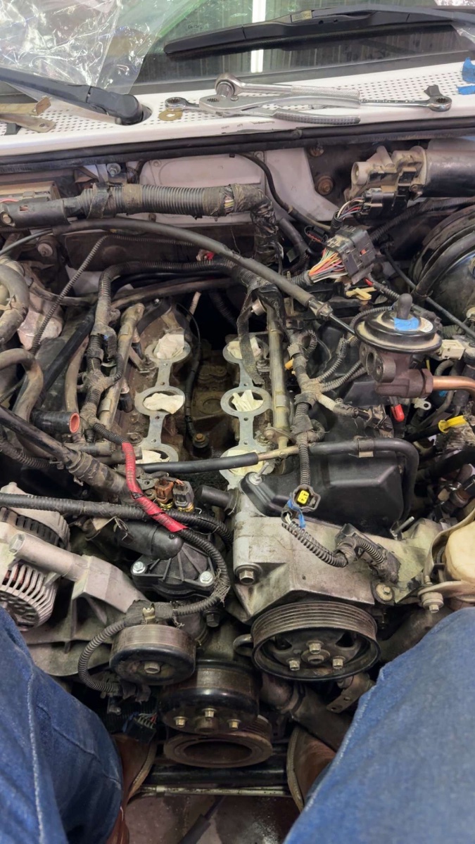

Couldn't get the bellhousing and engine mated together. Going see if I can get a shop to do it for me or if I can sweet talk my cousin into trailering it back home to his shop for me. With finals coming up and my buddy who's cherry picker I'm using moving back east, I'm out of time
Make sure the torque converter is seated all the way into the pump.

Finally got around to this. Towed it from college to my cousins place where him and another cousin helped mate the tranny and engine. Just piecing it all back together now. Hoping to have it going tonight or tomorrow. It’s 90 minutes from where I live right now which makes it inconvenient.
  • Pickup might be done for
Got it running! Ran it for about 20 minutes, no leaks or check engine light. Going hook up the exhaust tomorrow, throw a new battery in, bolt the hood on, and drive her home! Missed the dang thing. Moving to Utah next week and now I don't know what to take. Bought a 1992 Buick Roadmaster Limited back in May that has been my primary ride this summer. Moving to Utah is only for a month or so
