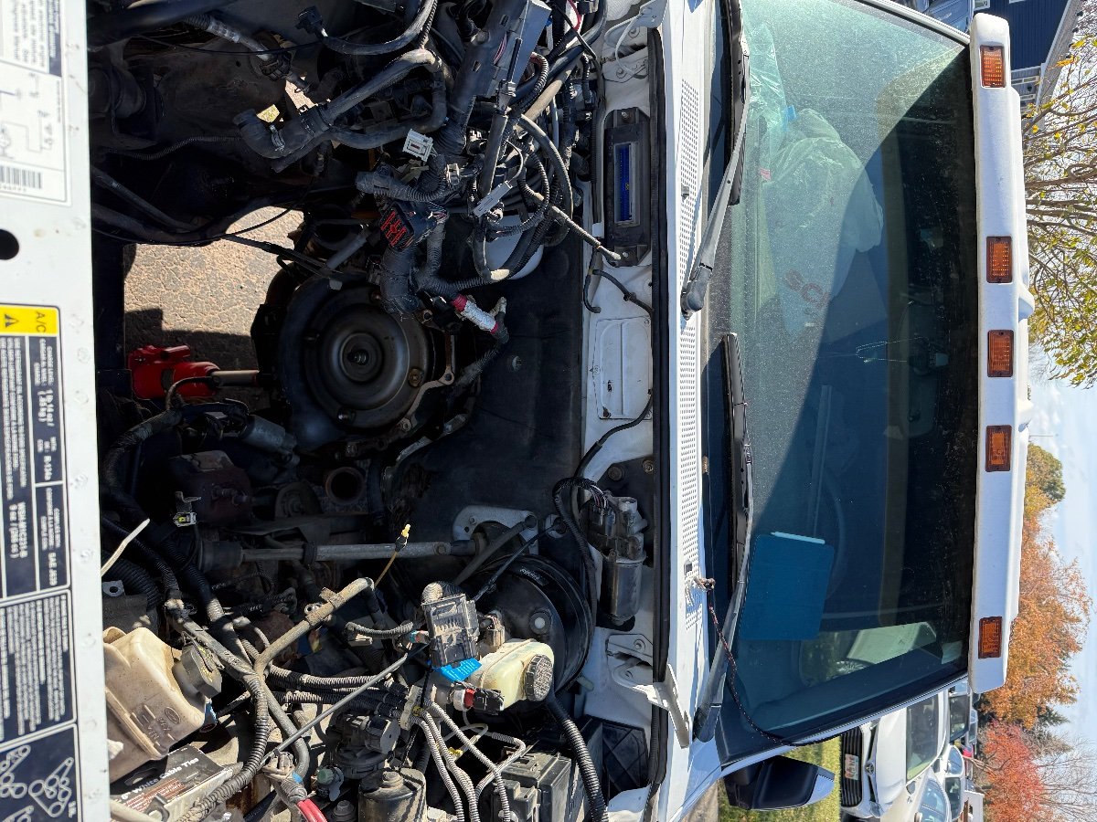

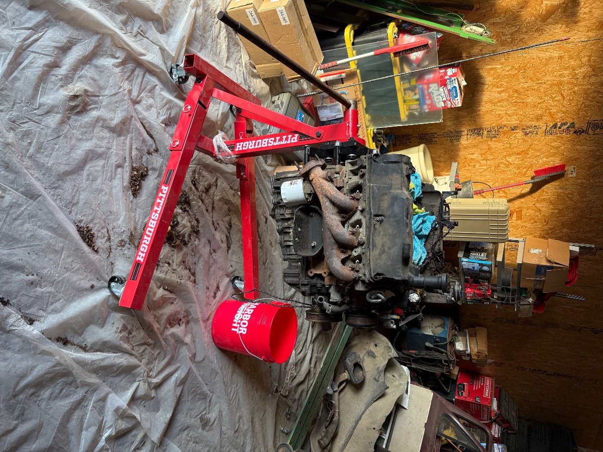

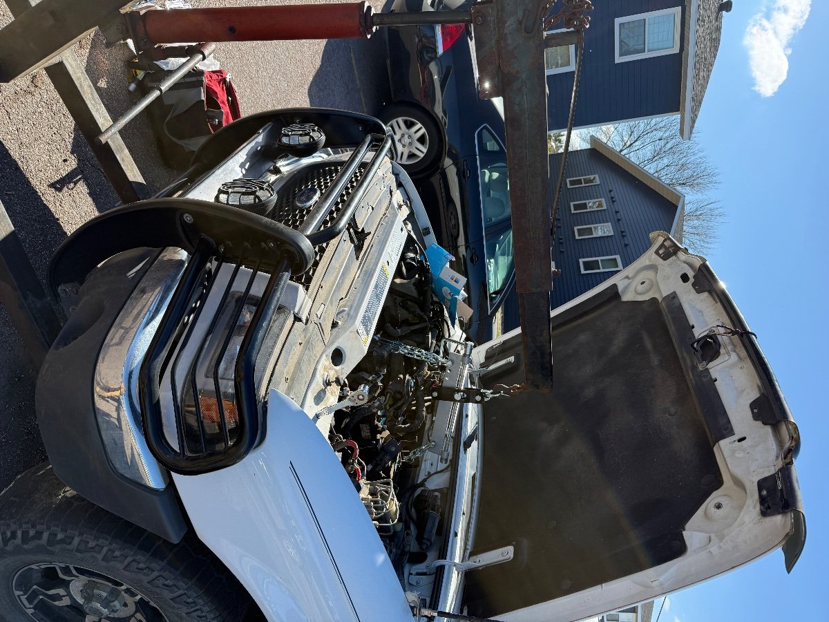

Got the engine removed and on an engine stand. My goal is to drive the ranger home for Thanksgiving break

Awesome! Keep the faith! You got this!
