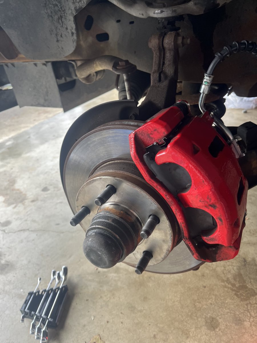

Hello all,
My 1999 ranger xlt 2wd 2wabs has a persistent brake drag that I cannot figure out. Ive replaced the master cylinder, calipers, pads, rotors, drums, shoes, wheel cylinders, flushed and bled the system, and I just replaced the flex hoses at the front and the drag persists. The wheels free up completely with the calipers removed and it’s not the slide bolts because they’re brand new and fully greased. I don’t think it’s a hydraulic issue because if I crack the bleeder fluid doesn’t come shooting out and the wheels don’t free up. Please advise

Brakes get hot enough to sizzle my spit off the rotors after driving. I thought it was the hubs for a while since the heat radiates there as well. Fluid does not shoot out the bleeder when I open it. Can turn the wheels by hand but they stop as soon as I let go. They don’t spin freely.

They’re brand new calipers and I greased the slide pins sufficiently.
I pushed in the pistons on one of the calipers and they went back smoothly

It’s just the rotors that are the heat source but after maybe 3 miles at freeway speeds the heat radiates through the wheel and I can feel it on the hubs

I used brake grease and gave them both a medium coating following tutorials I had seen
