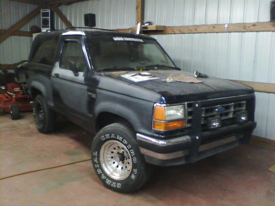

My dad gave me this bronco when I was 15 (wow, 11 years ago!!). I have been in love with it ever since. The past few years I've noticed it really going downhill, lots of rust, the interior is looking BAD (not to mention SMELLING bad). Most of my friends and family were urging me to sell it, or even scrap it. I got tired of the negativity, and set out to fix it up.
Here are some specs to start out with. It's an 89 XLT, 2.9, A4LD, Electric tcase, D28/7.5, front split bench, power windows/locks (don't work), cruise, AC (doesn't work). I'm really more interested in a having a reliable, capable daily driver that I can use around the farm and take on road trips, than I am in having a full-on rock crawler. Reliability and Fuel economy are paramount in this build, with capability and simplicity being very important as well. Overlanding has always been an interest of mine as well, and 4x4Junkie's BII is probably my favorite ever. If you read this Junkie, just know that your ride has really inspired most of my ideas! Here are some of my plans:

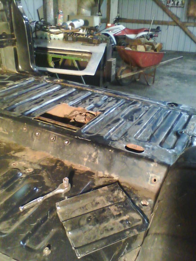

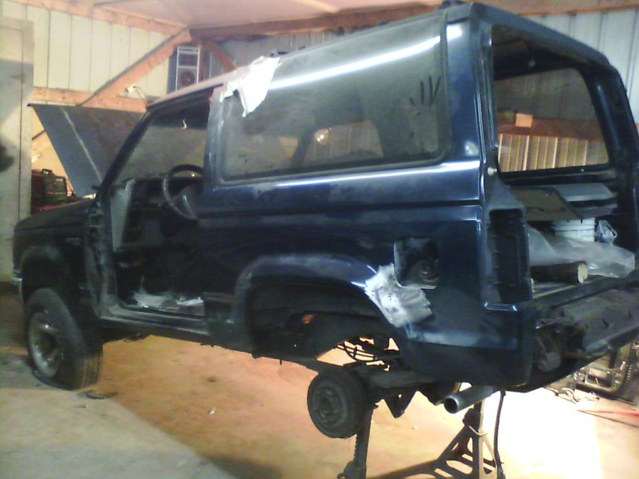

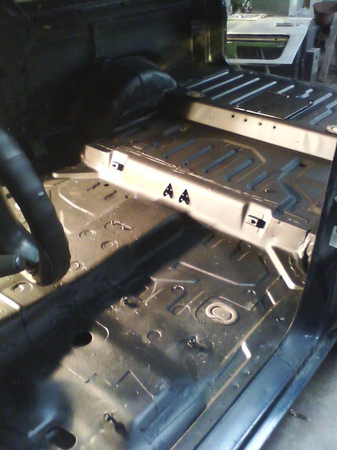

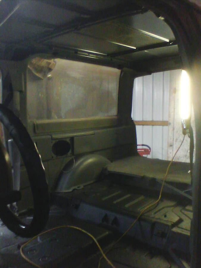

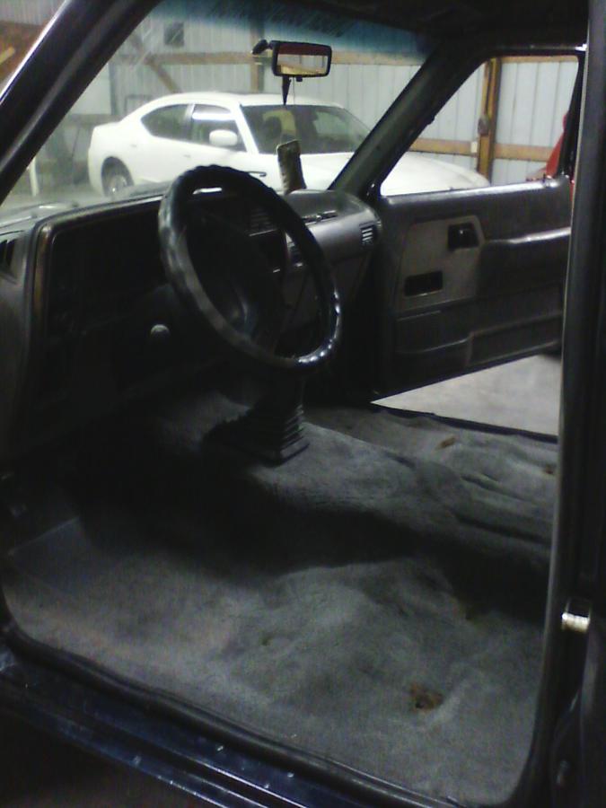

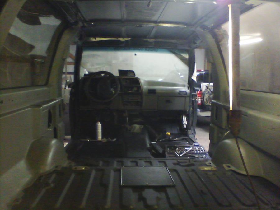

Not much to look at. The first order of business, my front drip rails were in pretty bad shape. Rusted completely through, no wonder my carpet stayed wet all the time!! So, I FULLY stripped the interior, everything except the dash. It took many hours of grinding, and lots of trail and error. I tried welding and brazing, neither worked well. I finally settled on fiberglass (tiger hair, for all you geezers out there
). This wasn't the route I wanted to take, but it finally came out solid. Oh well. You can tell in the pics were I had been working on it. They came out pretty good. Keep in mind, this was a full year ago. I tinkered around with the drip rails, some of the body work, and the floorboards for a while, until last winter things jumped into overdrive. More to come.
