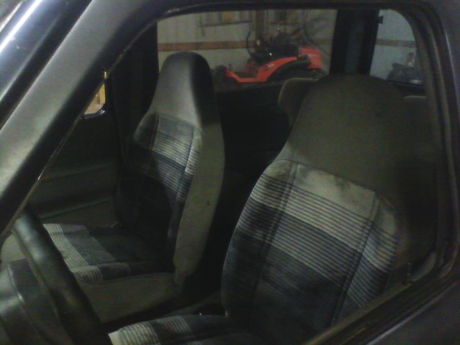

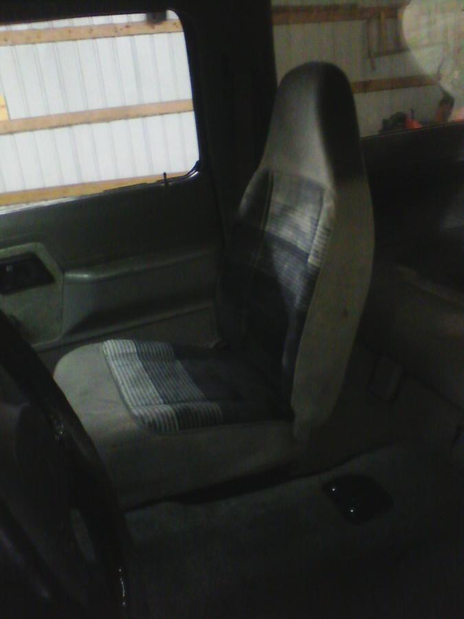

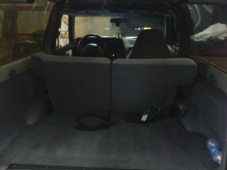

Been busy busy. Got my rear seats in, along with most of my interior trim:

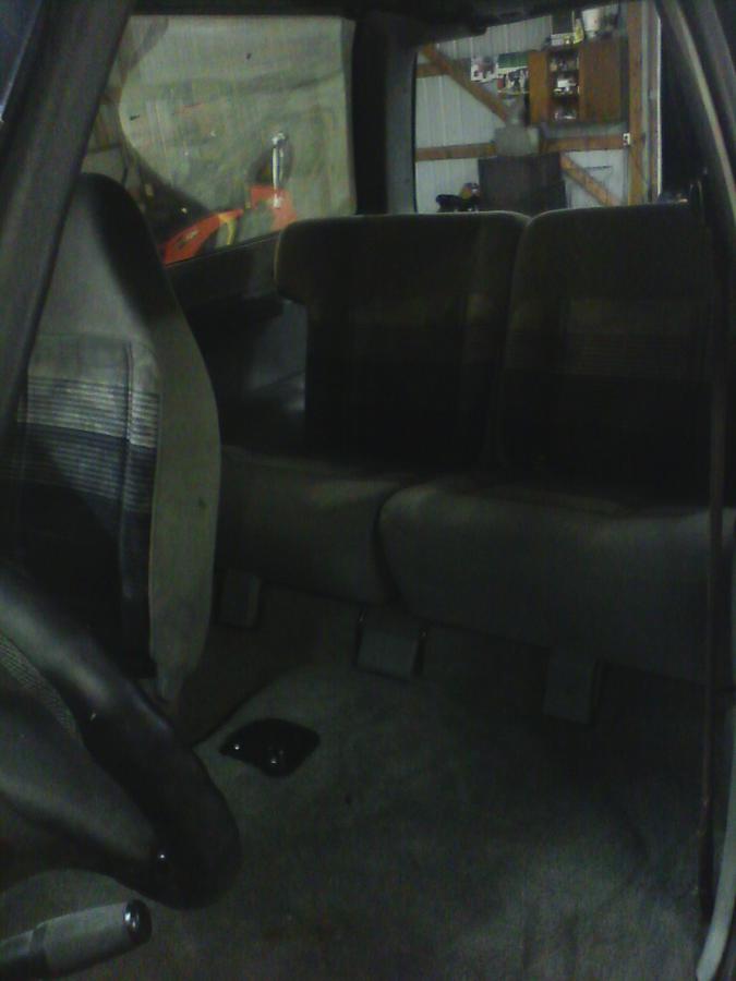

The brackets and rails were all painted, the seats SOAKED in super-clean, scrubbed and hosed. They came out ok, but I was disappointed with all the permanent stains... Anybody have any tricks on getting them out?
Front seats in, they sit nice and look WAY better than my original bench seat. I'm leaving the console out, I feel that it makes the cabin feel much bigger than it actually is, I prefer the open feeling. Besides, the console in my explorer squeaks and rattles enough to drive a man insane.

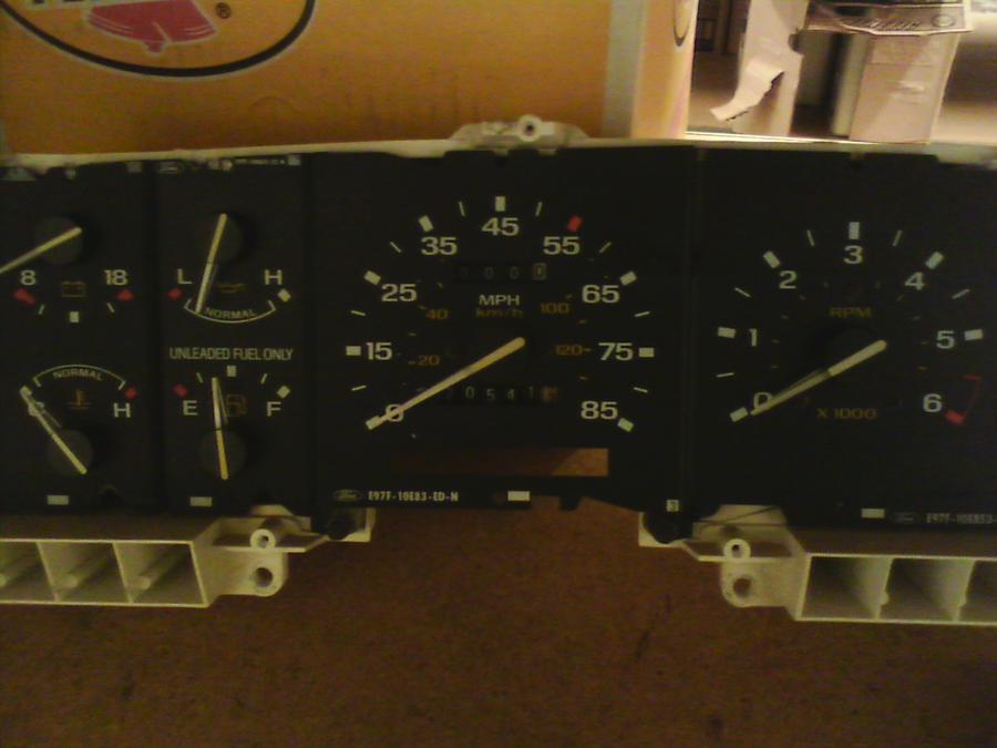

My dash lights have always been dim and spotty, so I pulled out the cluster, detail cleaned it, re-painted the centers of my needles, and put ALL new bulbs in the rear. Then I polished the plastic cover with Turtle Wax ice, it took out the great majority of the haze and scratches. Bolted it back together, hooked up my speedometer (hint, it is MUCH easier to reach if you drop the column!), and it looks great. Before:
After:
Much brighter at night, I'm tickled with the way this came out.

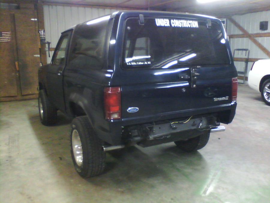

With my taillights still out, I cleaned up and undercoated the area behind them, cleaned up the harnesses, added all new bulbs with dialectric grease, and added a new trailer light harness. All bolted back together:
It's really came a long way. I couldn't stand the wait any longer, so I actually got it out on the road. It has some vacuum issues, the clutch may need bled just a bit more, but it does FANTASTIC. I am very happy with the progress so far.

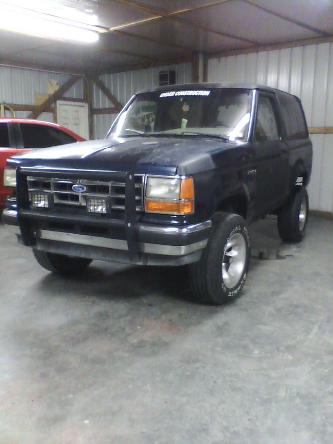

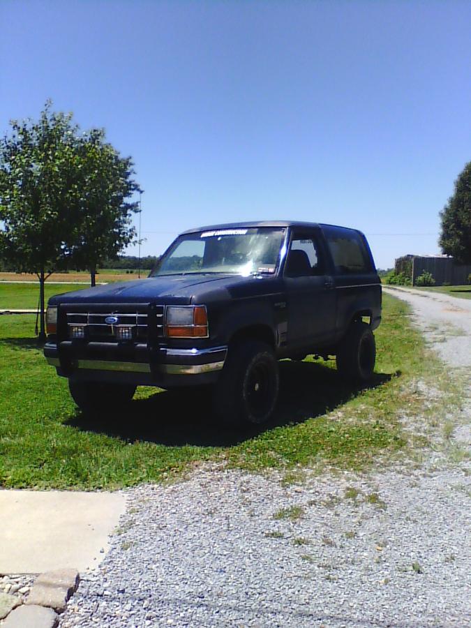

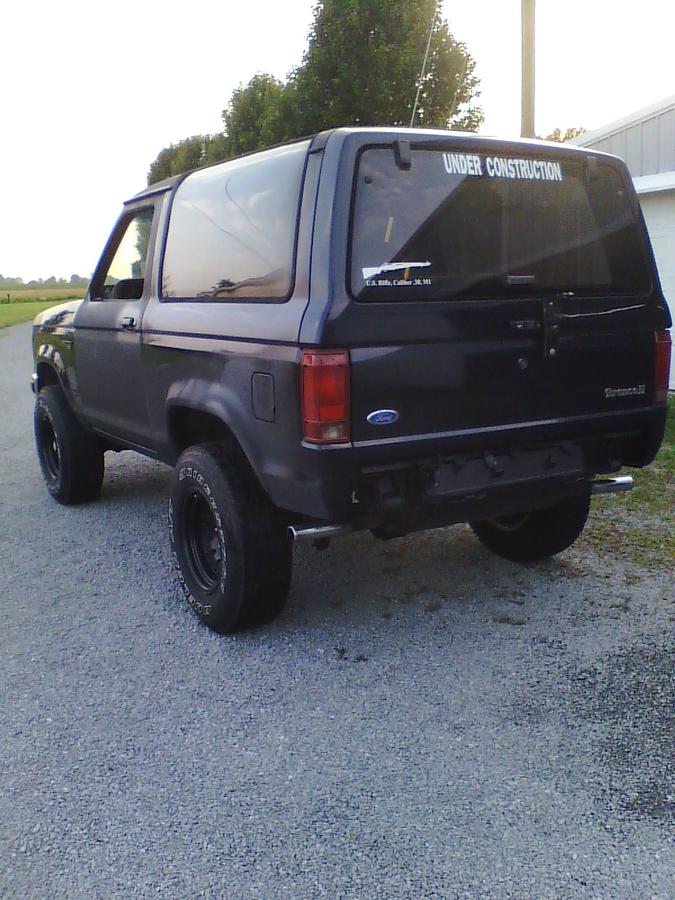

So, this is where I am at today. Please, disregard the little bitty Barbie-doll tires I have on there now, I promise they WILL be changed out in the future. A bit more body work, and it will be ready for paint. My next mechanical chore is to do a FULL brake job, new lines, calipers, everything. Then it is on to the D35 swap, new suspension (3 inch lift or so), and tires. I'm also wanting to service the rear 7.5, flush the oil and add some type of lunchbox locker, maybe a Powertrax? There is still a long road ahead.

Looking really nice. The only cure I know of for permanent stains in seats is seat covers. But I have had some luck with laundry soap with oxi-clean in it and also resolve. But I'm pretty sure you've probably tried those types of things.

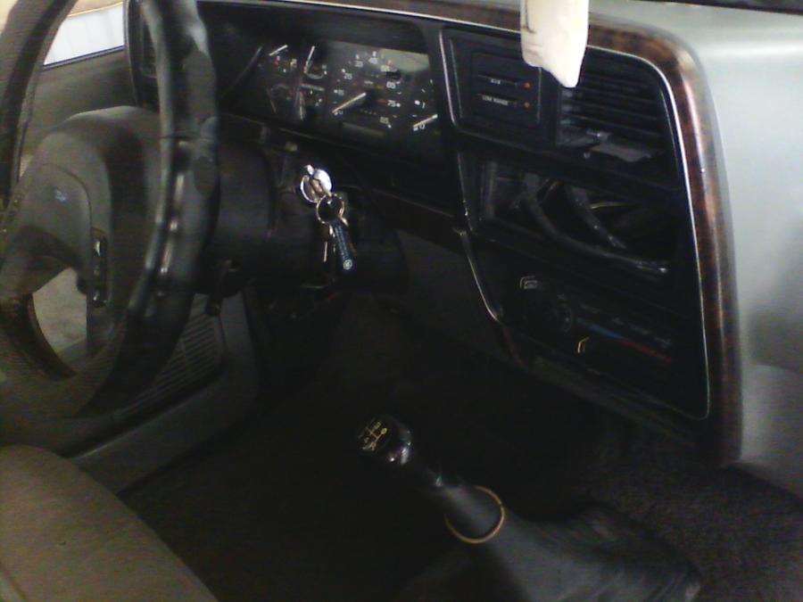

I made some more progress this weekend. I went back to the junkyard and scored a VERY nice dash bezel and ash tray. It is wood grain (what I was trying to get away from), I couldn't find a grey one, but it looks pretty good popped in place. I also got the seat belt slides cleaned up and bolted in. Here is a pic of the dash:

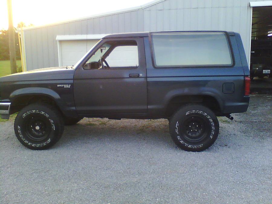

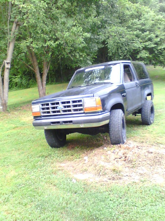

I also robbed the wheels/tires from my old explorer. They are 30x9.50's, I had to lift the front just a bit for it to look right. I used those crappy twist in spacer things in the coils. I know, I know. But it is just temporary until I can afford to build the front.
It drives better with these tires, they are so much smoother and quieter. I think these are about the right size, they are big enough to make the truck feel sporty, and give me enough altitude for some light hunting trails, but they aren't so big that it is a pain to drive. I might not even have to re-gear the axles, it pulls pretty hard on acceleration. When I get my new tires, I think I will be going this size.

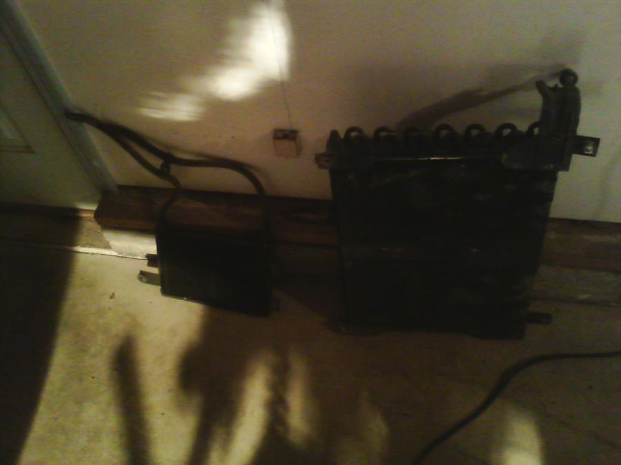

I changed my oil, first time in about 3 years. I also fogged the vacuum system with SeaFoam. I pulled off the grille guard, the lower valence, and pulled out the A/C Condenser and Auto Trans cooler. Those are the last remnants of both systems, every little bit of weight and added crap I can delete from this rig, the better:
I can't believe how much dust/hay/mud was caked into the front of the radiator. Its a thousand wonders this thing never overheated, definitely a good move to remove the condenser. I'm going to trim the bottom of the grille guard, so it doesn't stick down below the bumper (I'm leaving the plastic valence off for ground clearance and tow-hook access), and I'm going to clean it and re-paint it.

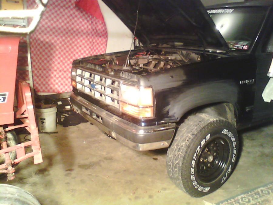

I had to replace the calipers sooner than I expected, the driver's side was sticking. You can see in the picture how hot the rotor got. It's amazing that it didn't warp. Good thing is, D28 and D35 both use the same caliper, so they will work on my D35 swap. I need pads and rotors too, but they will have to wait for the D35. Please disregard the wussy auto hubs, their days are numbered.

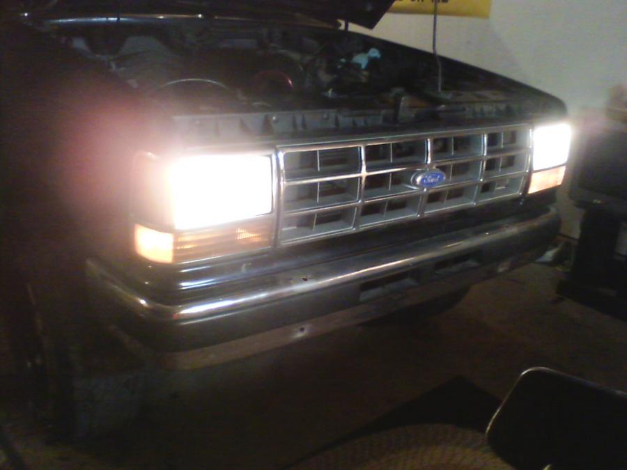

Also fixed the Hi Beams. BOTH bulbs were shot, contrary to my expectations. I REALLY wanted to do the 9007 bulb conversion, but I need lights NOW, so I just put in stock 9004's. A few bucks and 10 minutes fixed that problem. No argument from me.

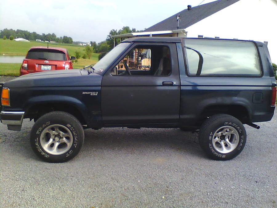

I drove it to work today, her first time in town in many moons. Good news is the clutch is getting better all the time, I guess actually driving it is help breaking in the disc and working out some of the air. I love this thing, I've only had it on small hills around the farm, but it climbs like a goat. I can't wait to get my rear locker in it. Throwing around the idea of a Jeep Limited Slip in the front D35. Poser shot!!
