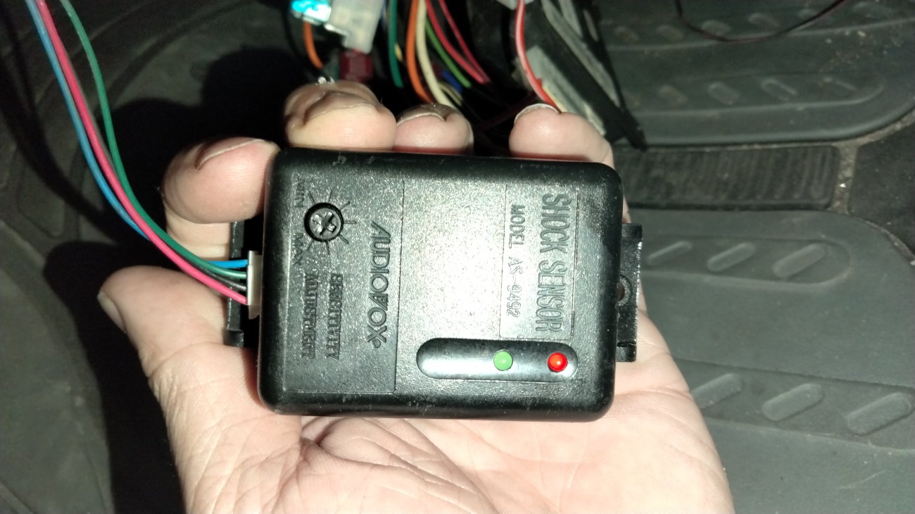

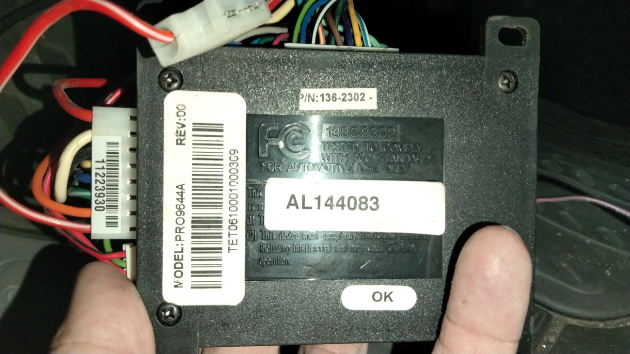

I pull the rest of the aftermarket system down and find a box marked "Audiovox" that is the source of the clicking... pull a fuse (add a fuse inline obviously not factory) and the clicking goes away and the truck starts now.

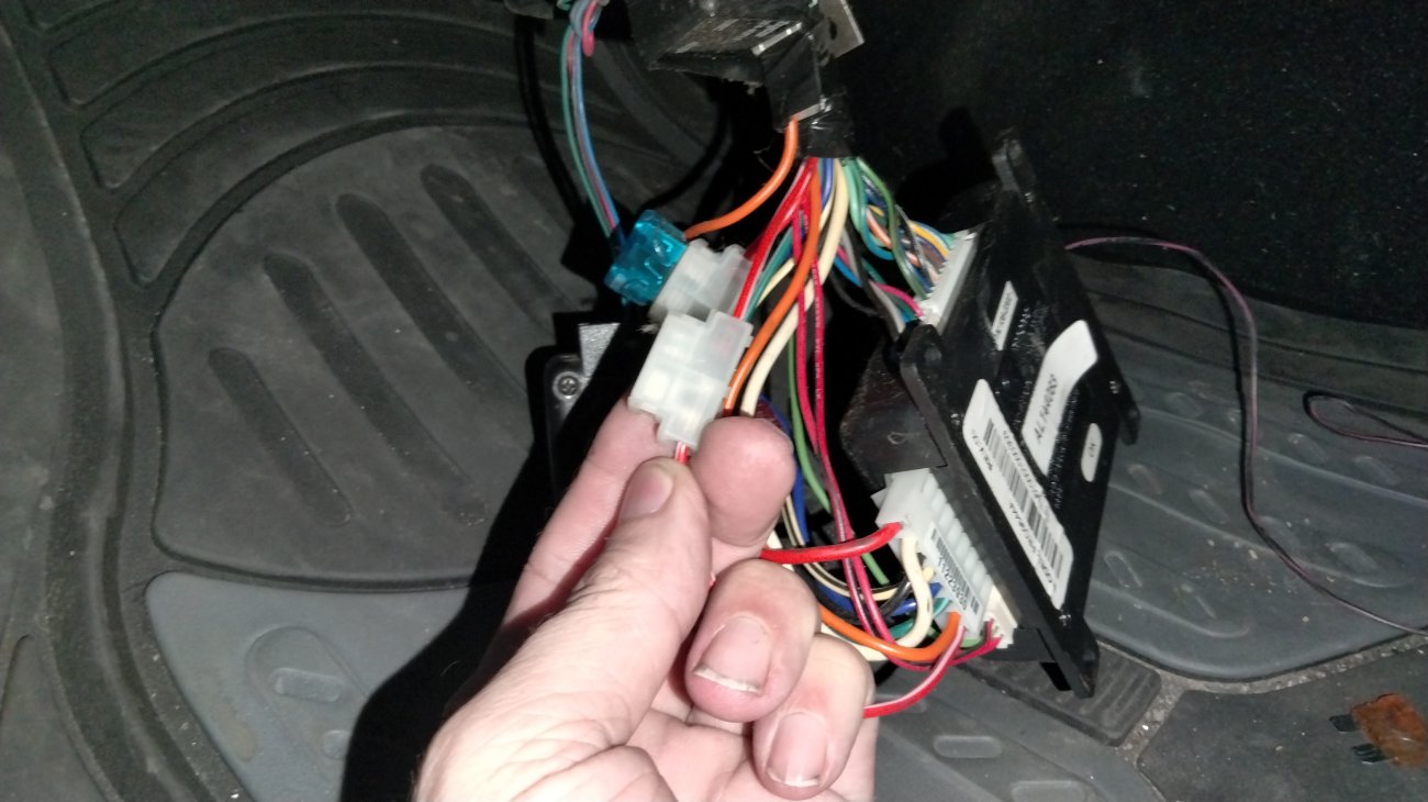

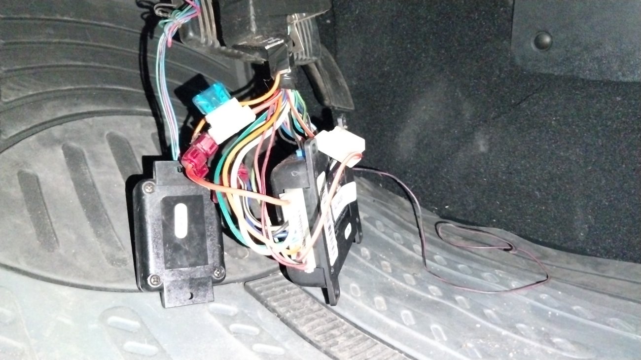

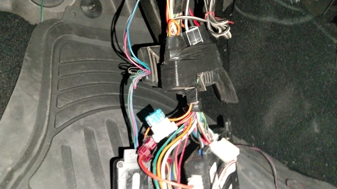

Now before I take a pair of wire cutters and just butcher the thing out, can anyone tell me what all of this might be factory wiring that I shouldn't touch... it is a ball of crap with what looks like add a relays, and even multiple 'add a' taps onto add on wires.
I searched the FCC info on the back of the fob, and all I can find is "how to program" guides, nothing about install.... and I generally think my google-fu is unmatched so I think that is a dry well trying to hunt the install sheet. If someone has installed this system or can beat my google-fu I gratefully appreciate.

Most of that ball of confusion you'll find, is interconnected to itself.
First let's cover the alarm wires which will be connected to OEM Ford wires. I'm going to use the most typical aftermarket wire colors here.
1) A/M alarm Red wire- constant power; we used to recommend splicing into the main constant power at the ignition switch (should be Yellow).
2) A/M alarm Yellow wire- ignition (or "switched") power; again we used to recommend splicing into the main constant power at the ignition switch (could be any of several colors, Red/Lt Green being the most common [true ignition]).
3) A/M alarm Brown White* wire- flashing light output; we used to recommend splicing into the parking light circuit at the light switch (should be Brown).
4) A/M alarm door trigger- Violet for positive, Green for negative. Older Fords are positive-switch dome lights, so A/M alarm Violet to a Black/Lt Blue, usually in the kick panel, but this could be at the light switch or at a courtesy ("dome") light.

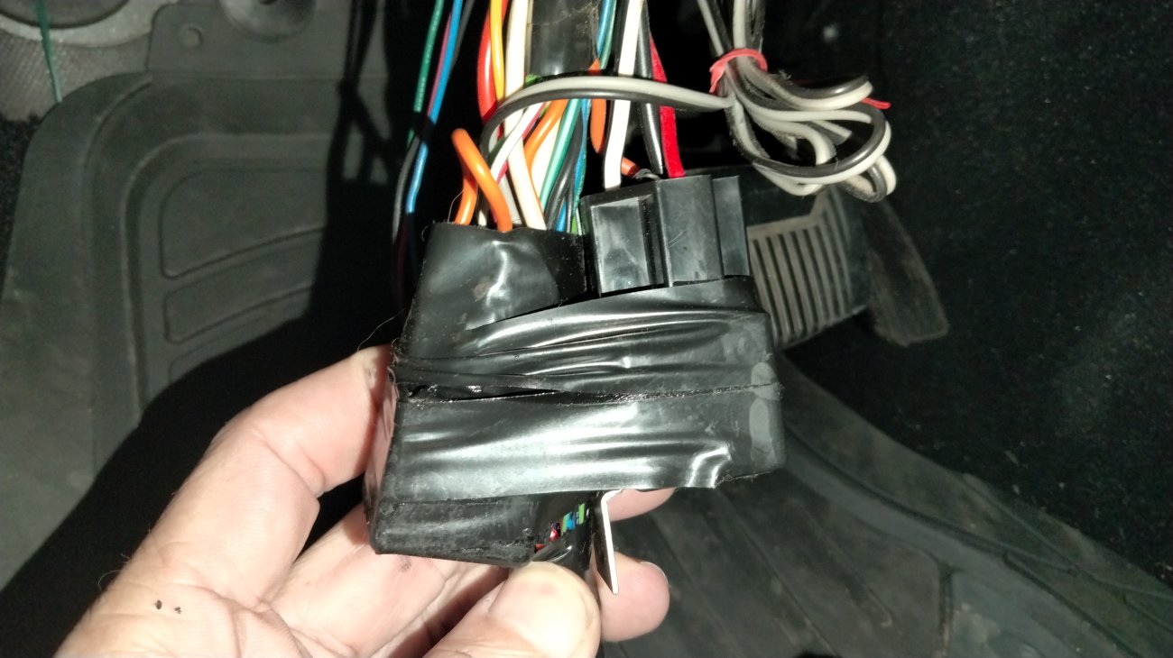

Second, let's address the starter interrupt. It LOOKS like you actually have TWO external starter interrupt relays in that mess, taped to the alarm harness. These are the relay sockets with the white and red wires. At least one, or likely both of these sockets are interrupting cut factory wires, one being the starter circuit- old Ford Pink or Pink Lt Blue, with A/M socket Red being upstream, A/M socket White downstream. I don't know why two relay sockets were used; but, you'll have to trace the aftermarket Red and White wires to the connection points, and then restore (reconnect) any cut factory wire.
Third, there will be at least one A/M alarm Black ground wire, which should be attached to chassis ground.
I would work in that order.
There will be a A/M Brown wire, which typically would go to an electronic siren under the hood, but later A/M alarms (especially of the vintage you're working on), may have a output which can be connected to the OEM horn. You'll just need to look at that one, and it may be one final wire that connects to an OEM wire.
The rest of that crap should be interconnected to itself; sensor modules, the status LED, and the valet switch.
The FCC website, if you drill it real good, should have had a schematic and manual on file. Otherwise, I can probably walk you through everything, and as a disclaimer, I'm working from memory on the stuff I used to do for a living 30 to 40 years ago. Fun fact- most all of the aftermarket alarms from back in the day were basically made in the same factory.
