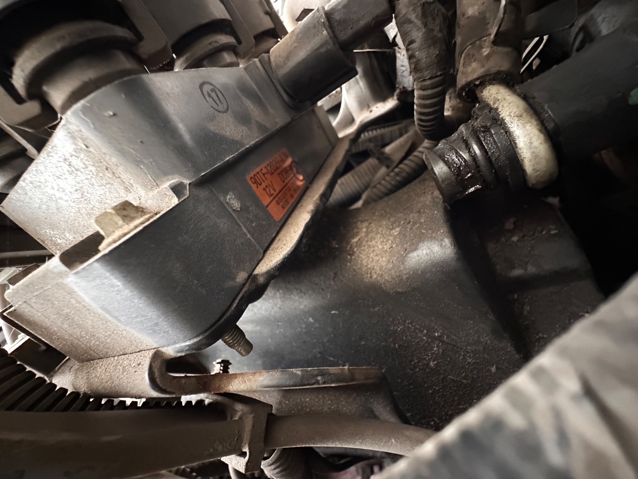

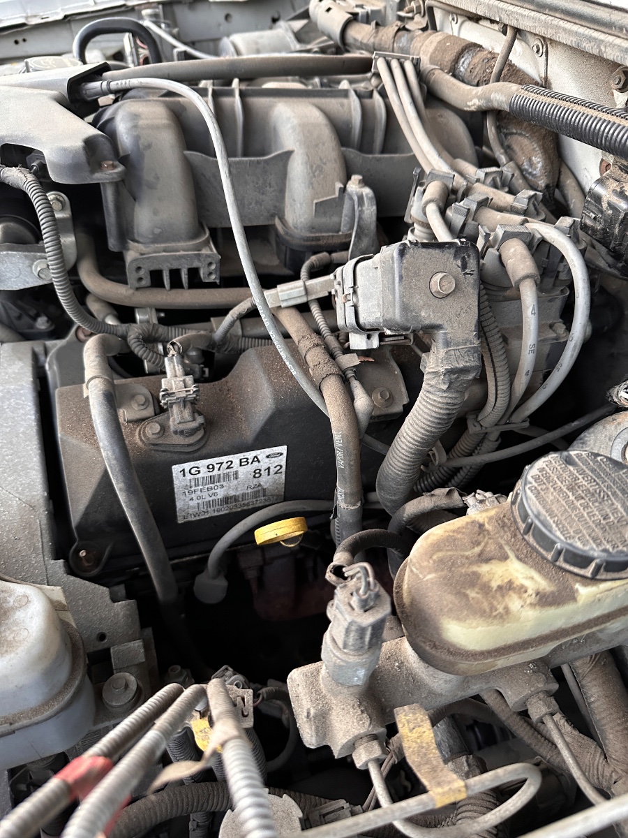

Ok, I didn't get the best photos, because it's a pretty tight spot. The hose, the valve itself all seem fairly in tact, from what I can tell. It has the locking mechanism in tact, albeit dirty. What's not pictured is the intake manifold, where the part it locks into is absent. So I suppose I'm figuring out the best way to go about this. Find this part, which I don't really know the name of, or replace it with some other fitting. Or a third option I don't even know of.

Hey if that works, I'm into it. I think I actually bought that exact rubber elbow, I'm just not totally sure how that works. Do I just remove this adapter and jam it into one side of the elbow, and the other into the manifold?
That adapter is a twist lock connector. You should be able to just shove it back in its home and turn and lock it back into place
Ok so after some looking, it looks like what I was looking for was the PCV Valve grommet. Once I get that installed, I should be able to jam this baby back in place and, god willing, clear the check engine light. Fingers crossed. Only one I was able to dig up that fits was this. Surprisingly, the other auto parts stores didn't seem to have anything that fit my truck.
If you measure the valve cover hole and the elbow, just start asking them for any grommet they find in stock. Might get lucky and find one that is the same
It's not a case of jamming or making due with random parts.
One point to know is that breaking the plastic bayonet PCV valve socket on the firewall side of the left valve cover is a bad thing to do.
Pretty sure a short length of 5/8" hose conects the hard plastic L at the intake manifold.
