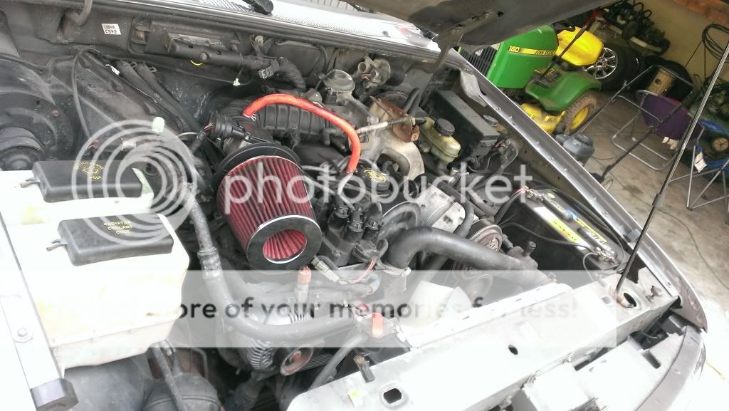

It has the distributor, so I can run the 4bbl carb! The motor IN my truck right now has a few "mods", mostly free shit that everybody does. IE: Homemade catback w/ no cat, intake, dual ignition/dist. mod, B2 rear sway bar.... Blah blah blah! You know the story on the 8 plug heads!
Now all that said... I would like this baby to look as stock as possible, other than the drop/suspension components, the diamond racing steelies, etc. I want the ACTUAL body to remain dented up, bumper hangin', interior in OK condition, though I WILL be putting in 2 bucket seats - 100%! So in other words its going to have that kind of "rat rod" feel...

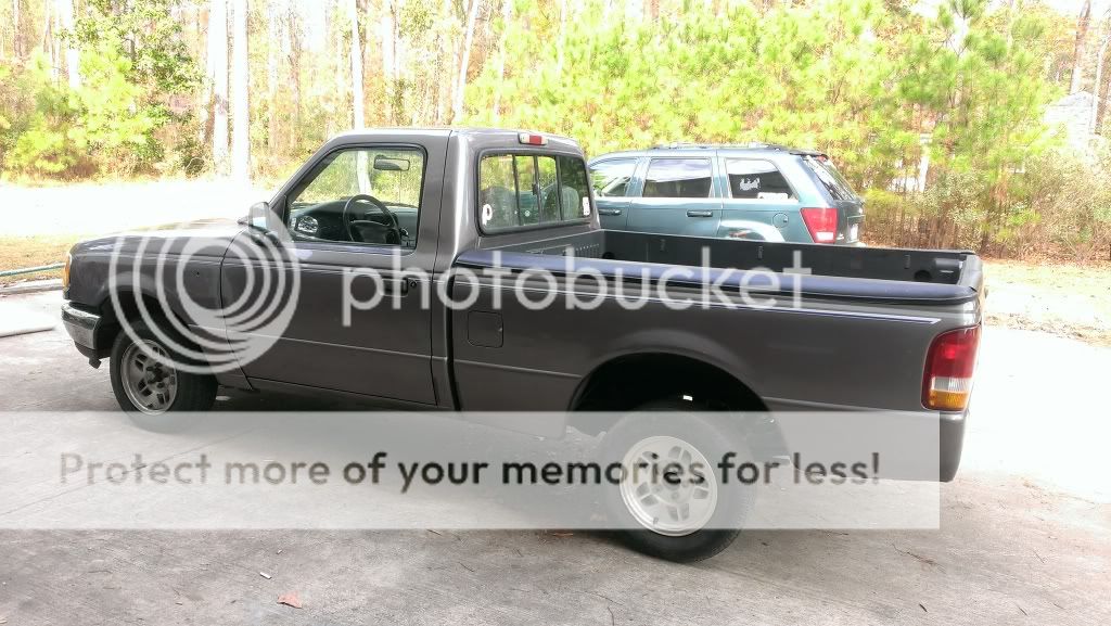

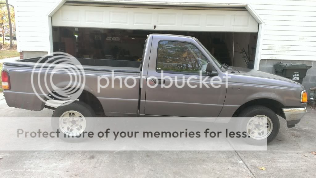

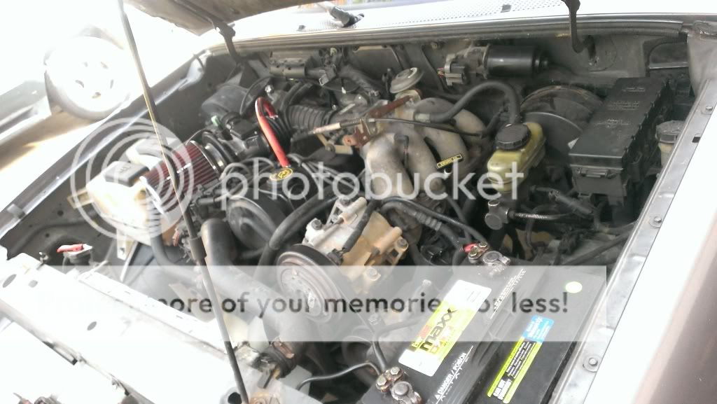

I'll let y'all see some pics of the said truck, that I'll be working on... Then I'll post some more updates and such when I have more time later! I just wanted to get this thing ("build thread") started! LET'S DO IT! By the way "PCKNPLL" will be her license plates! :headbang:

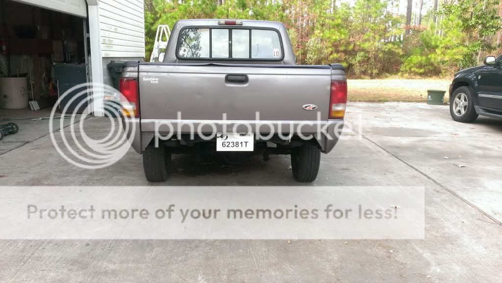

Her she is, riding high, STOCK as can be right now, other than the before mentioned mods and some weight reduction! lol
NOW, the ENTIRE point of this build is to have a 100% street legal , ANGRY 2.3l Ranger that can burn the little Civic next to me at the light, but still be my RELIABLE, easy to tune (4BBL!!!), DD to get to and from work and such... BUT, I'll ALSO be racing it at local tracks against other street cars/trucks... So SHE MUST handle!

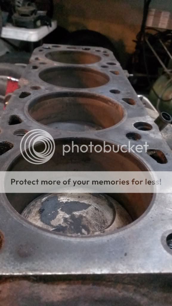

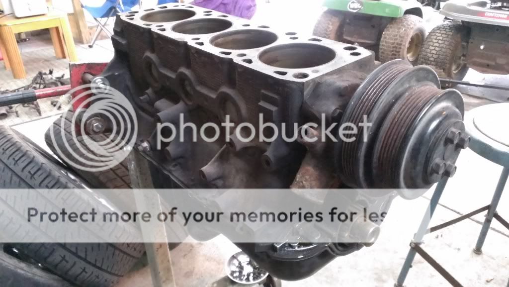

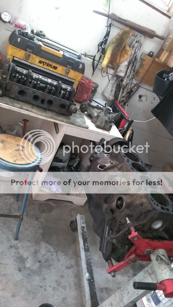

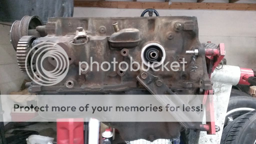

And I'll leave y'all with this, the new motor and how it was brought home and what it looks like two days later!
Here's my giddy ass, when I was cruisin home with the longblock!
Here's when she first landed in my garage:
What she looks like NOW:
She's PATIENTLY WAITING on me to "do my thing to her" and have 'er rebuilt from TOP TO BOTTOM! !

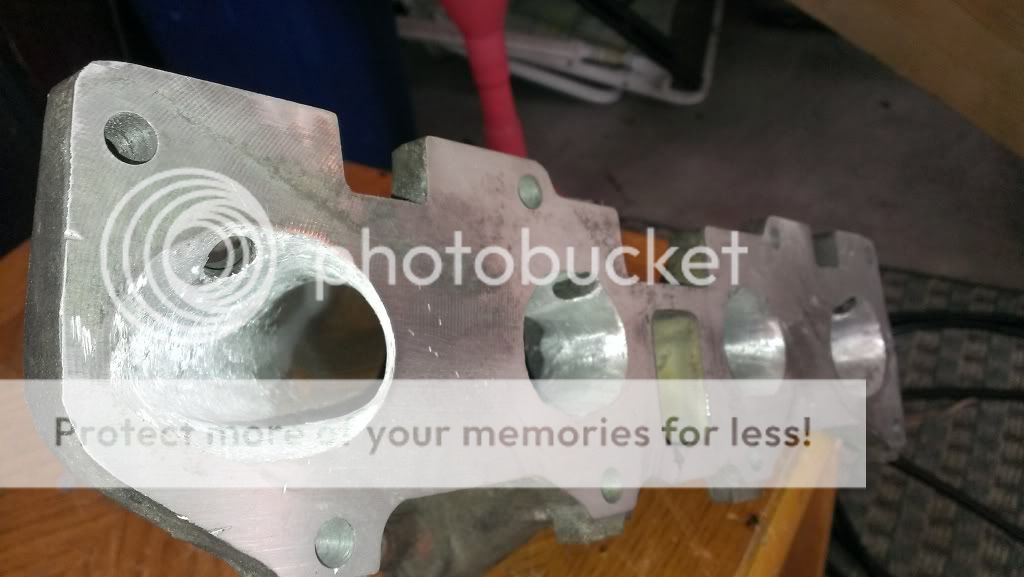

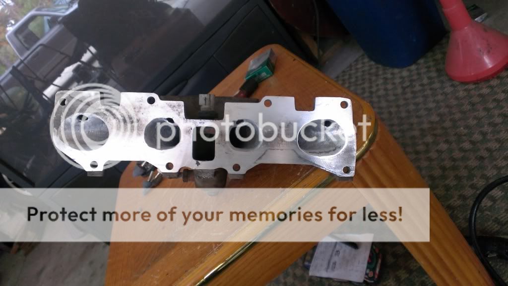

Ported stock intake manifold

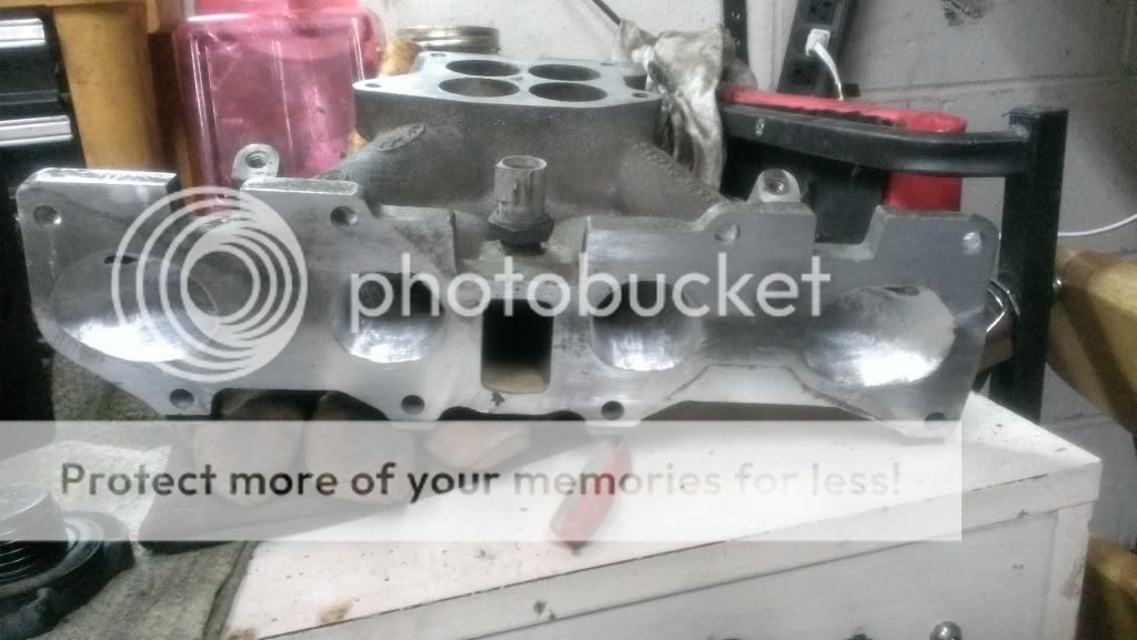

I opened my stock intake manifold a bit for the new motor... Just gasket matched it (BOY there was a LOT to lose!)
I just figured this would help, there's NO WAY it could flow WORSE! Haha... Especially with the head being built and P&P'd! I'll only be using this, paired with the adapter, until I have the money to grab the Esslinger 4bbl Intake Manifold. I threw it on the Mill after hand porting (no polishing) to make sure it was going to sit flat on the head, but took off VERY little! Just to get out a couple lil nicks (Really didn't even NEED to be done, but was!)...
I'm going to HAVE to break out the tig and fill those injector holes! Probably should have done it first, but wasn't thinking! :dunno: :D GUESS I could always use some High Heat JB Weld (Aka... "MAGIC PUTTY"!!!) That stuff will do ANYTHING! I want to have it sandblasted first though. I think I'll just drill/tap the holes and throw some bolts in there, make it look real clean!
I was able to open it up quite a bit (and that's STILL a little smaller than the gasket!!!!)
This next pic was just laid on the cam for the picture! Trust me when I say she's covered and safe now! Haha...
I was able to smooth out around the injector ports A LOT, where that "hump" is in the runner(s)... WITHOUT getting it dangerously "thin"! . Theres A LOT of room to take out some substance!

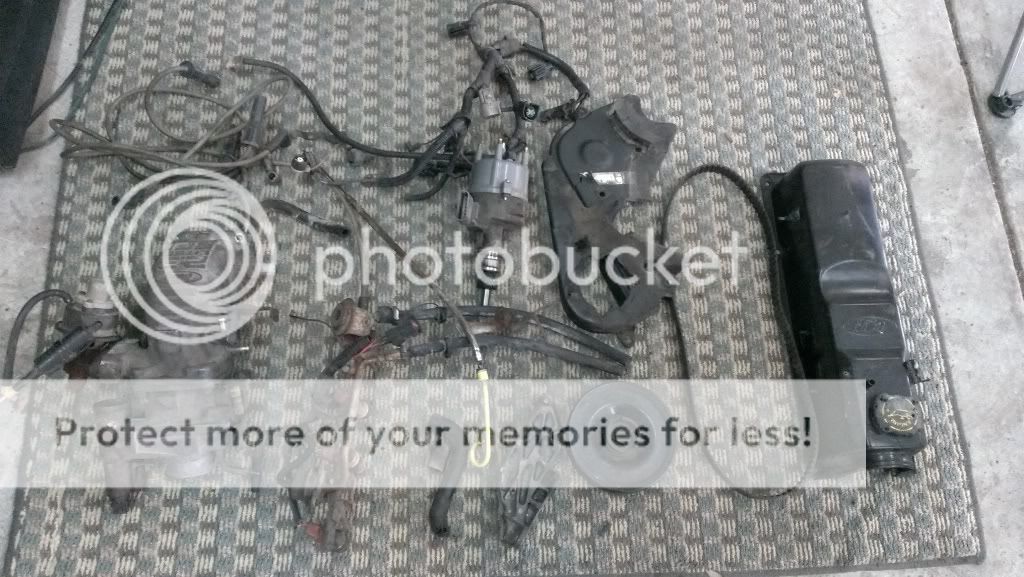

Couple more flicks as to what's been done! Just randomness, but I'll try to explain as I post!

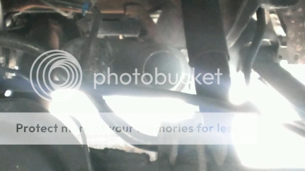

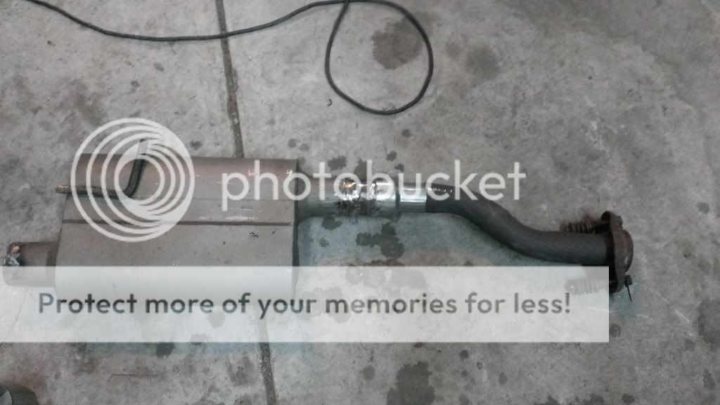

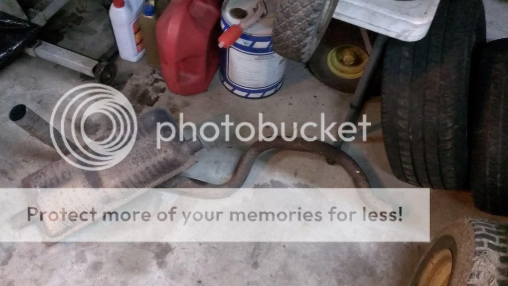

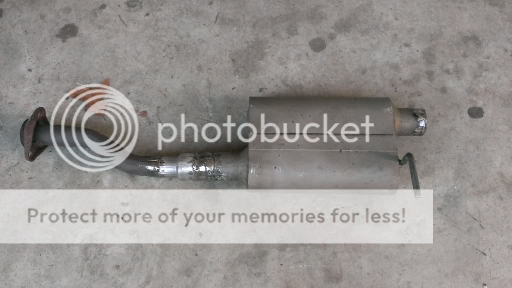

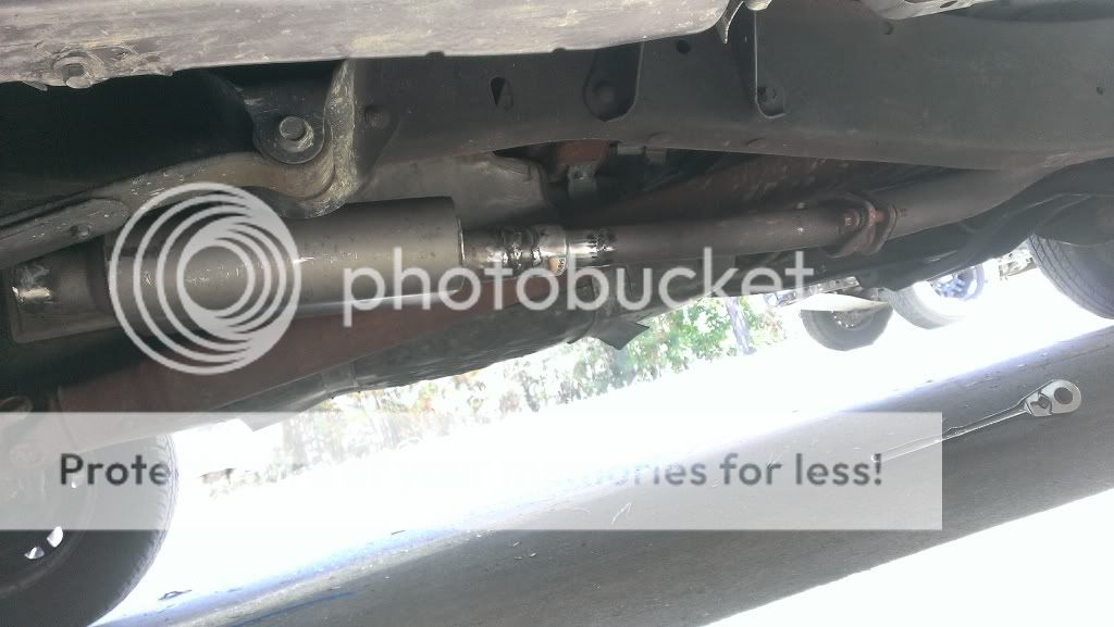

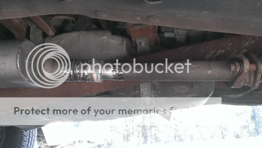

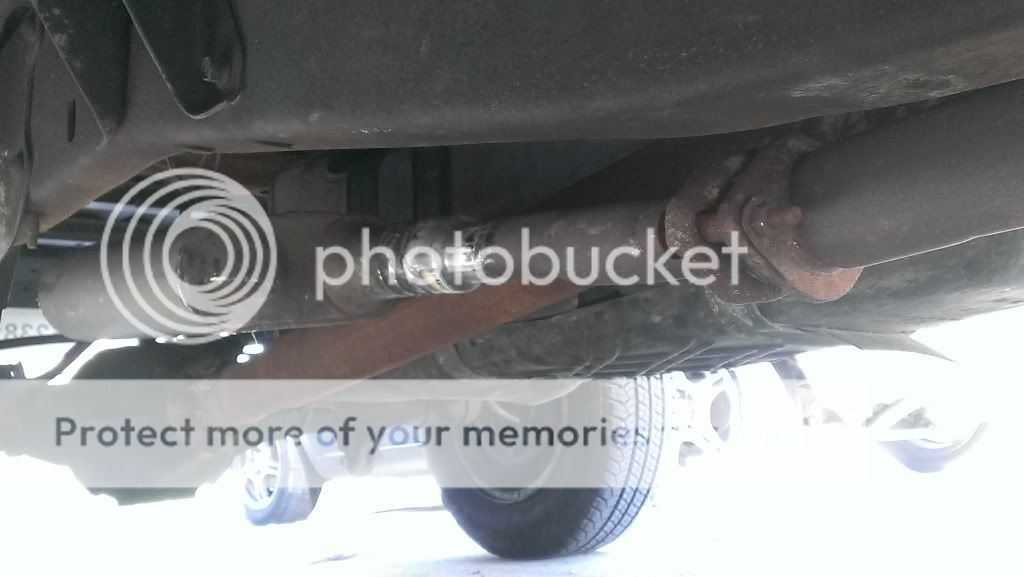

Here's what came off the truck, 2" piping... I had a Thrush 2.5" Turbo Style muffler laying around, so I decided to get some stuff and reduce it to fit!
Guess what was ON there?! ONLY the 2" piping, no cat, dropping back to JUST a resonator, in the mufflers position?! No wonder it sounded like ISH!

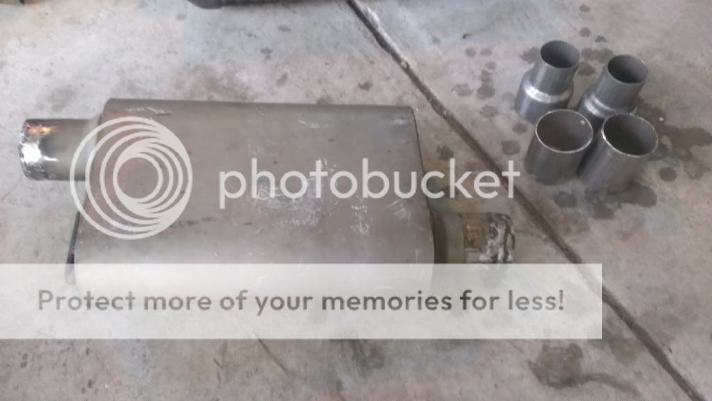

So I decided to make my own (no)CATBACK! Ha!
Gather supplies and muffler...
REALLY? REEEAAALLLY???
Finish dry fitting ON TRUCK AND THEN WELD IT UP - learn from MY mistake!
Like I said, dry fit your hanger MOST importantly, I was an idiot and didn't! (Fixed NOW, but that would've saved .me a lot of headaches AND money!)
All in all, I got it to work! Just need to find me a dumped tip OR I MAY run it straight out the back, not bent though - like a car. Then maybe do a cutout on my rollpan? Who knows...

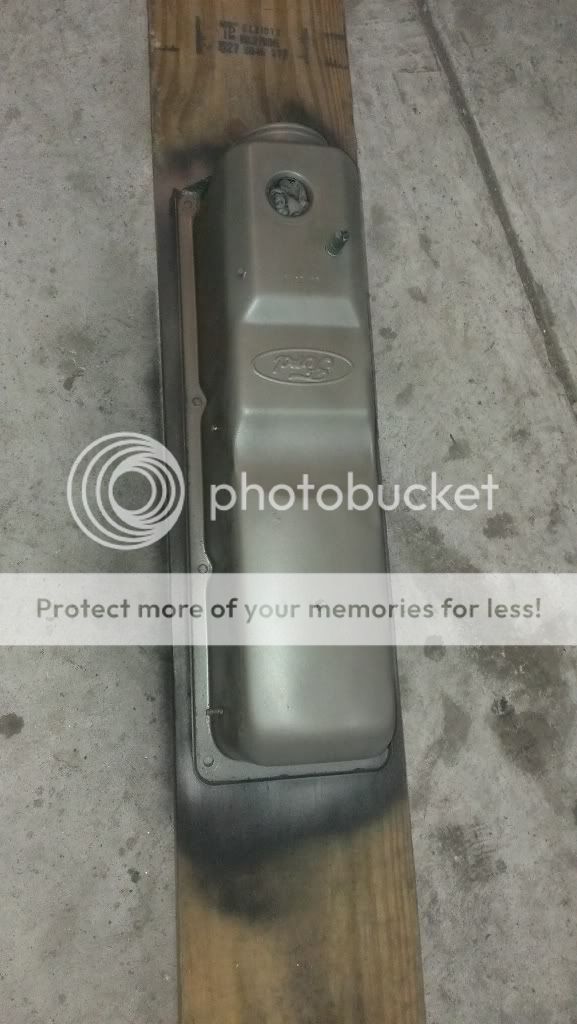

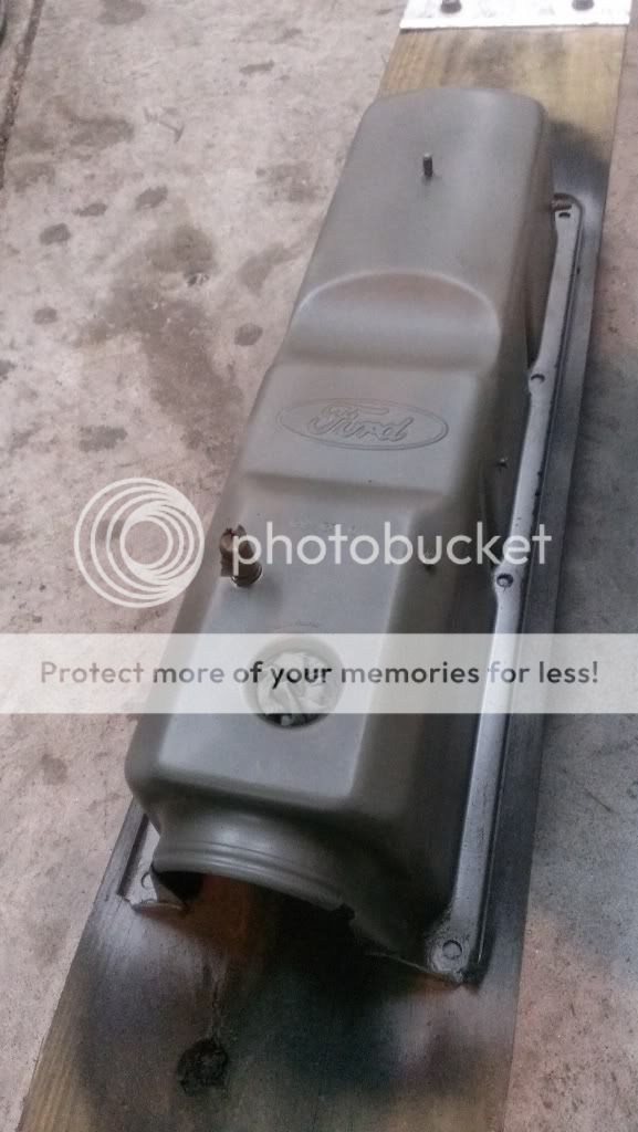

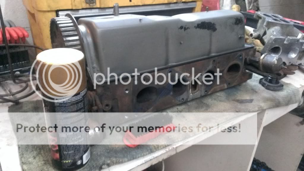

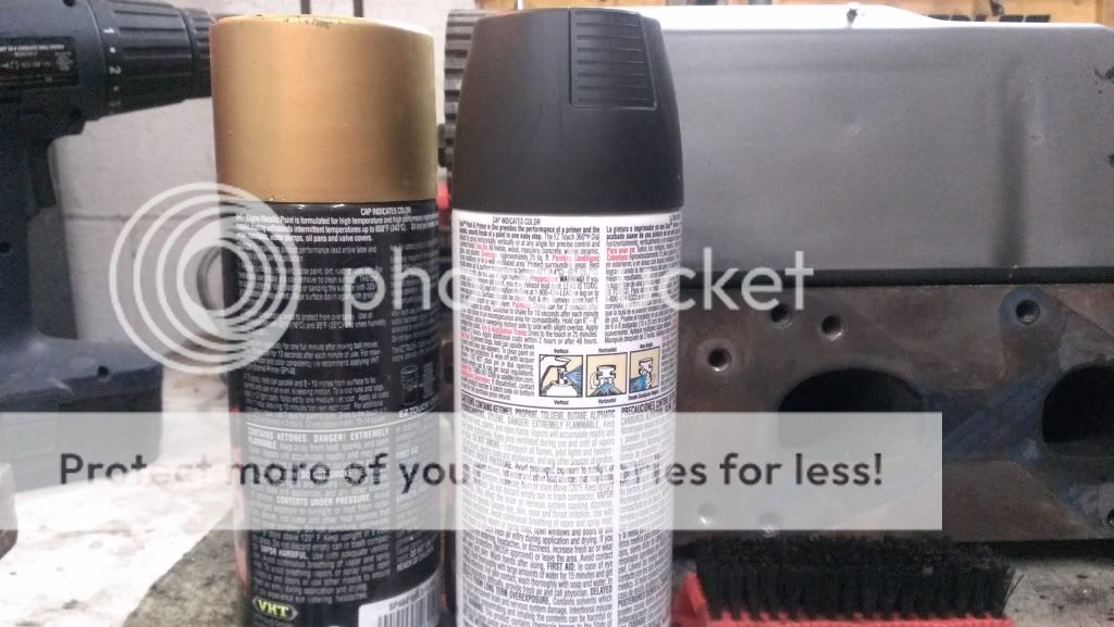

I painted my valve cover last night w/ high temp black primer and then some "Gunmetal" grey! I think it'll look good, but it flaked a little due to me trying to BLAST it before I went to sleep! Lol... I'll sand and repaint later!
Here's where it flaked a lil...
Here's a gold that I'm going to incorporate... Suggestions?
Here's the colors I plan to use all over, but the headand block will be blasted beforehand! AGAIN, SUGGESTIONS? They will be powdercoated these colors btw!
Let me know what y'all think! Those colors with red accents (including the FORD on the VC being painted blood red! Spark plug wires, dizzy, etc....)

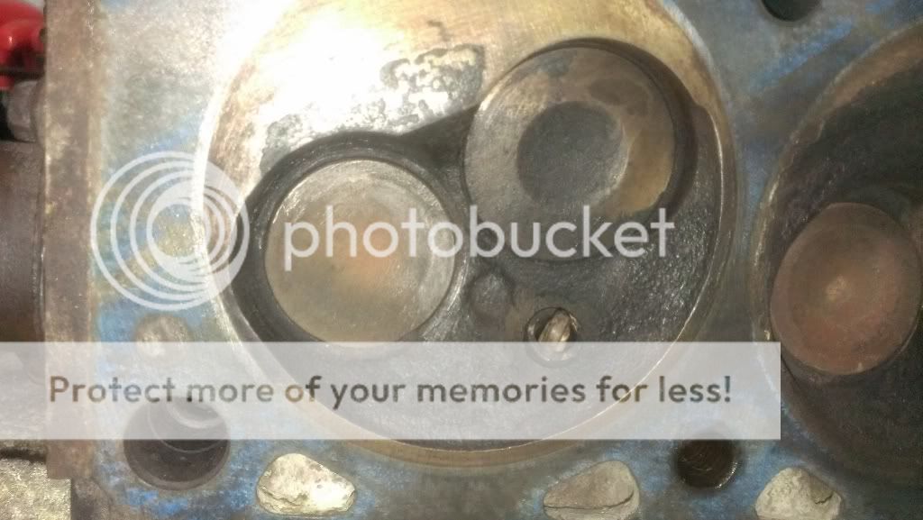

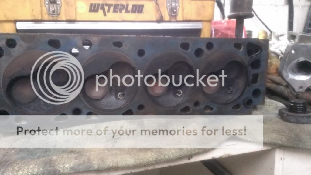

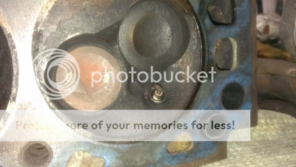

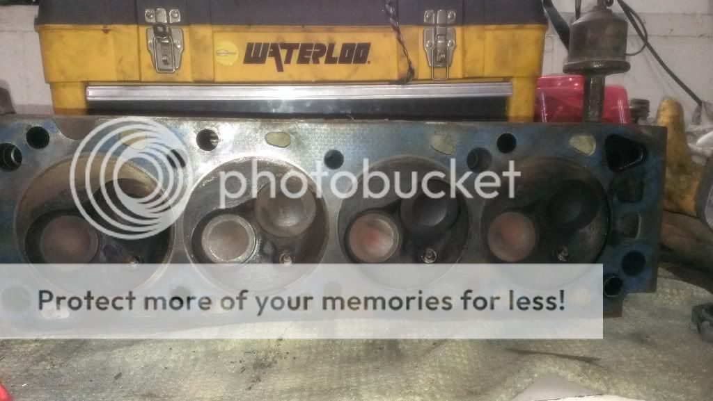

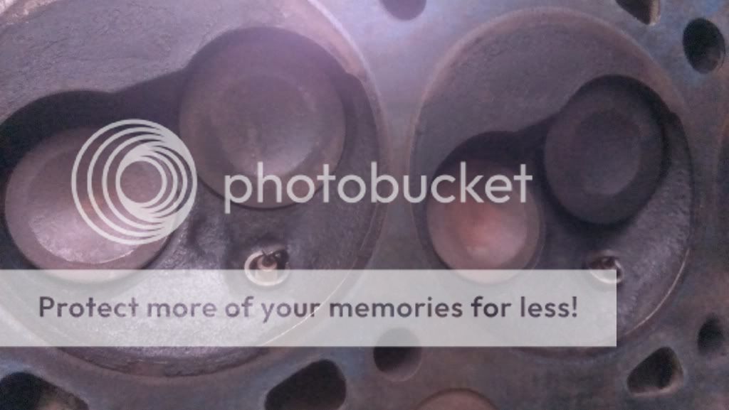

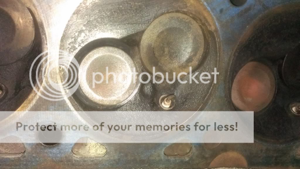

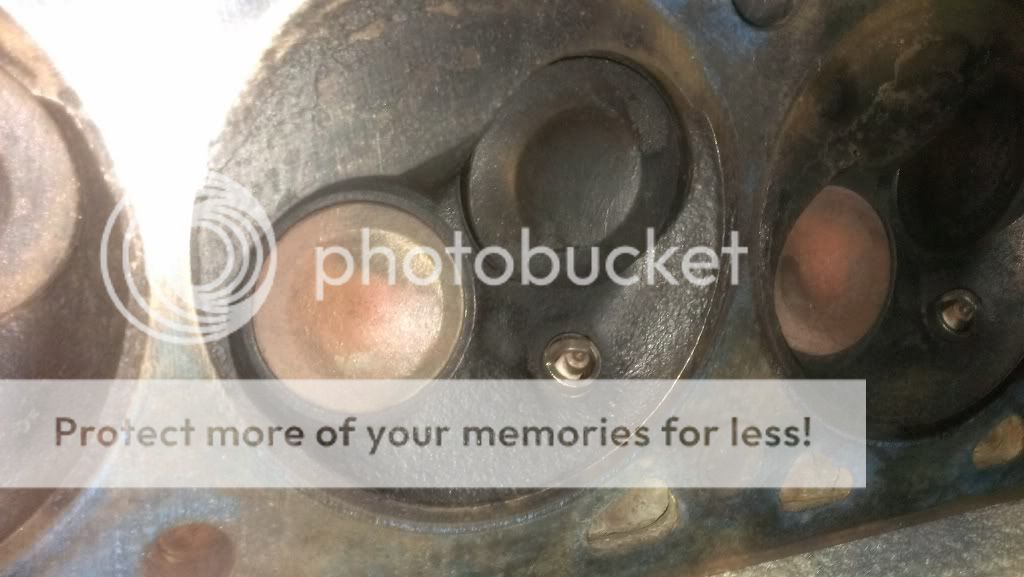

I forgot, I never showed y'all the combustion chamber portion of the head, so here! (Real quick! )
NOW, from cyl 4-1
All in one...
Honestly, IMHO, it looks damn good to ME!

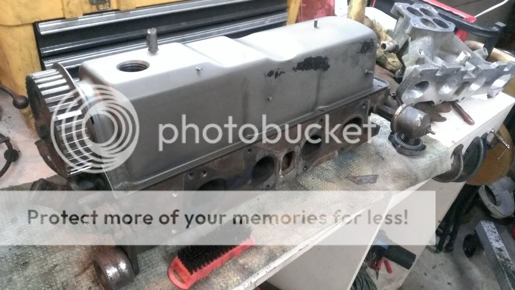

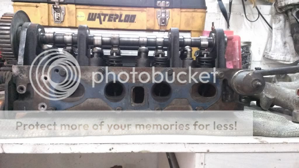

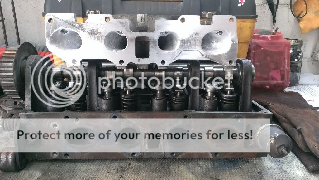

Oh yea.... Meant to post this earlier, this is how the manifold will bolt up - so take a look at the stock head and then THIS picture! You'll see why it will flow MUCH MUCH better! ;)
DuCeZzzz.... SHOTNVA777 aka 7fifty7 RESIDES.
manifold might look like it will flow a lot, but try to remove that much metal from the head and you'll get into water... and the port itself is much smaller so it doesn't make a difference... if you really want to plug the injector holes just get some 9/16" freeze plugs, that works and is easy...

I won't be porting/polishing my head.... The person that builds it will be! Big machine shop that deals with these heads alot due to the local track, so I think they'll know what to do! ;)
