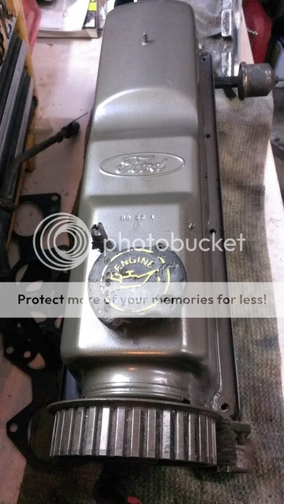

Well.... I got my VC blasted and painted! Everything else will be blasted and POWDERCOATED!
Oh yea... I have a BRAND new oil fill cap on the way lol!
