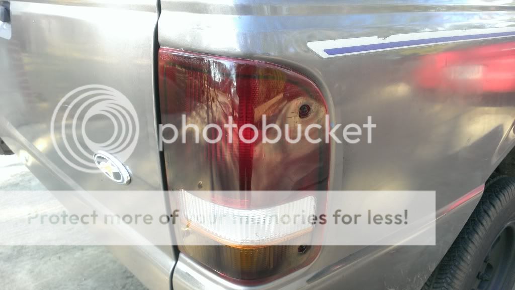

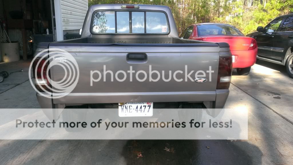

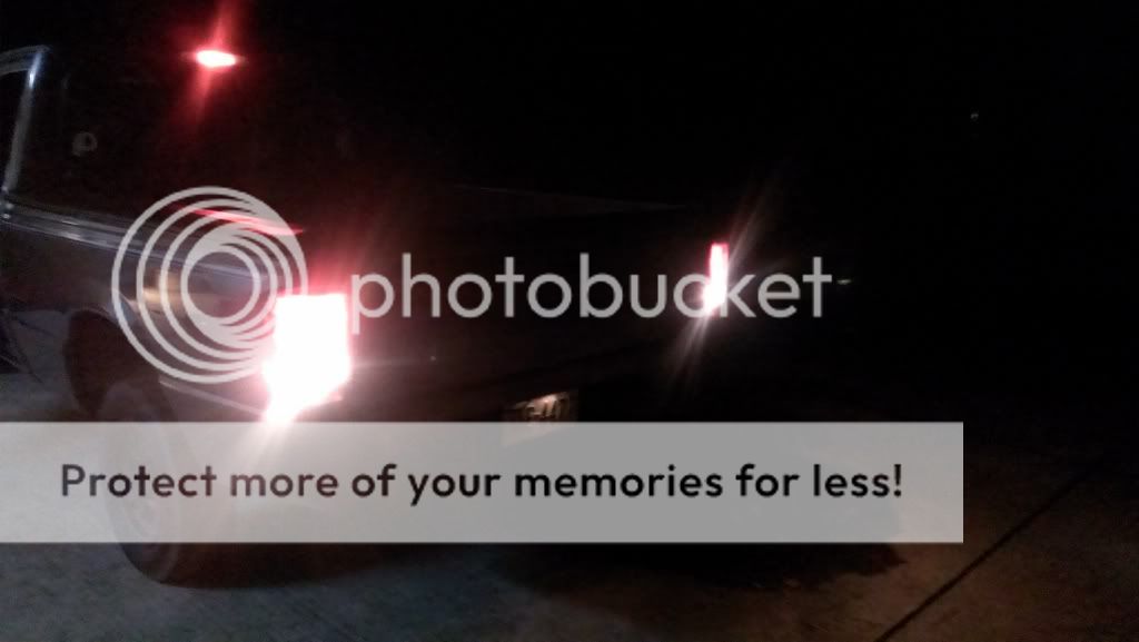

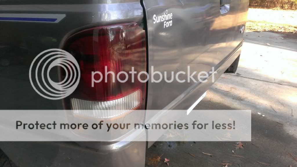

So.... I didn't have time to catch a daylight shot of the tinted tails! All good though, they're still glowing GREAT in pitch black, so I know its a LIGHT tint. JUST what I wanted... And me covering the reverse lights didn't make it look "weird" or anything. Just MORE "professional"!

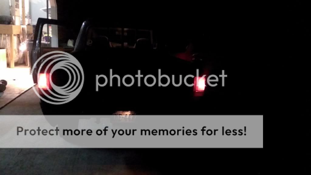

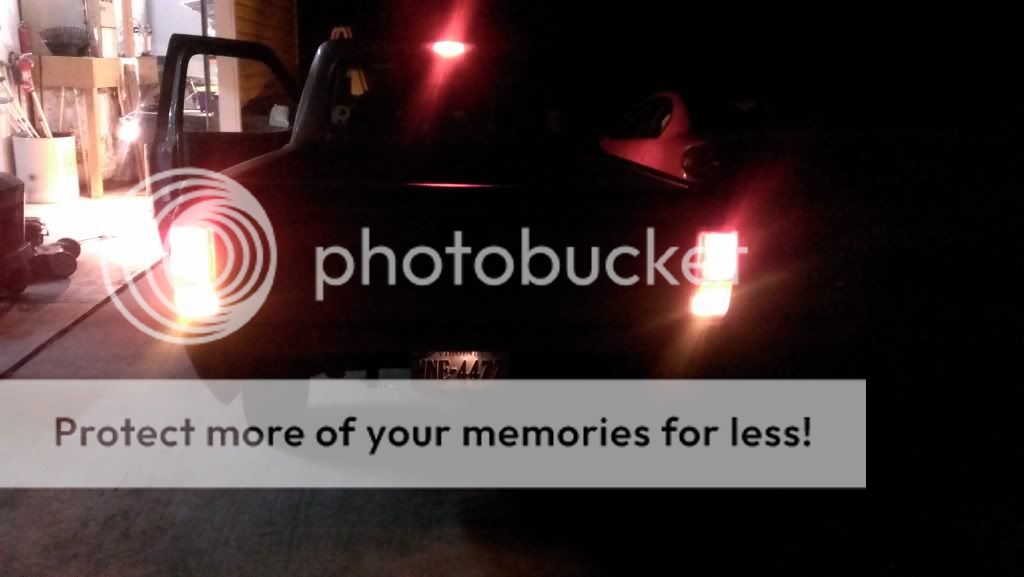

Here's the nighttime photos...
Regular running lights...
Brakes applied...

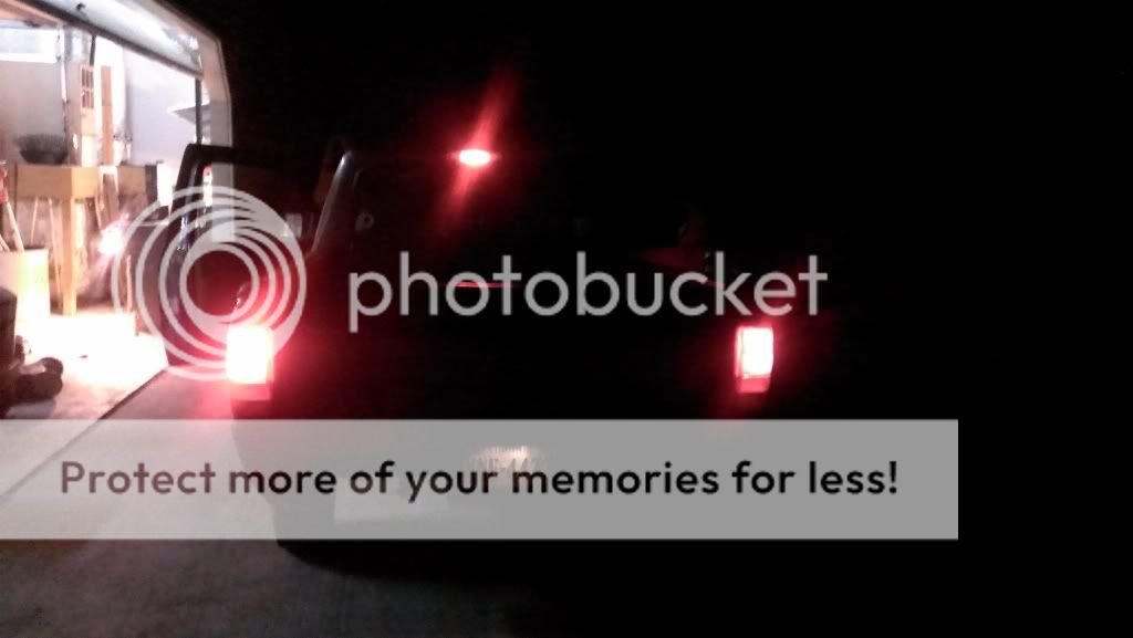

Blinkers/flashers with brakes applied...

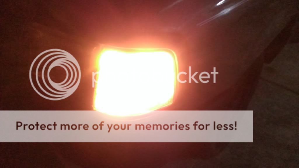

Reverse lights with brakes applied, nice and bright still!
I always seem to spray tint way too heavY...I think this time I hit it on the head!

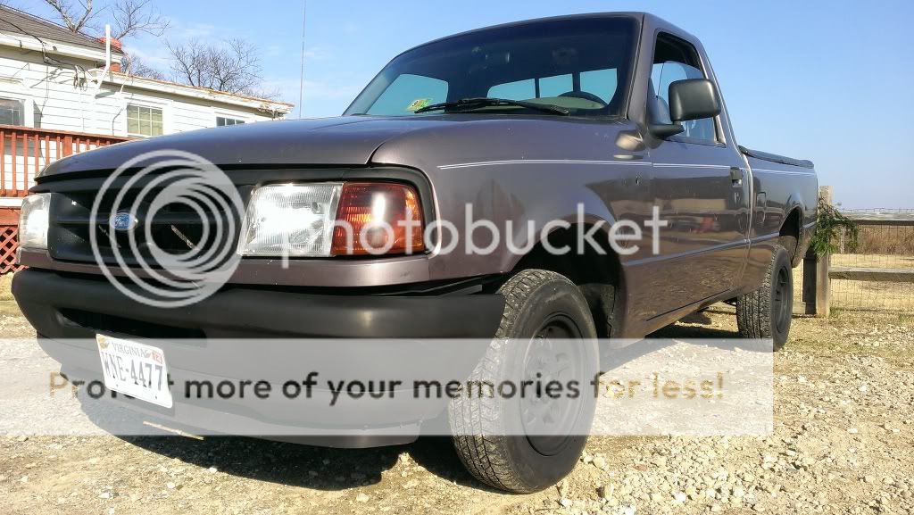

Here's the finished pics of paint job (getting rid of CHROME!!!) and painting the wheels black as well... I'm not too worried about looks, other than a rollpan and the OBVIOUS drop/wheels. It's a Ratrod feel! Straight SLEEPER!
Well atleast I'm finding a few "fun" things to do to the truck!
All that chrome covered black, the tinted tails, blacked out wheels and now the front blinkers are making me think of a flat black murdered out scheme!
Would look RIGHT with the windows tinted, some bucket seats, Hurst short throw shifter (performance as well!) and flatblacking the ENTIRE truck. (Gotta get that rollpan as well!)

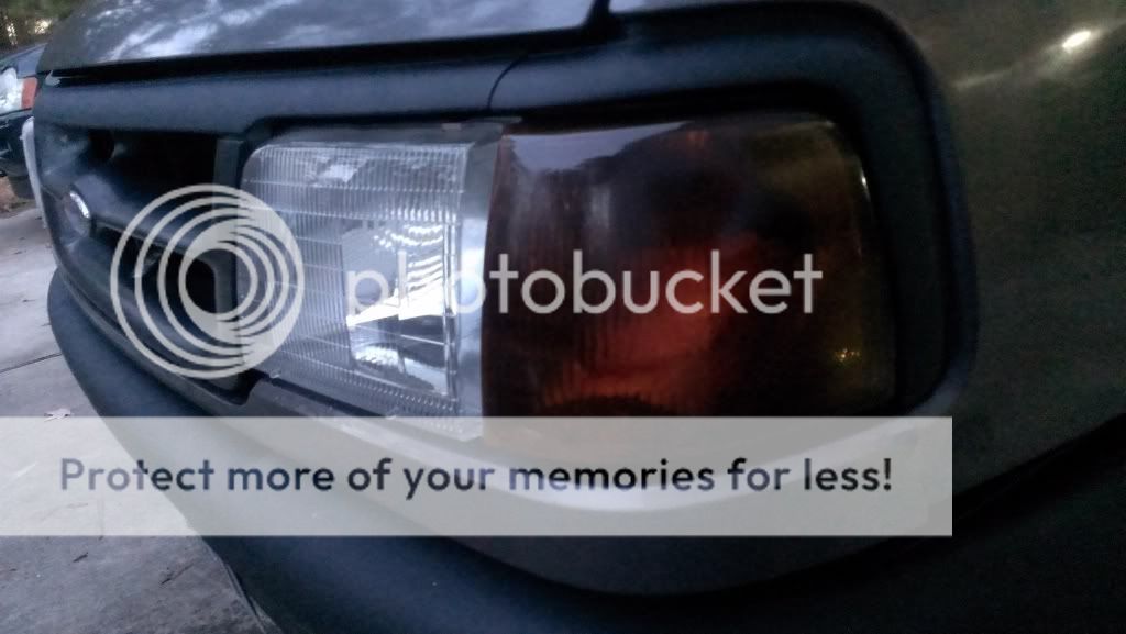

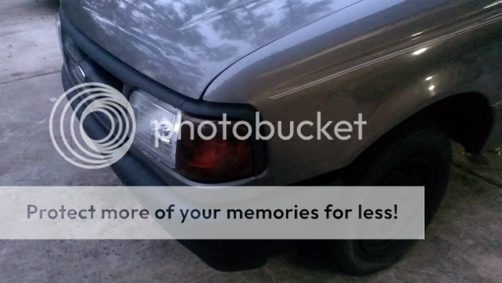

Sorry, it got dark on me, so they look kind of dark... They're VERY lightly tinted, like my tails!
Here's with the lights off.... I'll have a FULL DJM Suspension by the beginning of the year...

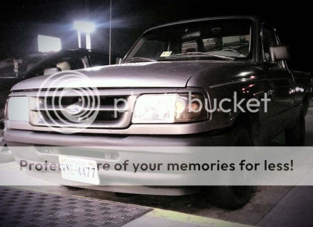

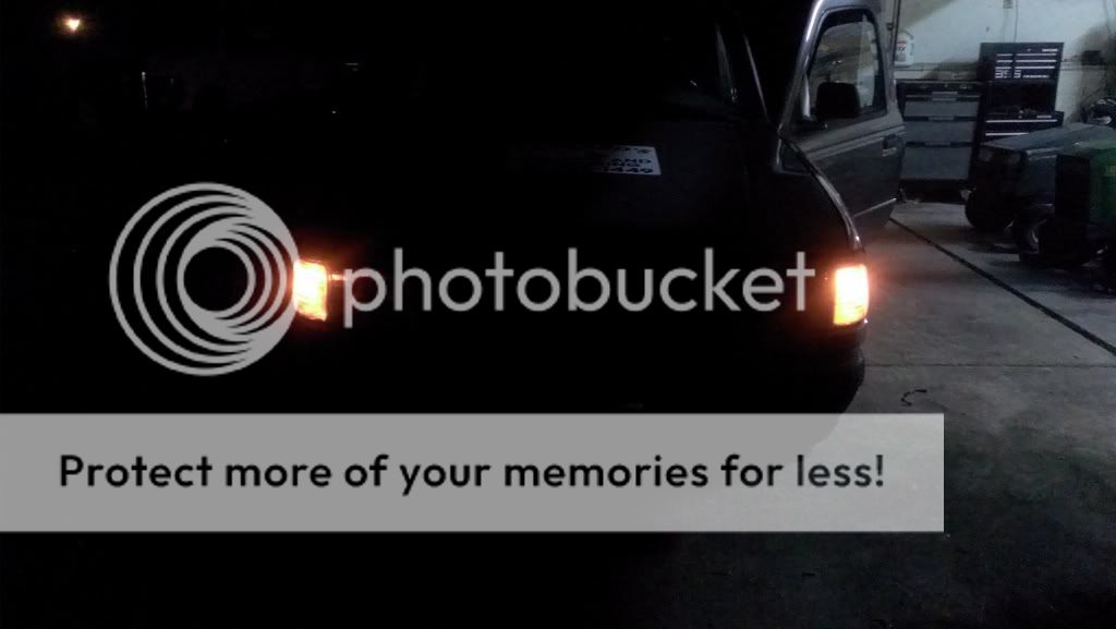

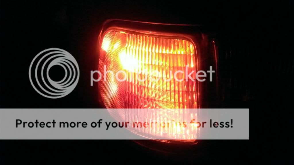

These are just night time photo's of the newly tinted side markers, clearly visable! I'm starting to impress myself with the spray tinting! :icon_rofl:

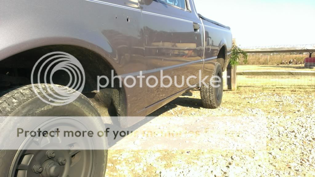

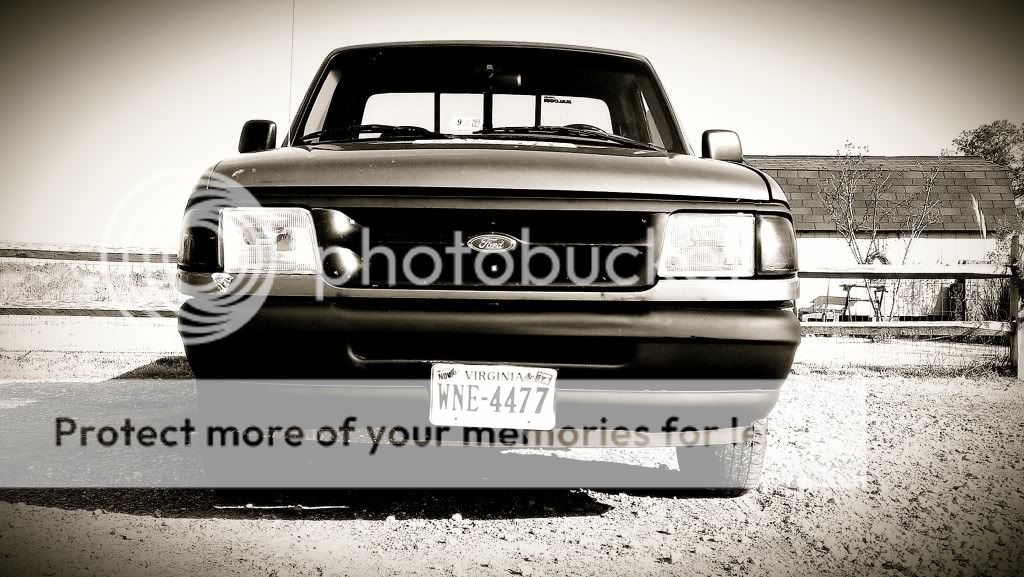

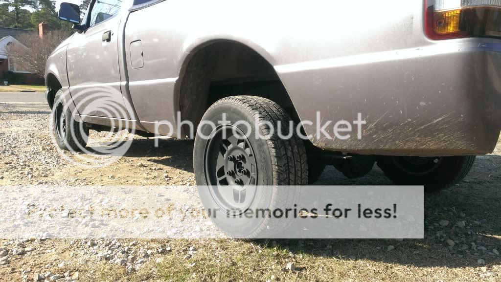

Here's some pics as she sits... Just for reference, as she'll be dropped 6/4 here VERY soon!
Ordered flip kit and 3" drop springs last night! Shouldn't be too my much longer!!!!

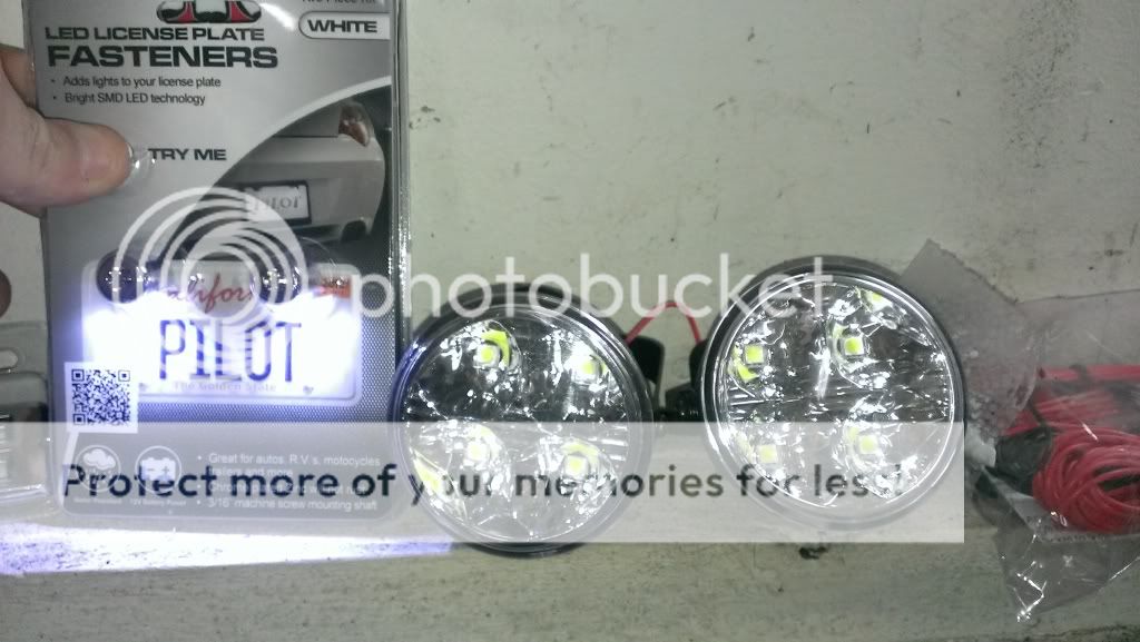

I'll also be installing some fog lights behind the grill, some LED's. Also some LED rear license plate lights. Should make everything look a TAD BETTER! Oh.... And help me SEE upfront! Its like driving with no headlights on right now, because BOTH adjusters are broken!

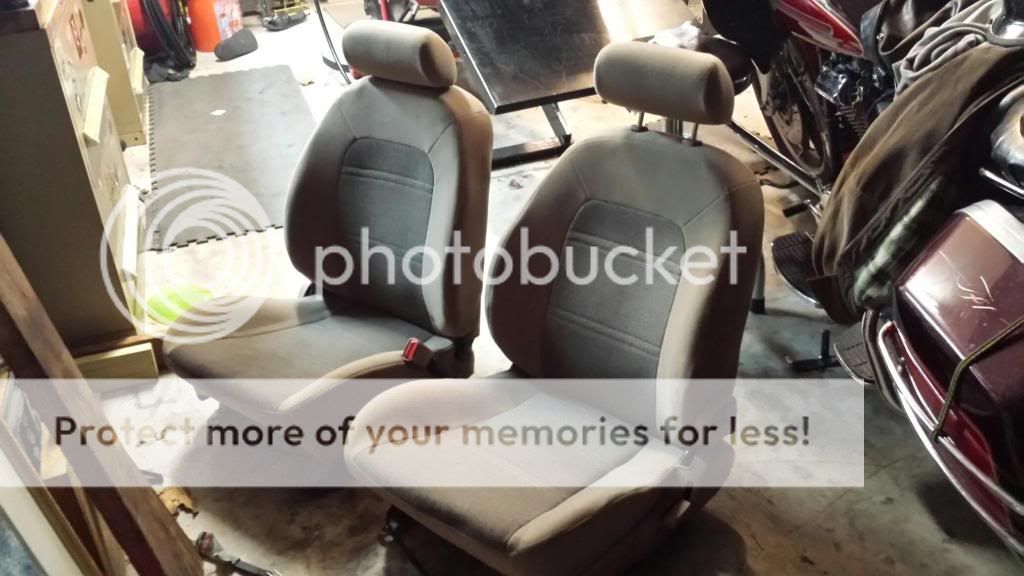

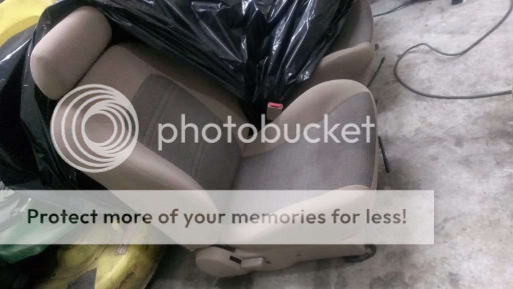

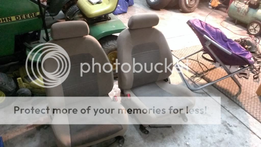

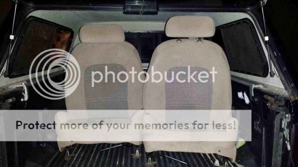

3. BOUGHT THESE!!!! 1992/3 MUSTANG SEATS! GOT EM FOR A STEAL TOO AT $100!!!!

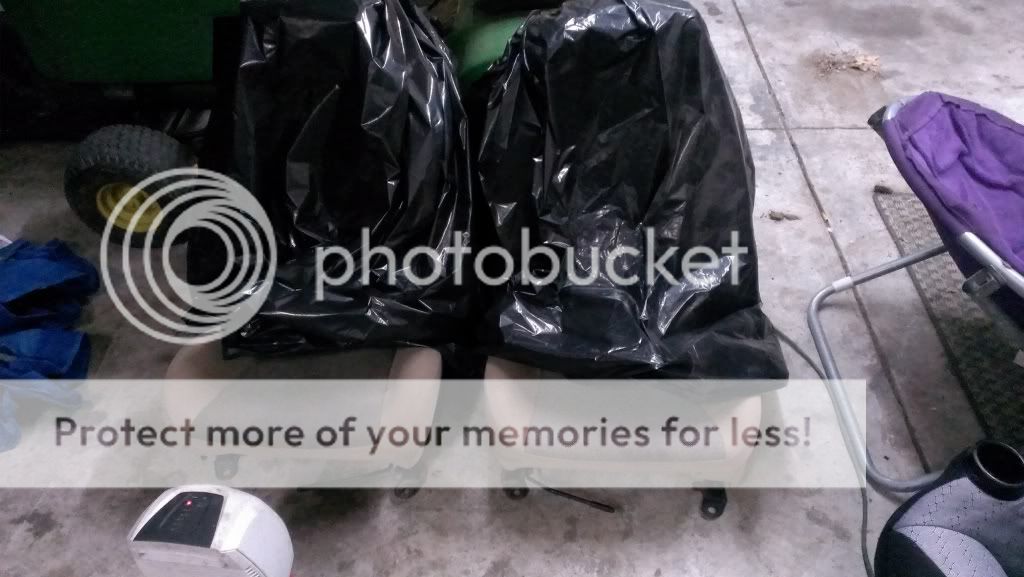

NO..... THEIR ARE NO STAINS, THEY GOT A LITTLE WET WHEN WE PICKED THEM UP, BECAUSE THE TARP STARTED TO BLOW OFF IN THE RAIN! YOU'LL SEE, IN THE PICTURES, THAT I'M DRYING THEM AS WE SPEAK! HAHA... THEY ARE LITERALLY IN SUPER MINT CONDITION AND WILL BOLT RIGHT UP (PRACTICALLY - WELL, WE WOULD KNOW IF WHOEVER THAT DID THE "TRS SEAT FITMENT THREAD" DIDN'T JUST GET F****D BY A MAN, UNWILLINGLY, ON A MUSTANG SEAT! I MEAN WTF?!?! WHY WOULDN'T YOU PUT WHAT YEARS FIT N WHAT DOESN'T?! DUDE WAS SEVERELY BUTT HURT IN SOMEWAY, BY MUSTANG SEATS, BEFORE HE WROTE THAT THREAD... LMAO FOREAL!!!!

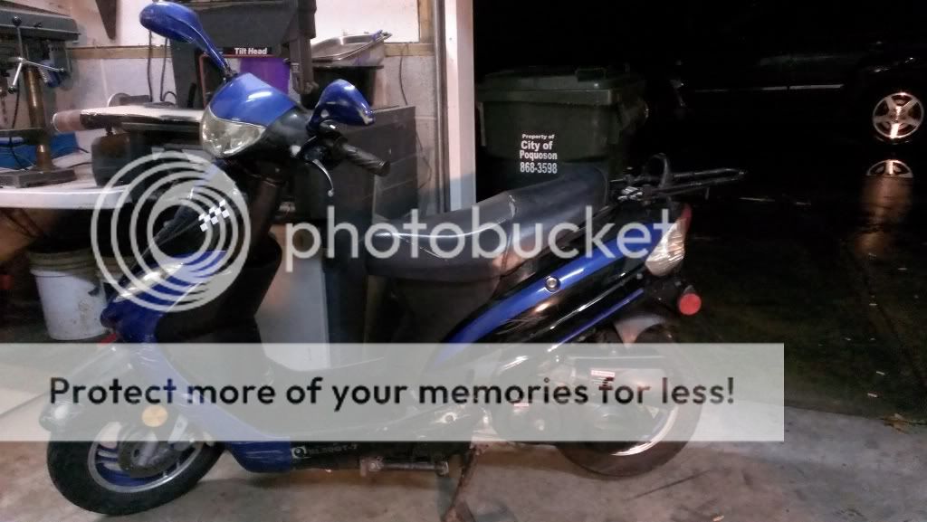

OH YEA! PICKED UP THIS SCOOTER (NONRUNNING) FROM A BUDDY, HE SAID HE JUST WANTED IT GONE AND GAVE IT TO ME! 2 HRS LATER I WAS DOIN 40MPH BY HIS HOUSE!!! LOL!!! CLEANED UP NICE AND ALL! THIS WILL EVENTUALLY PAY FOR SOME OF MY MACHINING WORK! HAHA! NICE!!!!!
BACK TO RANNNGER STUFF! Had to throw a small heater on them to dry em out!
PEEKY PEEKY!!!!
NOW SLEEPY SLEEPY!
