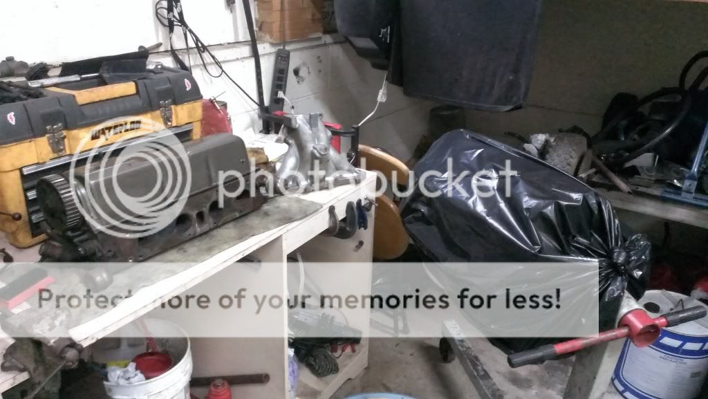

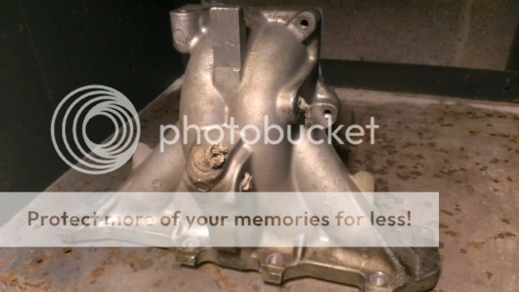

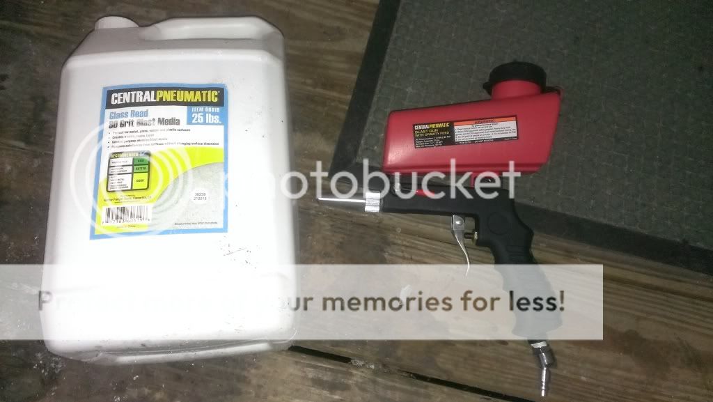

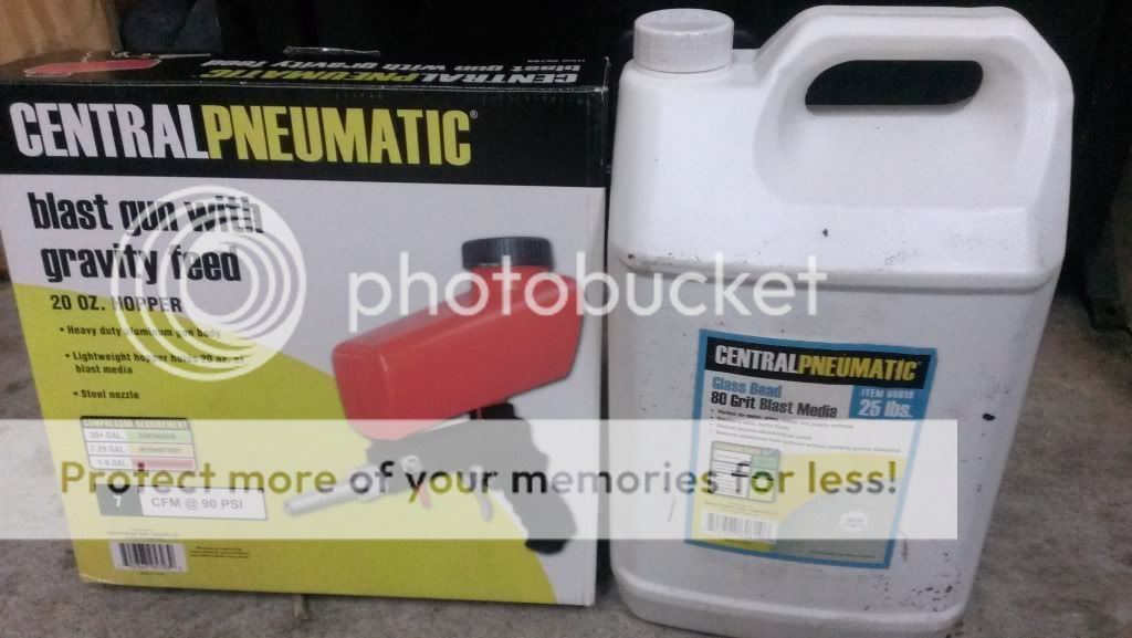

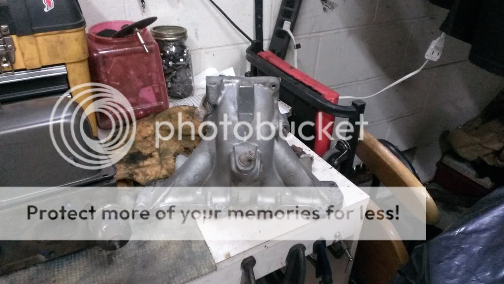

On another note... I picked me up a sand blaster, but my old Speedaire Compressor is begging for a rebuild! Haha.... It gets the job done, slowly.

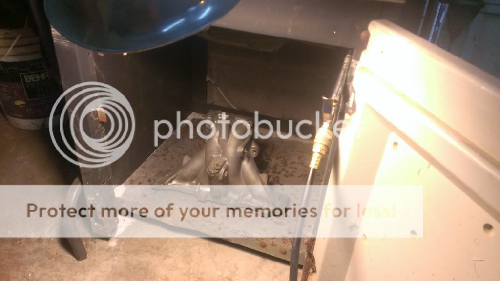

Here's pics of all that, including one pass with the gun before my compressor tripped the damn breaker! Haha... She'll look real clean when DONE, check out the LEFT side of the mani... Head is next! (And block)
My "cabinet" FOR NOW! Lol...

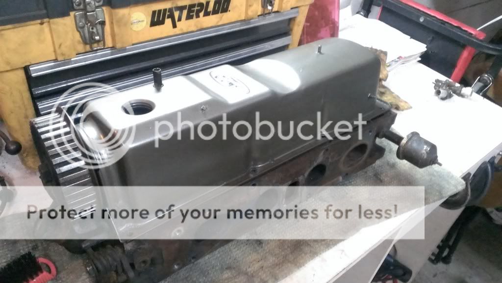

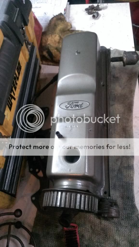

I finished up my valve cover too....

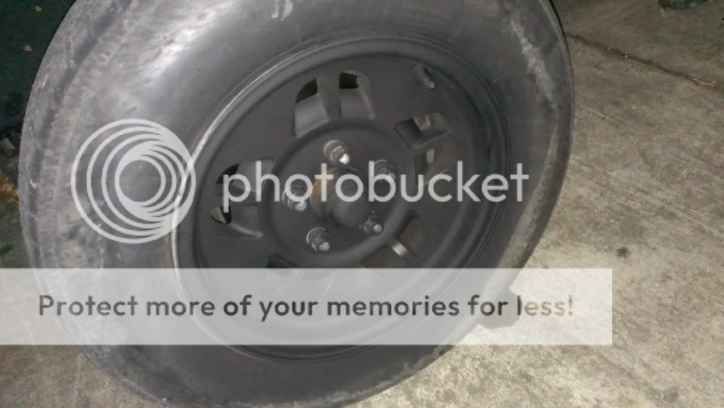

I also painted my wheels.... But I'll probably end up blasting them now. I duno yet. Just flat black "rim paint". As you can see, they haven't had ALL their coats yet. Another good 50HP for ALL OF THIS!

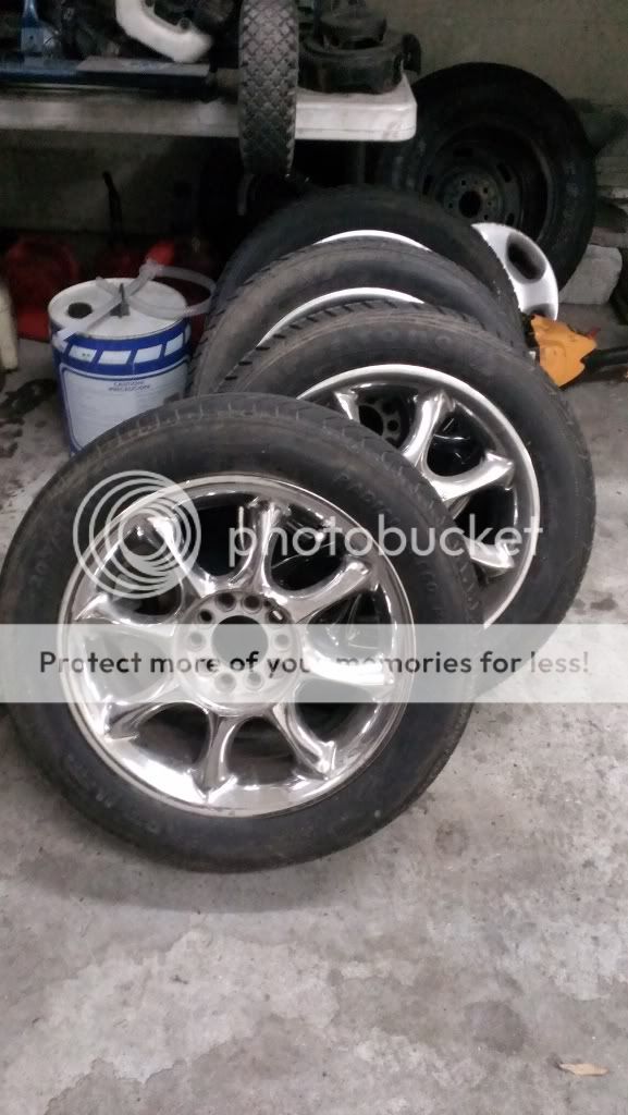

Someone gave me these 16's... SHOULD I run em until I get my Diamond Racing Steelies? Lol...

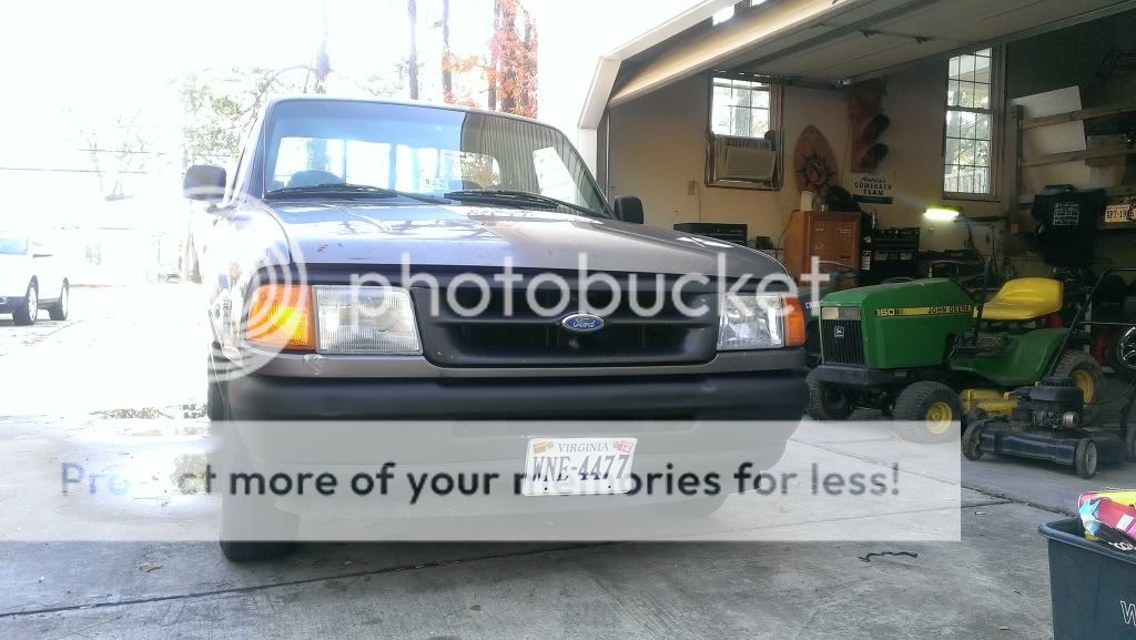

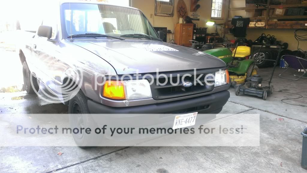

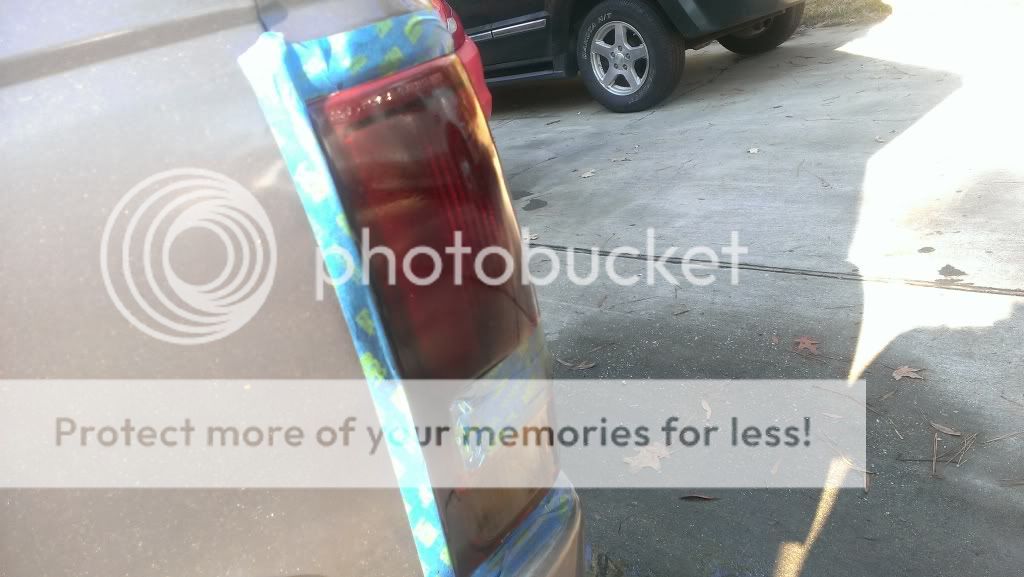

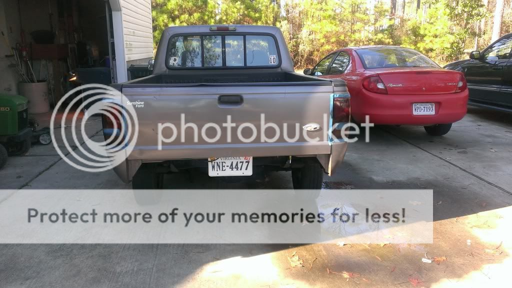

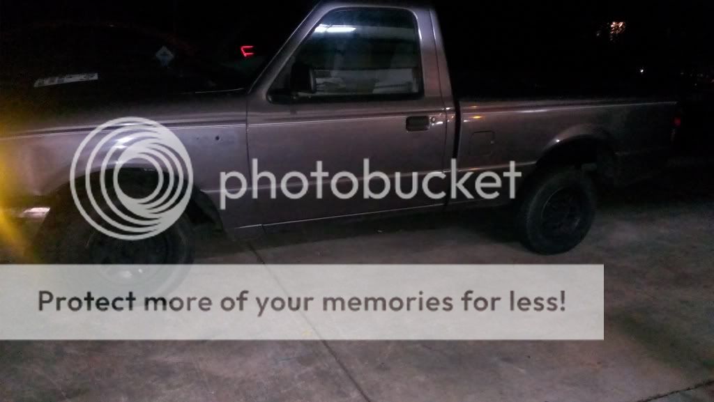

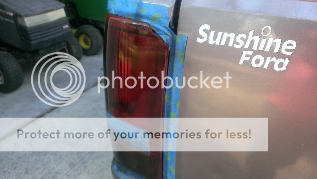

I painted my front bumper and trim (anything chrome) and also tinted my rear tails!
Heres soms picsss...the rear tails are still taped, I just hit em a few mins ago!

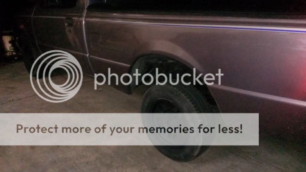

IT LOOKS LIKE A MINI F150 FOR SOME REASON! TO ME ATLEAST! Lol, not surd why??
JUST TRYING TO MAKE IT LOOK A BIT BETTER! I THINK THIS HELPS... :D
I wouldn't bother with those rims. I have never been a huge fan of multi-pattern wheels. They just never seem to ride right to me.
