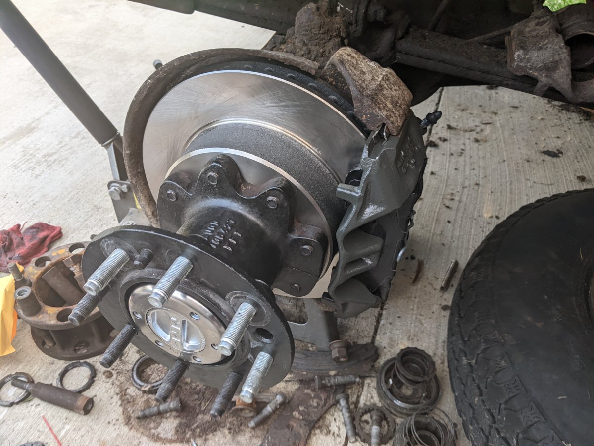

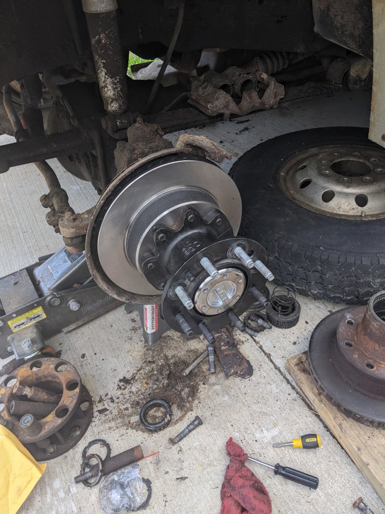

Chipping away at it little by little. Had to track down some rotors for dual wheeled front hubs, but found some.
Got the driver's side button up with new races, bearings, caliper, brake pads, and brake line. I also got a set of Mike Marker hubs. Seem to be a decent upgrade for the Dana 60 compared to the stock plastic ones.
Going to get the passenger side done tomorrow or by Monday and pull it in the garage this weekend.

Finally got it buttoned up on the front brakes.
Ran into some issues trying to bleed the brakes on the rear.
Never could get fluid to come out of the wheel cylinder. Not sure if it is an ABS issue or what?
I believe 87 is the first year of ABS on the rear in the F series.
I'll keep working at it, but did get the front brakes bleed to work for what I need for now.

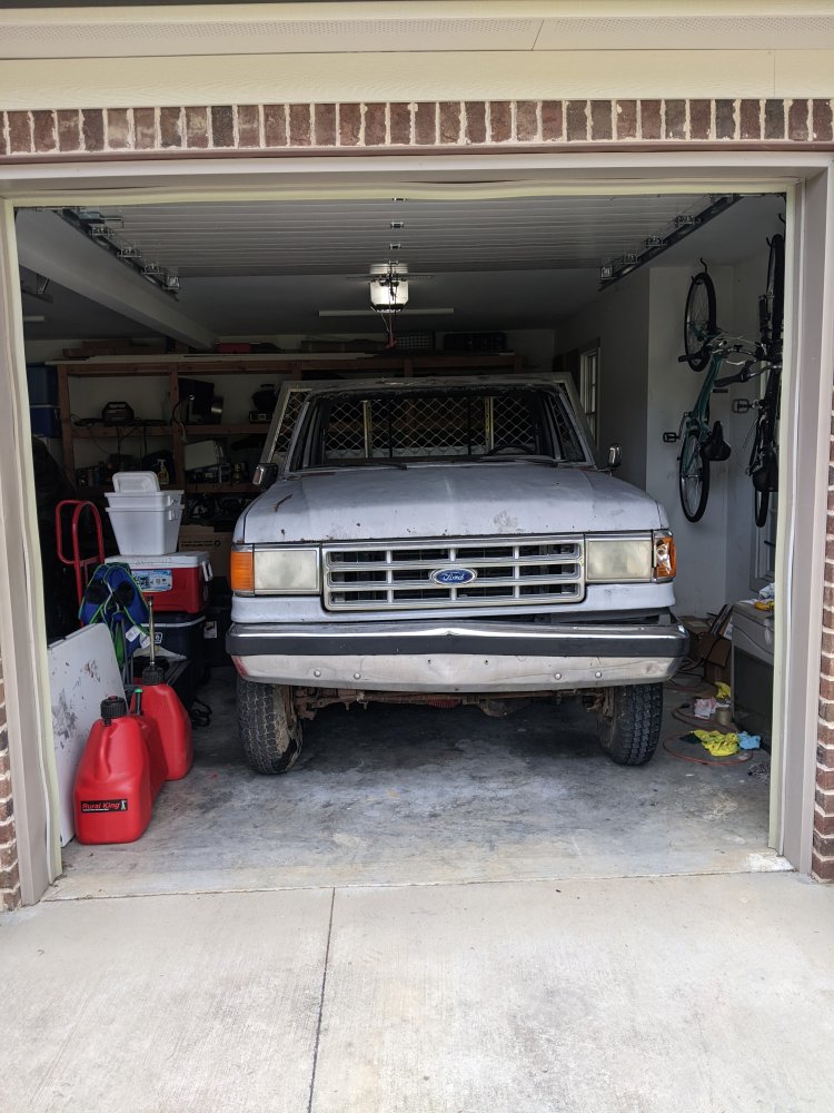

Was able to pull it in the garage under it's own power, no more tarp!
Now the real work begins again.

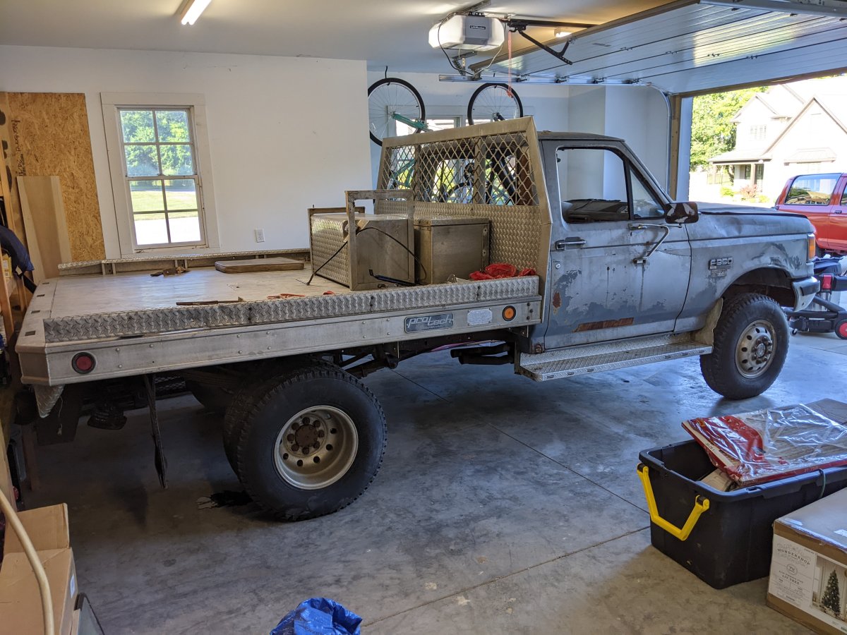

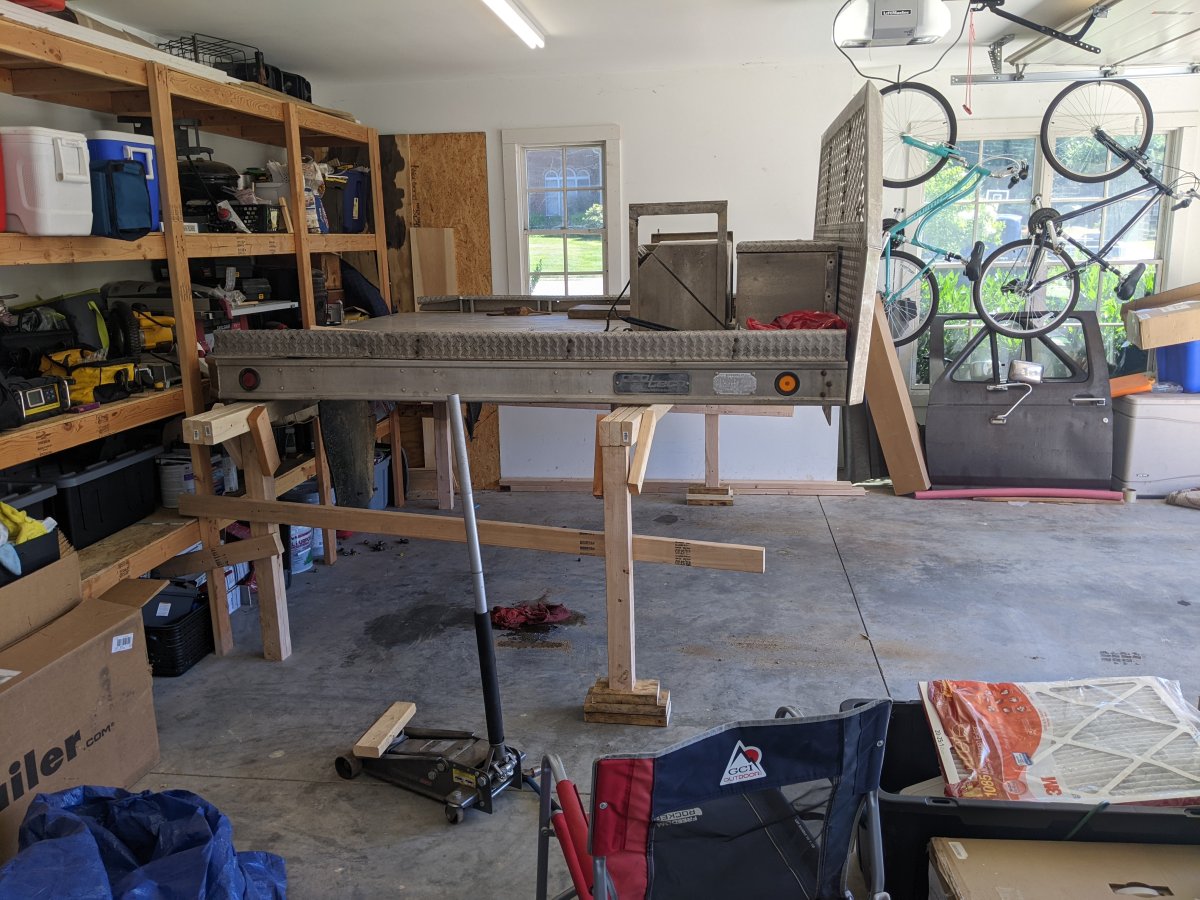

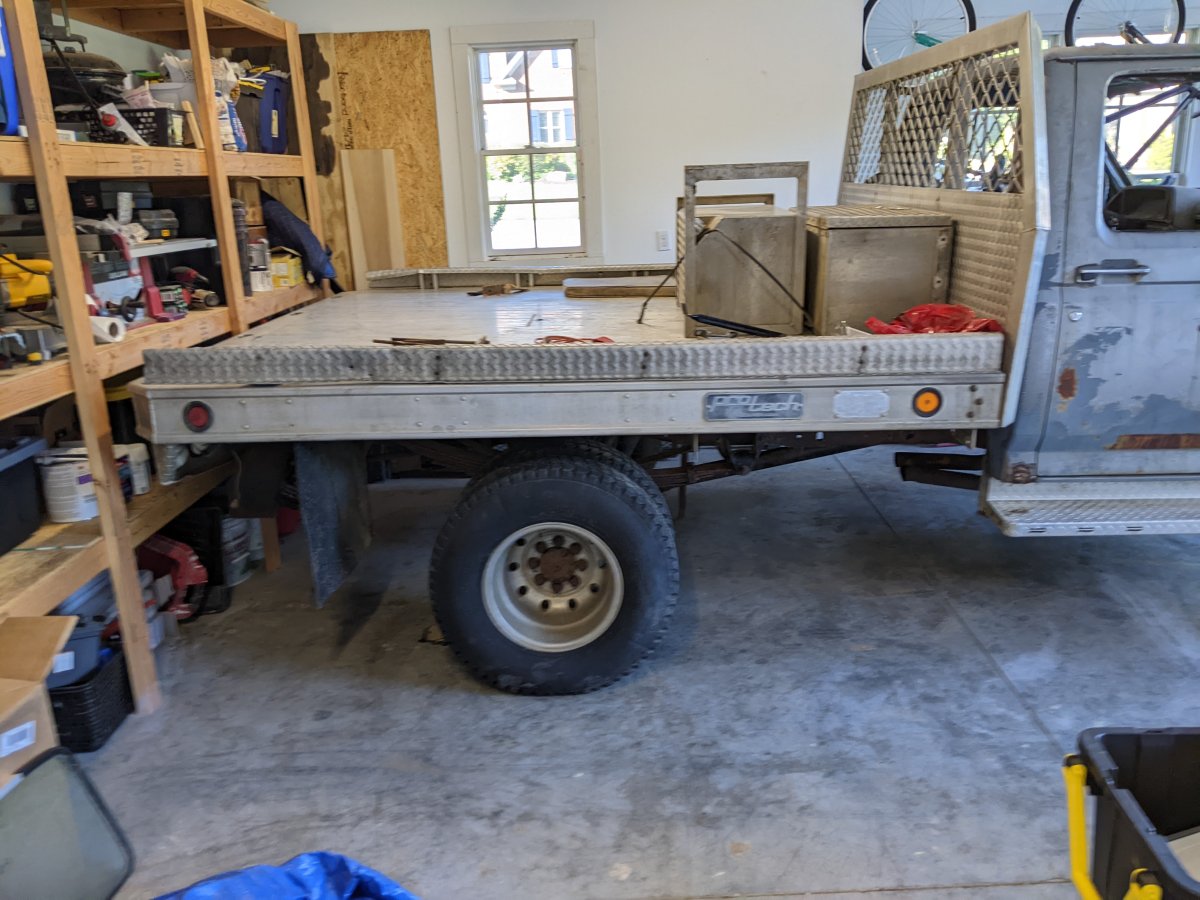

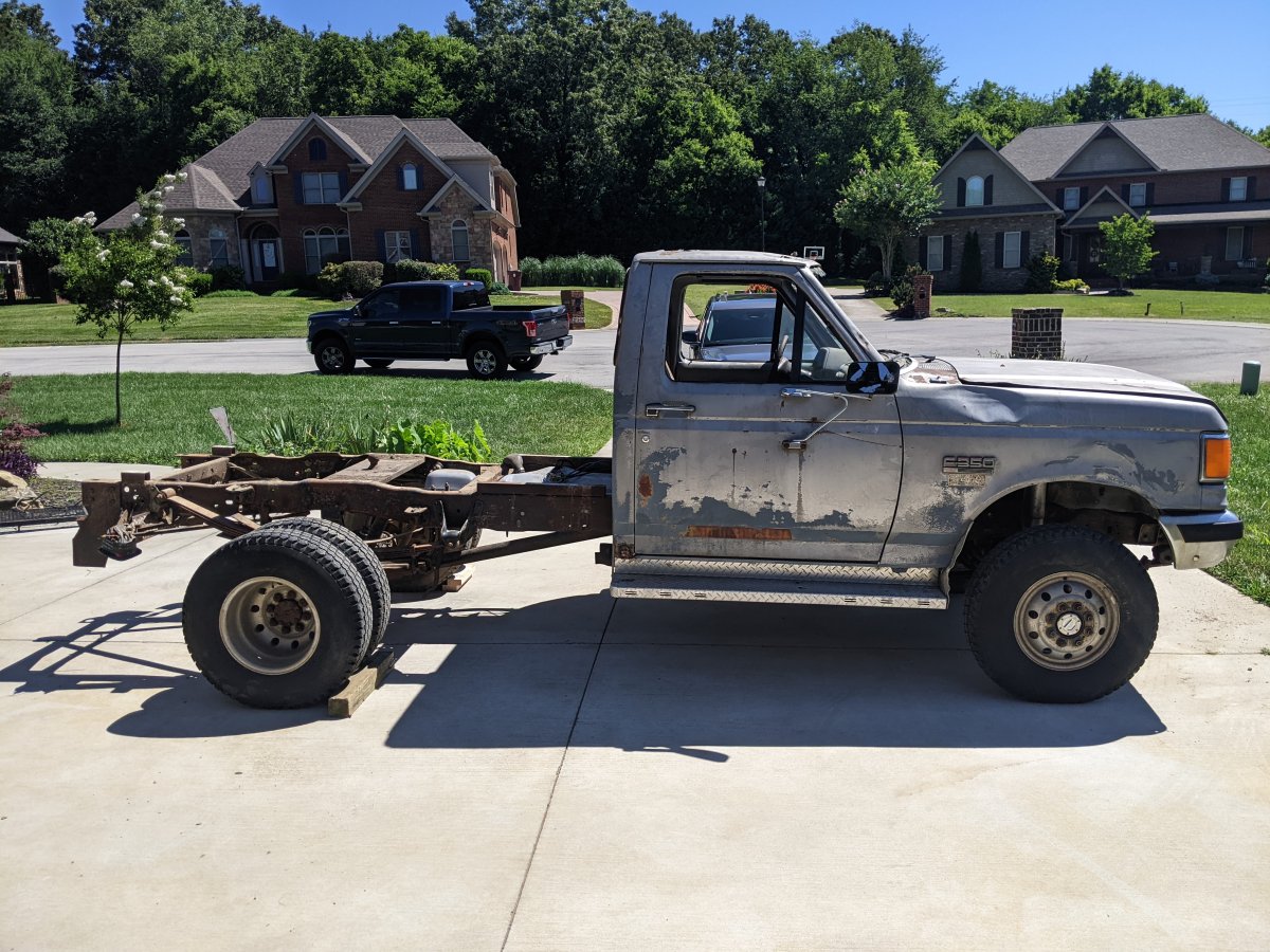

Making some more progress. Got the bed loose today.
Goal is to make something to support it so I can back the truck up under it and pull it out to work on the body work.
Then the real work begins!
  • Papaw's F350 Dually
And.... We have lift off. I can pull the truck out and work on it or work on the bed and store it all in the garage at the same time.
Flatbed makes life a lot easier when it comes working on truck for sure. I can crawl up under the truck and sit down and work on things.

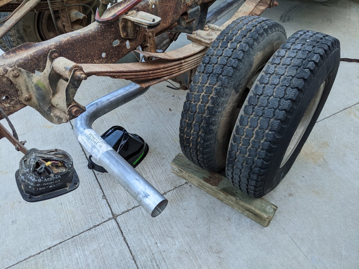

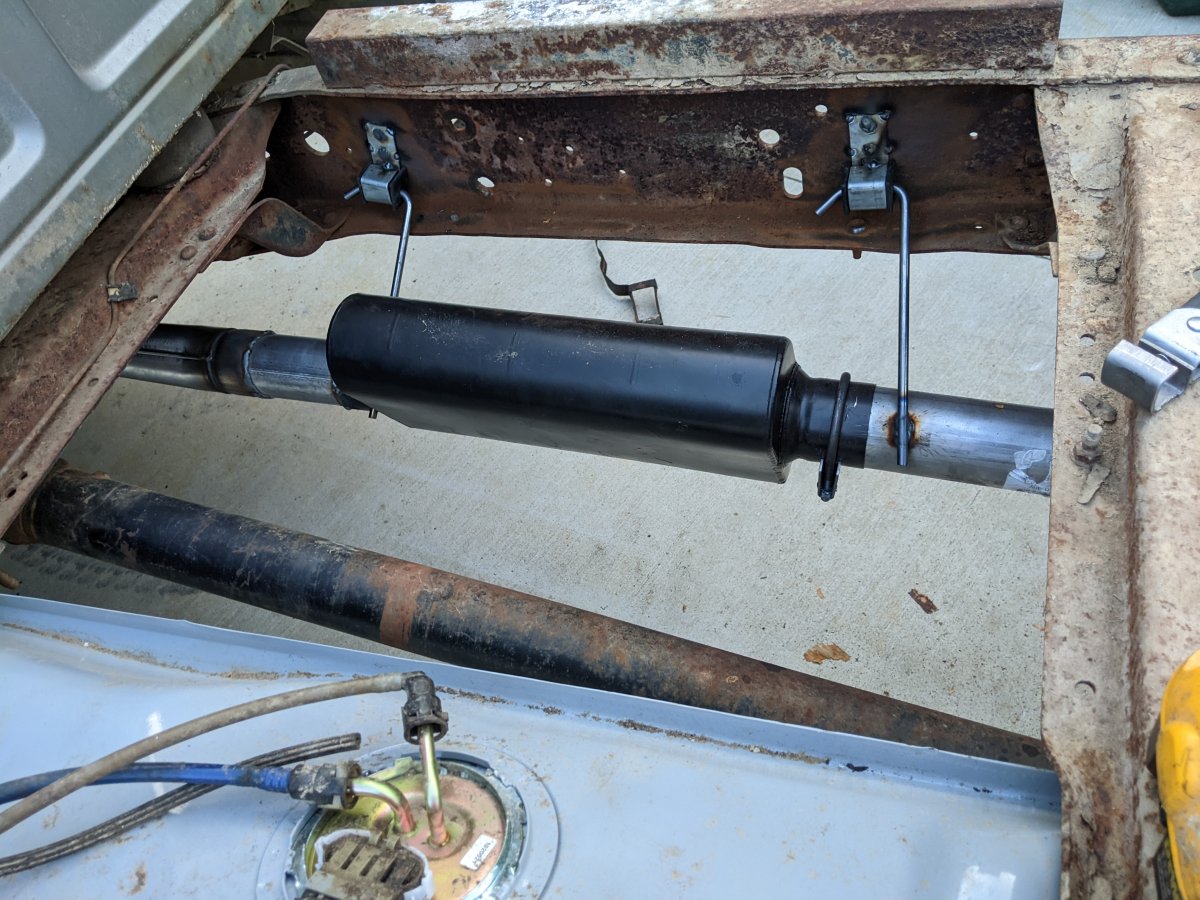

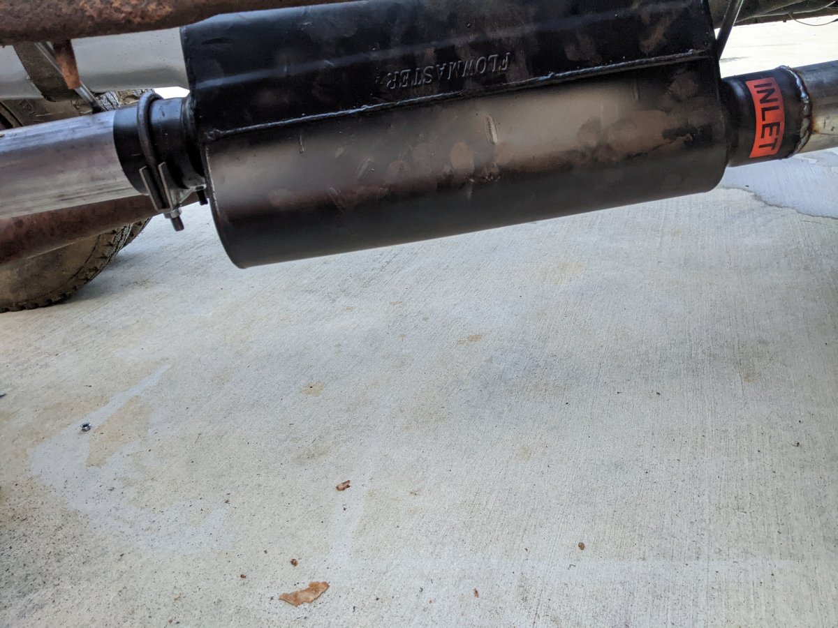

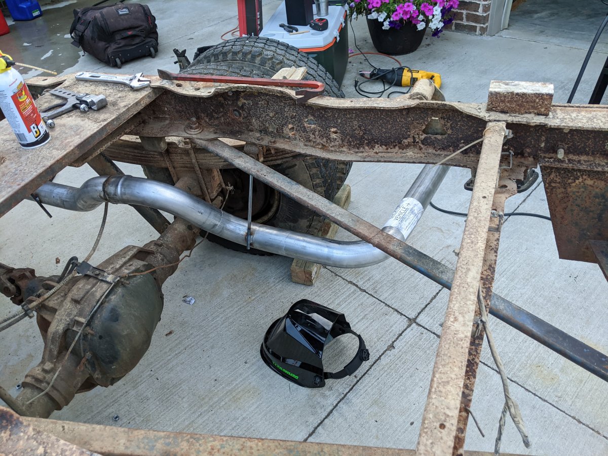

Decided to finally put an exhaust on this rig. The pipes were vibrating because it was all loose and I thought I would crack a manifold or something.
When it sat in the field for so long, I thought that the tail pipe and the muffler had rusted out and fell...
To my surprise some idiot took a sawzall to it and cut the exhaust loose and stole the muffler... Some druggy must have thought it was a massive catalytic converter and thought they hit the jackpot. But they stole a worthless muffler.
This truck was the one of last Fords made with a non catalyst sticker under the hood. Since it was over 8,000 GVWR rating. So no cat to steal.
Anyhow it was dual exhaust all the way into the muffler and had a flange that connected duals into the muffler. Then it came out single from the muffler.
I ended up cutting out the flange since it was begining to rust out. I got a stainless Y that is dual 2.5" into a 3". Then I went 3" into the muffler and out the to the tail pipe.
I pieced together the kit from eBay and Amazon. I'm pretty happy with it.
I just converted my harbor freight welder over to solid wire with shielding gas and welded up the system. I haven't welded in a while. But I think I did ok and got it all buttoned up.
Went with a flowmaster 50 series, sounds pretty good and much quieter than right of the manifolds.

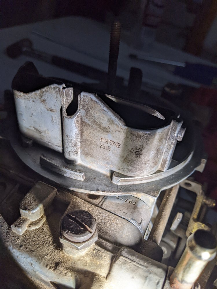

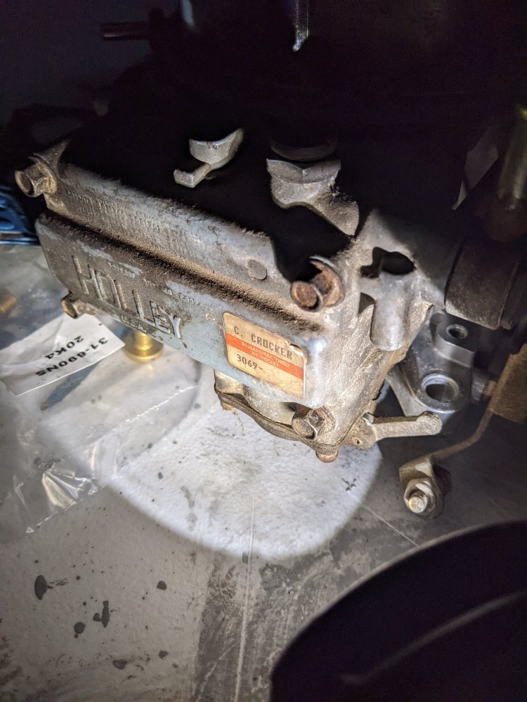

I pulled the carb today to do a rebuild. I believe this is a replacement carb already and I'm trying to track down a rebuild kit. I got one on Rock Auto already and I'm not impressed. I would rather have a NOS Motorcraft or a Holley.
Part number stamped into the air horn is 80457-2 and looks like a SN of 2919? Looks like it was maybe a replacement from Holley?
I did find this NOS kit on eBay, but not sure it is correct.
I'm not completely against replacing this carb either if it makes more sense, just trying to get it to run as well as I can.
Future plans might be a new intake manifold and straight up timing set and maybe a cam, but I'm going to fix everything else before I dive into engine mods. Just want it to run well until I fix everything else.
@19Walt93 any advice? I've read this emissions tuned carb can be difficult to tune at times.

Looks like this would work as a Holley replacement.
Looks like this is already a replacement carb from Holley vs the 4180C with a little more research.
Sounds like the rebuild kit I need is Holley 37-119 and I got one on order.
