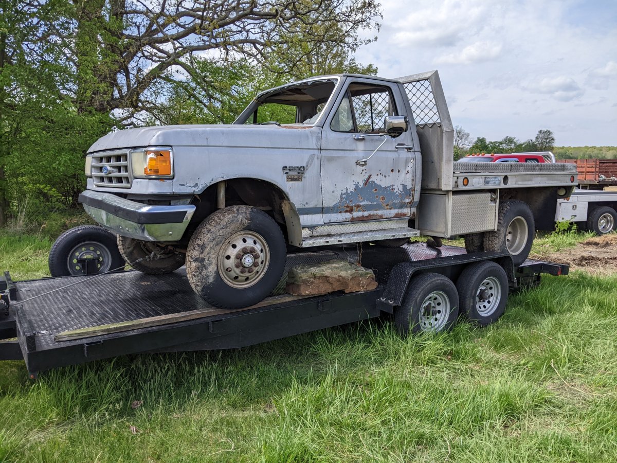

Got it loaded up and got it home last night.
I have my two doors and fender from the left over trucks in the woods. I was able to get the rear glass out of it too.
Worst part of the body work will be getting the dents out of the roof from where the kids knocked out the clearance lights. Without the windshield in it right now, might not be too bad get the dents in better shape. The cab corners will need some attention.
This one is going to be some work, bit the engine looks like it might be in better shape then I remember.

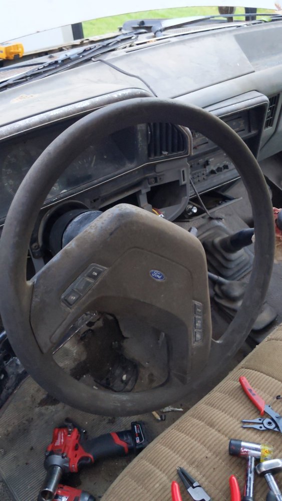

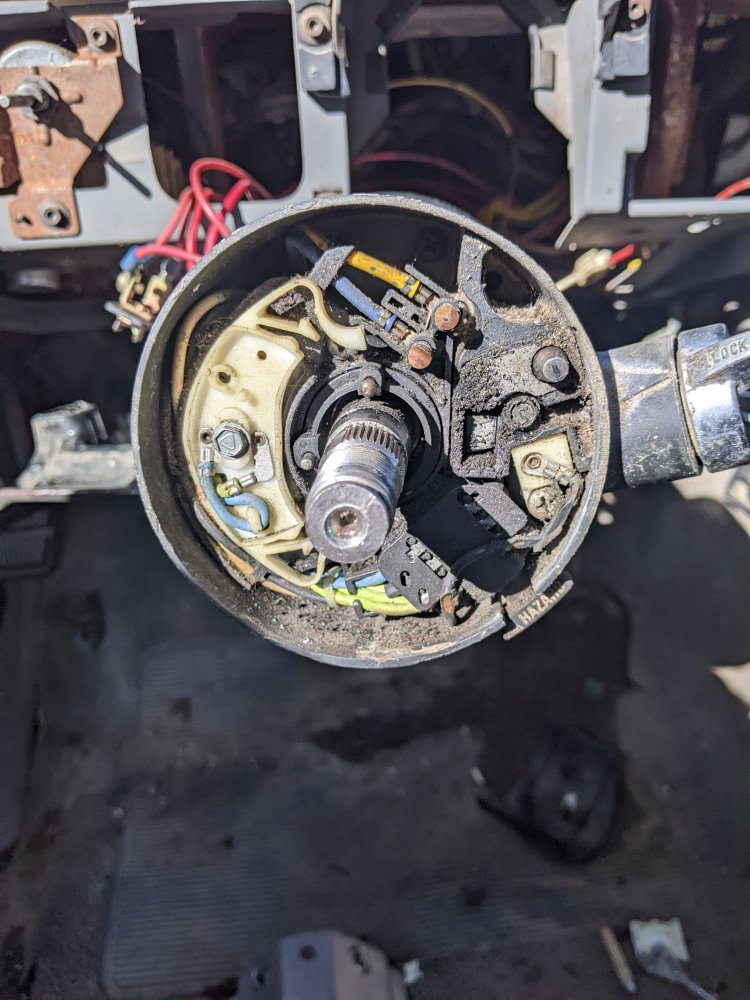

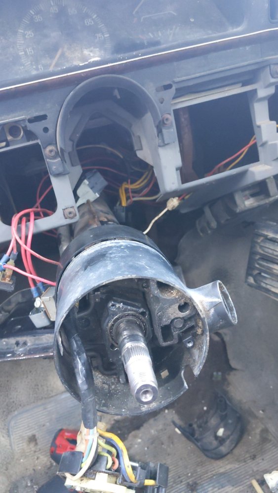

Dove into a new a ignition switch and ignition actuator tonight. Anyone who has owned a bricknose knows what a ignition actuator is.
Got it buttoned up for now. It has had a button for the starter for quiet some time. I'll leave it as is for now to get it running.
More importantly I've got power to the fuel pump wiring and the coil now with the key in run.
Waiting on new fuel tank then I'll get it all going. It's hitting on starting fluid, it will run once I get good fuel to it.

The ignition actuator has caused a lot of pain over the years. I do remember having to start a few of his 87-91 trucks with pliers.
I spent extra time with a file on my dorman replacement that was cast aluminum. I filed all the parting lines and made sure it fit and didn't hang up. I also lubed up the slides. Seems to be working correctly. There is an adjustment for the switch it self, but mine is working currently and don't want to mess with it unless I need to. The push button for the starter seems to be working well for now.
