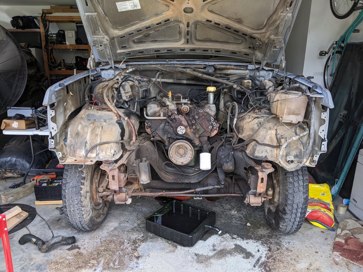

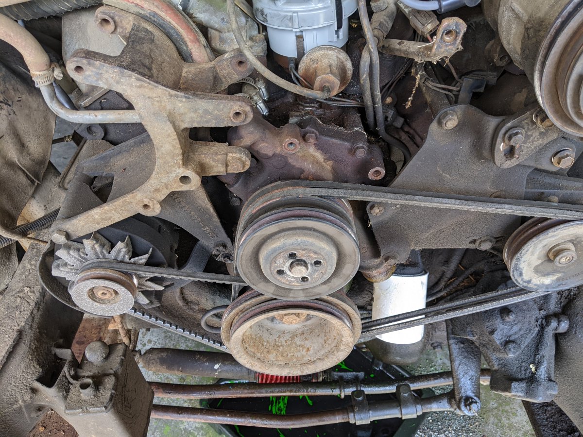

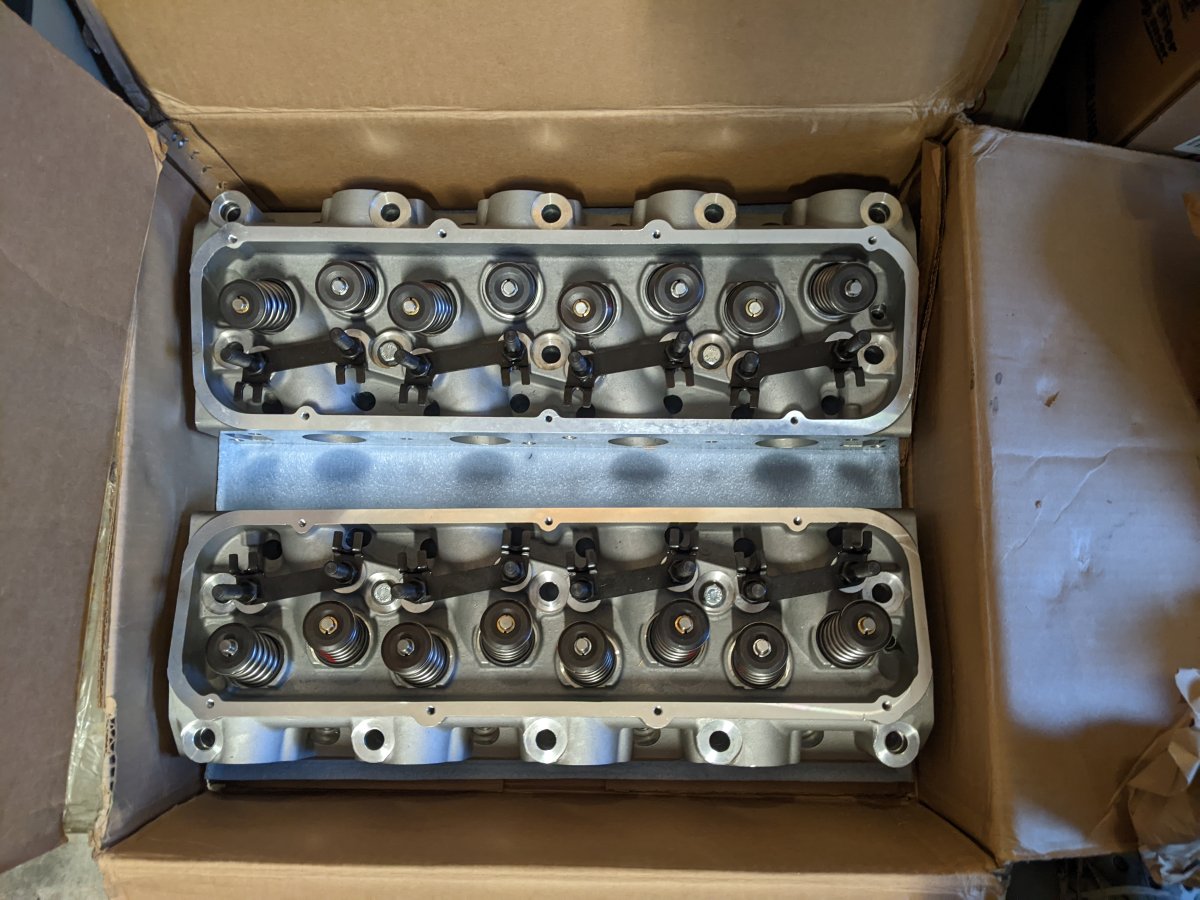

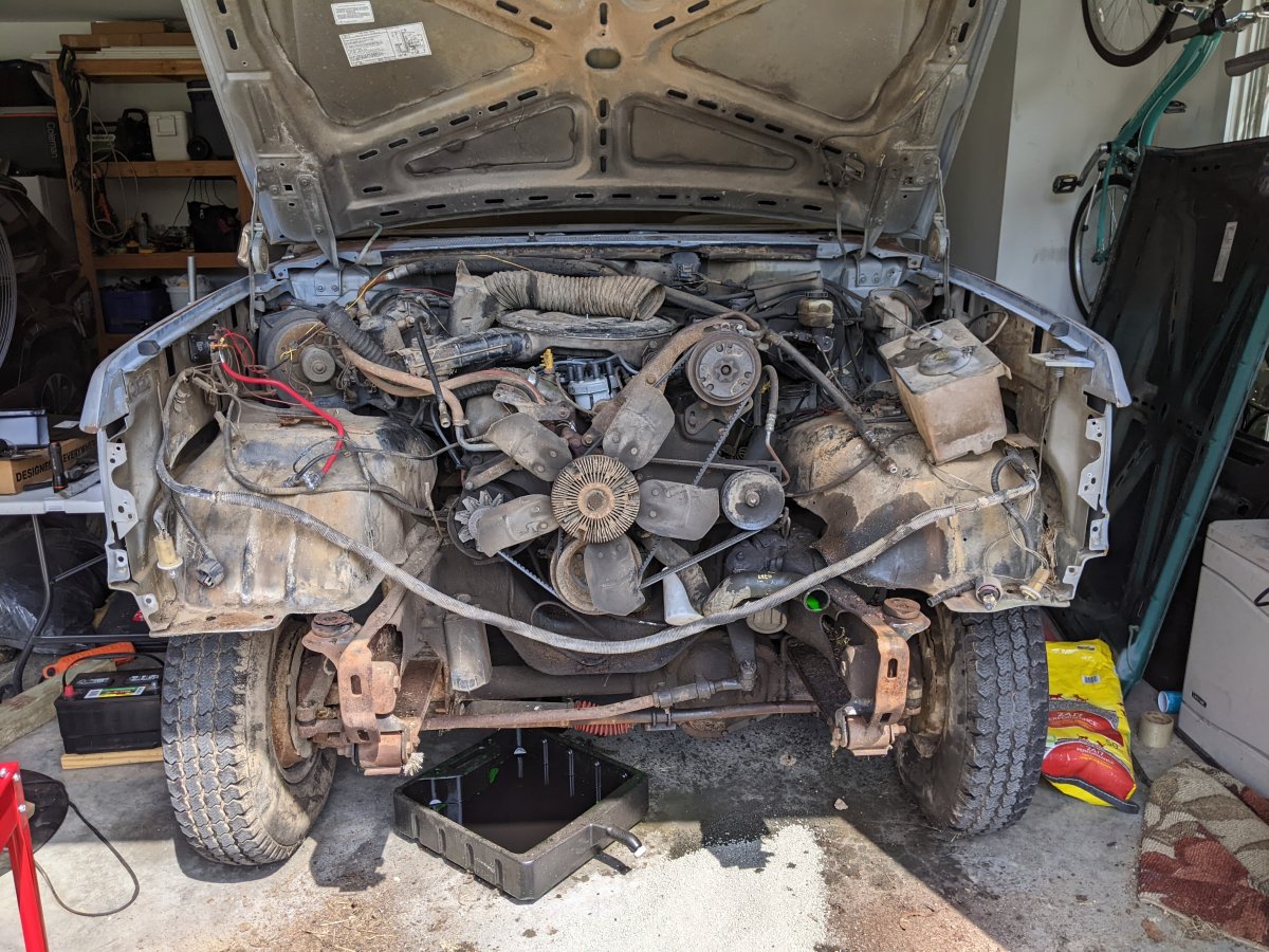

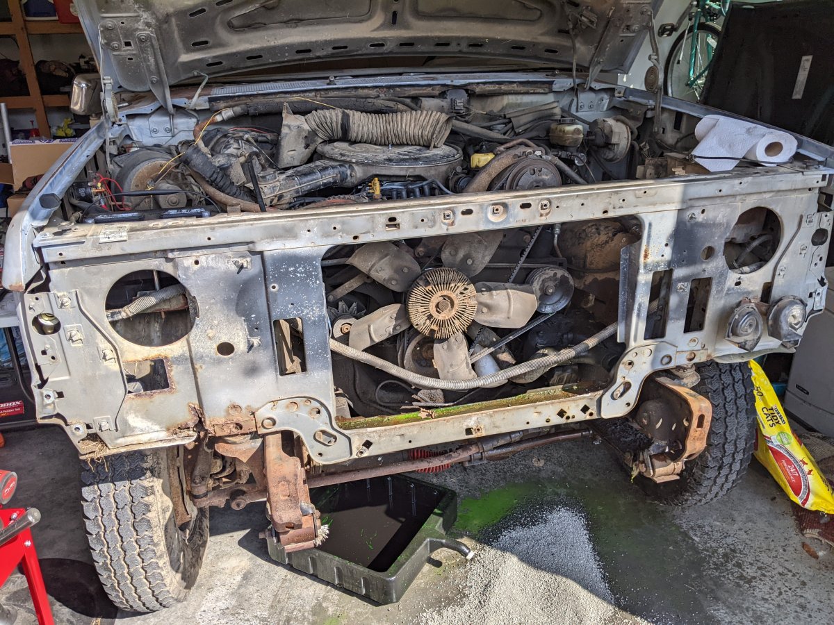

Then my engine parts started showing up... Decided it was time to get the engine pulled. So I began work on that this morning.
I decided it would be easiest to take off bumper and pull the core support. Wasn't too bad of a job, just a lot of hardware to bag and keep up with.
Everything came loose pretty easy including the exhaust collector bolts.
Tomorrow I'll be borrowing a buddy's engine hoist and putting it on an engine stand. I'll take it down to a short block and take it to my local machine shop this week.

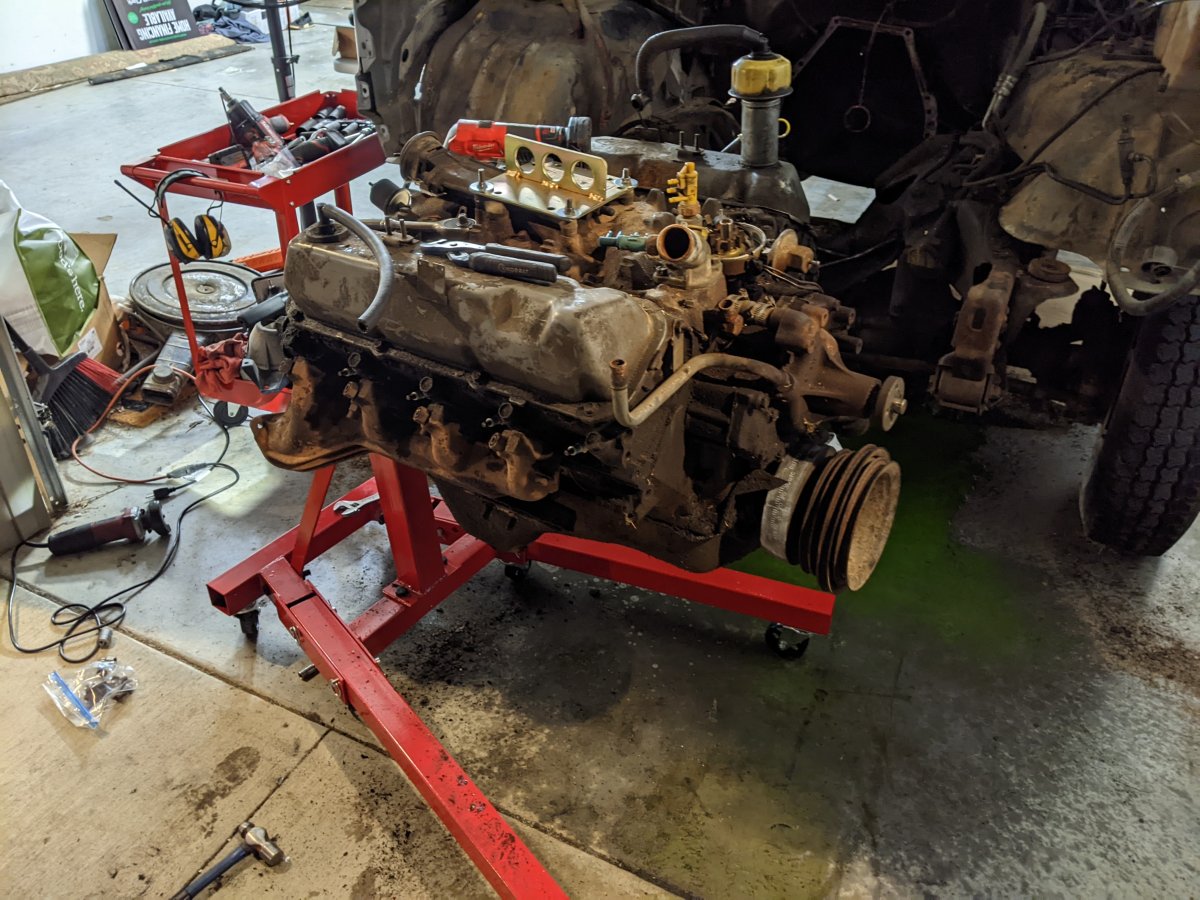

And the engine is out!
Really wasn't bad. I don't know how many people's first engine pull was a big block Ford, but it wasn't that bad. Only had one small hick up with a stripped bolt head on a clutch. Cut off wheel took care of that.

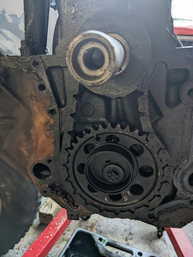

Now I get to open Pandora's box this week and see what we have to work with.
  • Papaw's F350 Dually

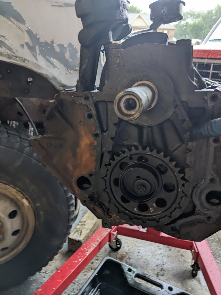

It was definitely a good move to pull the engine. Timing chain had enough slack you could almost take it off the gears without taking it off the crank or the cam.
The oil pump screen was clogged with I don't know what kind of sludge.
Crank and connecting rods have some wear as expected, but nothing crazy.
I'm shocked the thing could run. Just shows how tough these old motors are.

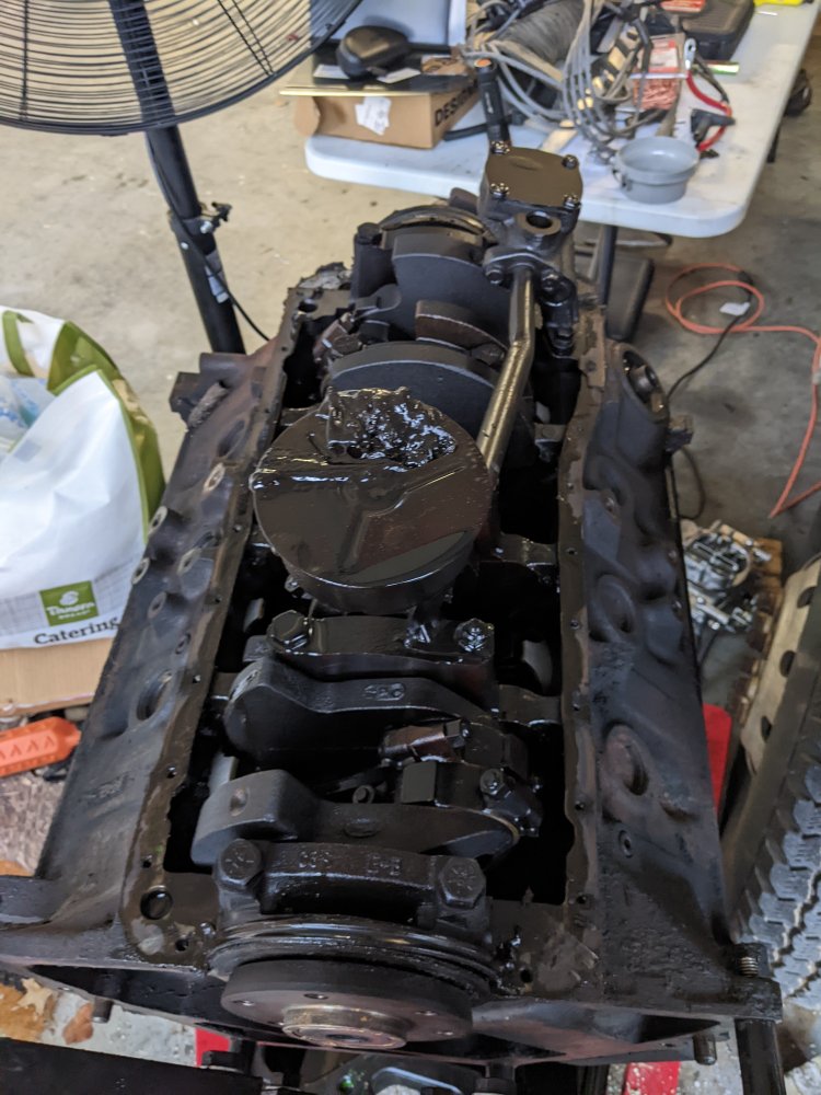

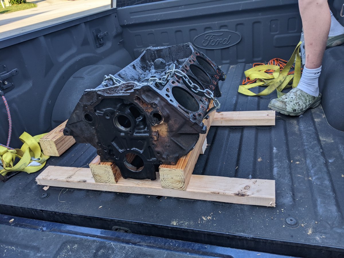

Off to the machine shop in the morning. Made me up a pallet with some scrap wood I had lying around. Turned out pretty good if I say so. Couldn't think of another way to transport other than a old tire which I don't have.

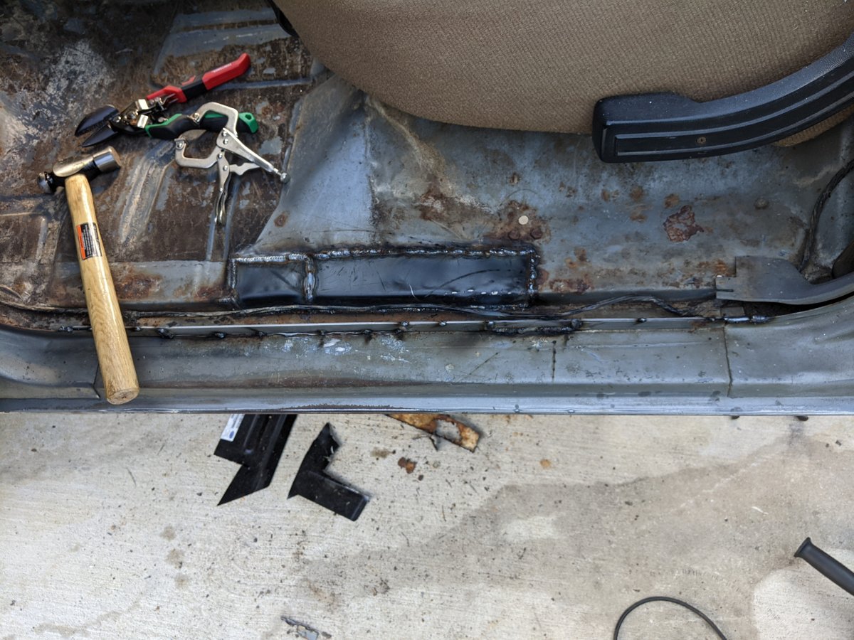

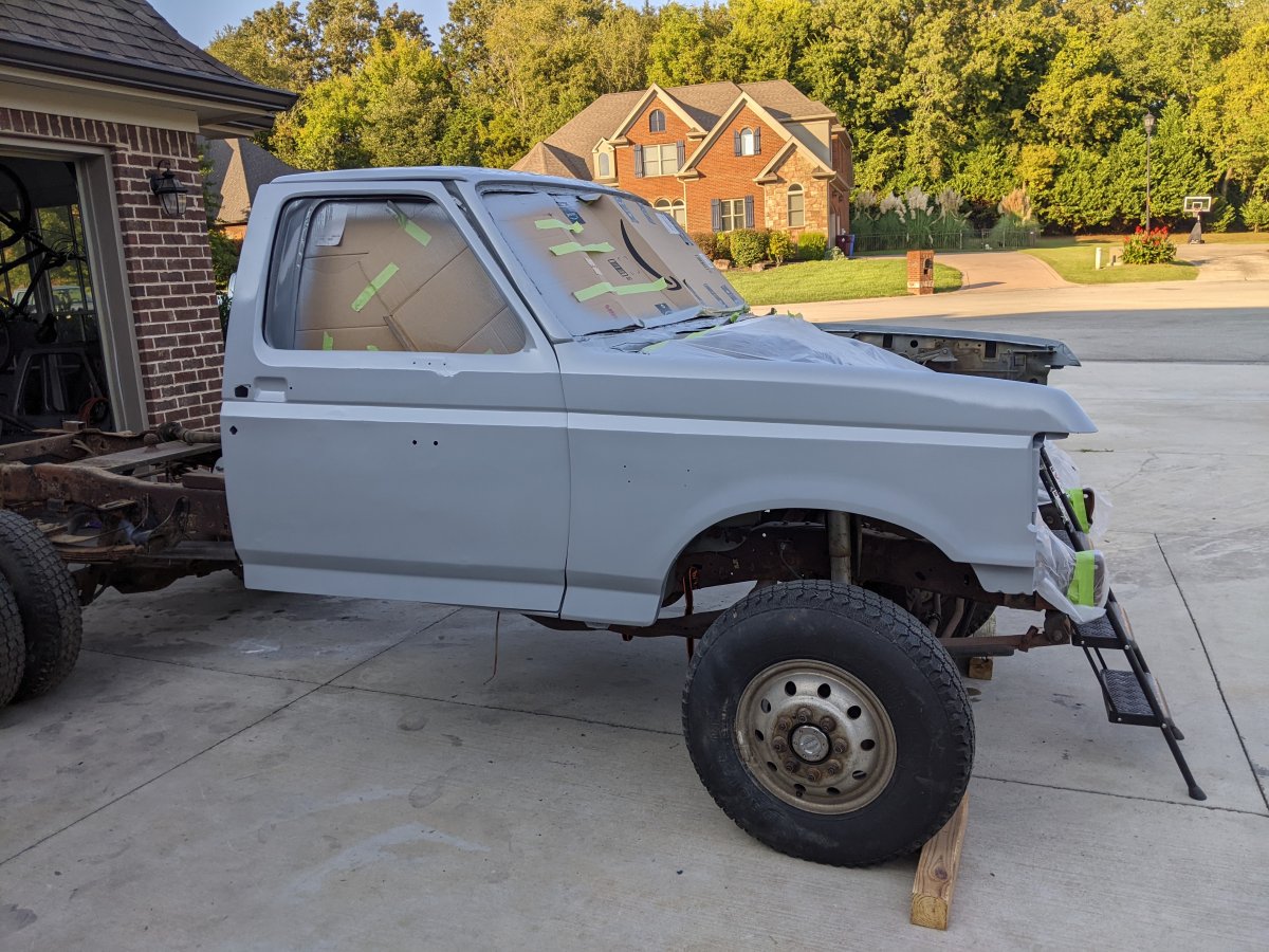

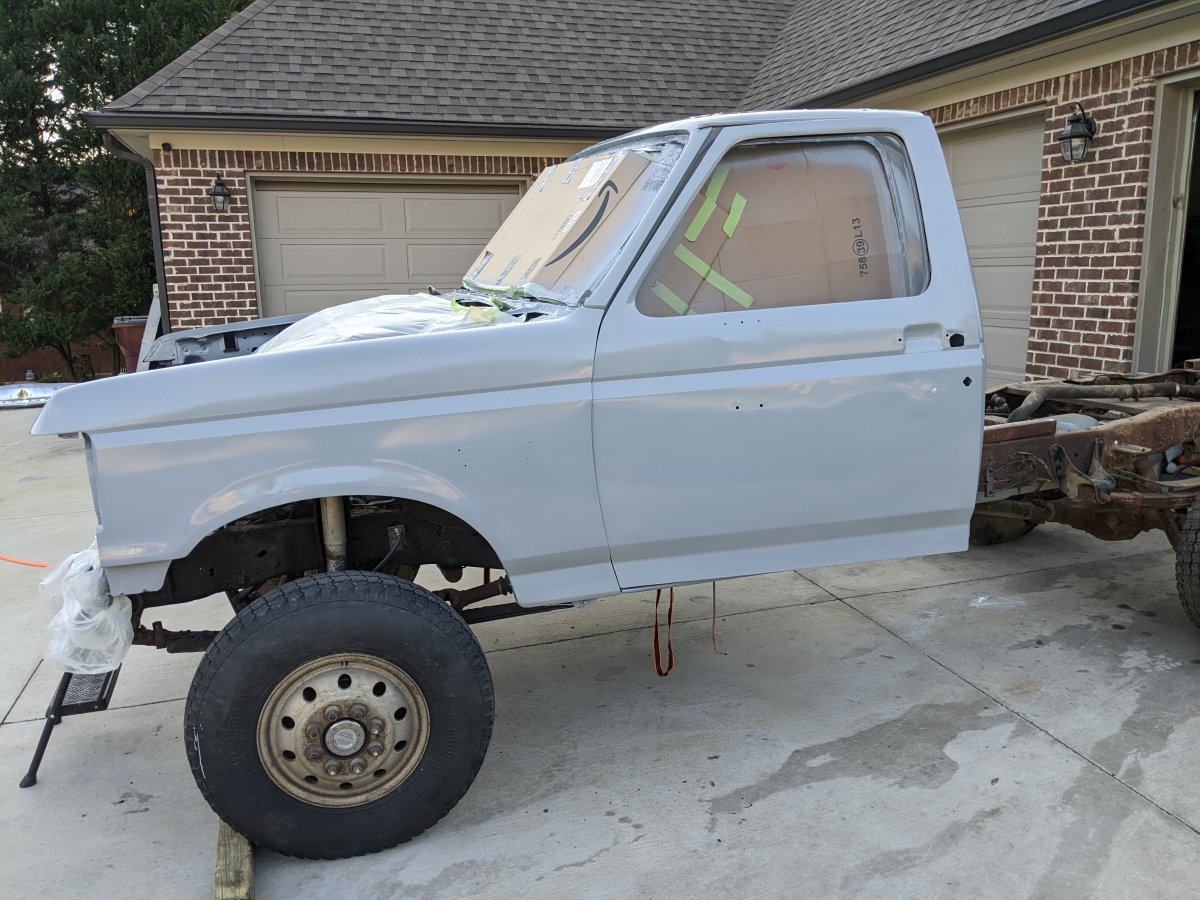

Was able to sand down all the old paint and surface rust and get the truck in epoxy this weekend.
I also patched up a few places in the floor on the driver's side. Just trying to pick away at it as I go waiting on my engine block to get done.
Definitely needs some body work. I'm going to try a few new things on this project. Hoping I can learn a little more about body work in the process.

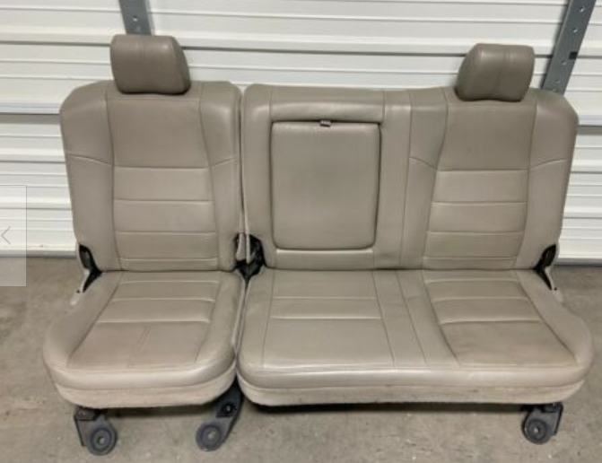

I did do something today I hope works out well. I kept seeing the OBS guys online swap in rear seats from later model crew cabs instead of the factory bench seats.
So, I did some looking at our local junk yard who has an online system and found an 02 F250 Lariat with Gray Leather seats. I purchased the rear split bench with arm rest and cup holders built in. I'll have to do some fab work or welding for brackets, but I think I can make that work.
It will look very similar to this one, but in Grey. I think it will work out well.
