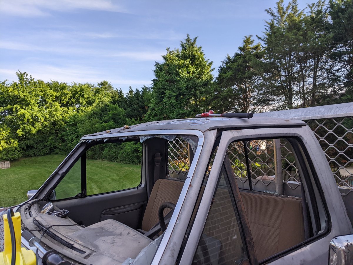

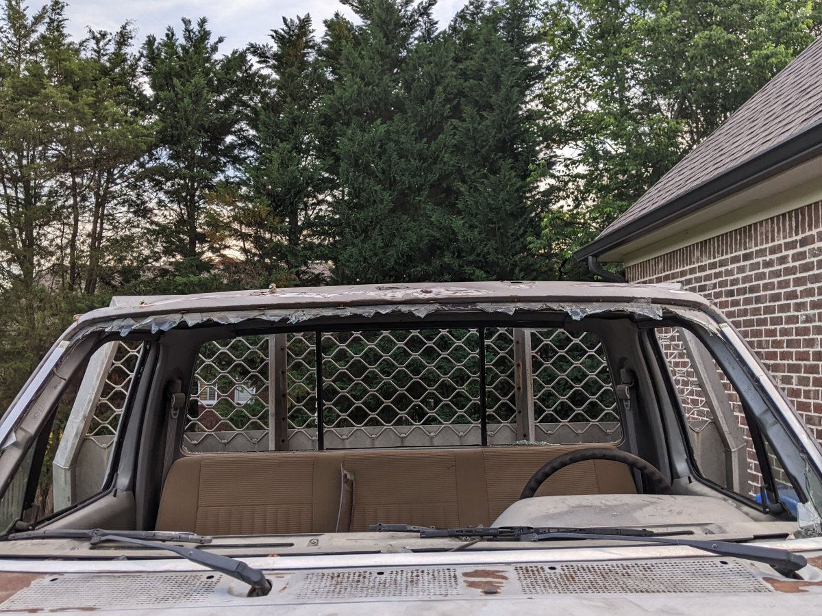

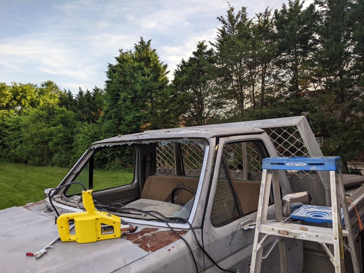

I'll be starting body work soon.

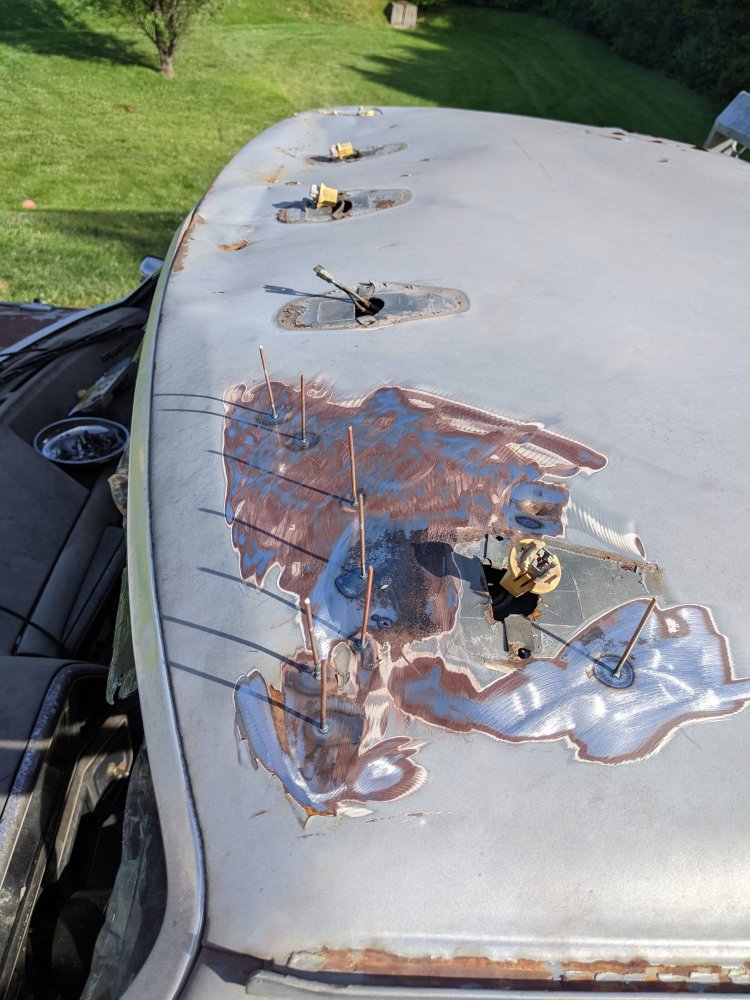

Decided to start tackling the dents in the roof from the dumb kids.
They did a number, but luckily I have my stud welder from the Bronco project.
Started on the driver's side and started working my way to the passenger. The metal is coming back into shape for the most part. It won't be perfect, but clearance lights will help hide some of it...

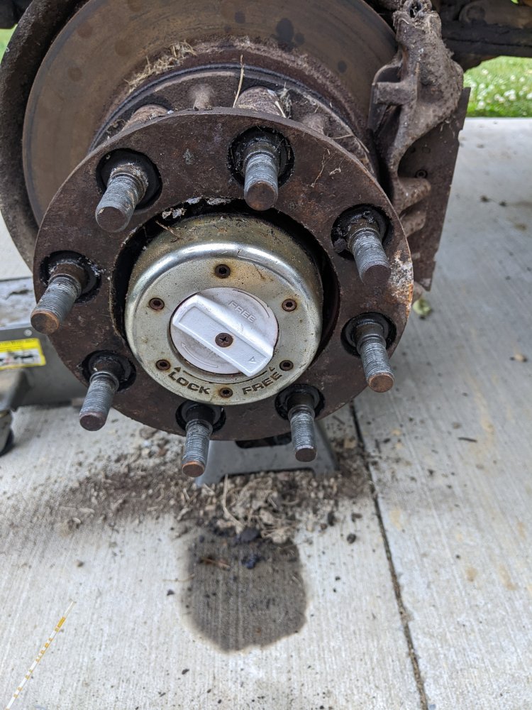

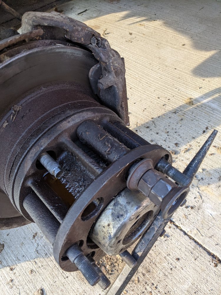

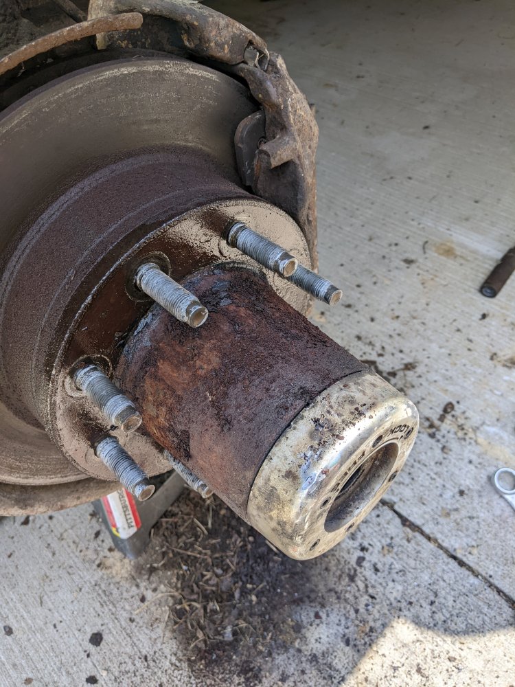

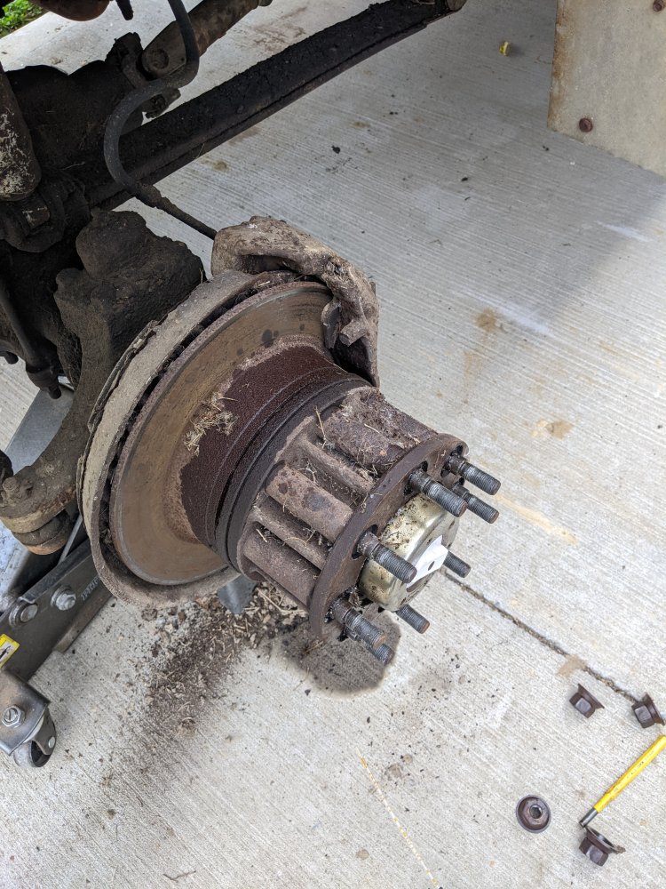

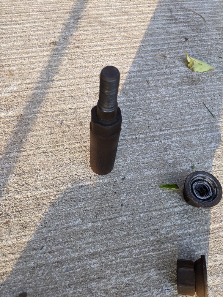

Looks like this rig does have a kit on it to make it a dually.
Anyone seen wheel spacers like this before?
I believe the cylinders are nuts that you have to remove through the hole in the spacer. Trouble is I don't have a socket that will fit them at this point.....
I've ordered a thin wall socket, hopefully that will help.
If that doesn't work I might use a couple of the lugs as jam nuts to try and get one loose.
This thing needs wheel bearings and brakes something awful.

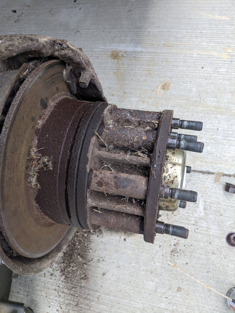

I was told, and maybe this is just rumor, but supposedly there were no 4x4 trucks built specifically as dual wheel vehicles. They all had those adapters up through '97, even if they rolled off the assembly line like that. I believe there may be some truth to that because I have seen a few 4x4 dually trucks from the those years and then all looked like that.
Could be the difference was only in the rear end for dually vs single rear wheel then.
Any tips for getting that beast off? Lol
I'm thinking I might try to use the lugs as jam nuts together that will let me loosen the stud.
I'm doing all the brakes, wheel bearings and upgrading the manual hub lockers while I'm in there.

Do you remember any wheel spacers like that on 4x4 dual wheeled trucks?

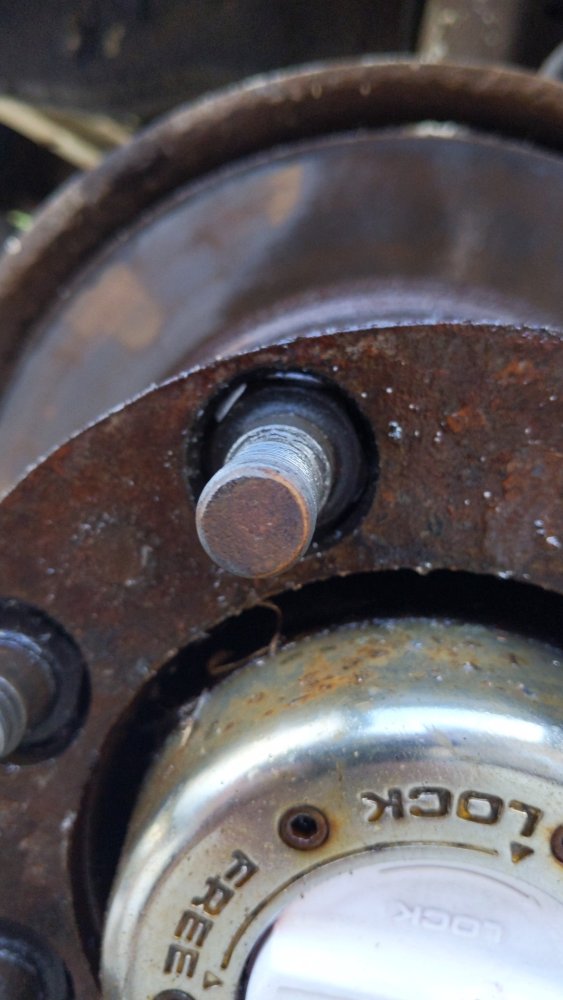

Turned to facebook for some answers.... Looks like folks take 2 lug nuts and make a jam nut to remove the the extended wheel stud which was one of my original thoughts.
Also discovered this is a Dana 60 King Pin axle, seems to be pretty desirable.
Ought to be tough for sure.

Not on factory dual wheel trucks, I've seen some aftermarket add-on dual wheel set ups with spacers. I prefer wheels that fit the vehicle.
A lot of google-fu later and your rumor is basically true.
The Dana 60 is the same front axle between a single rear wheel and dual rear wheel 4x4 truck from the hubs inward (at least for the king pin from 87-92ish). They use the same bearings, rotors, and brake setup.
The only difference is the way Ford adapter it for the uses of a dually tire wheel.

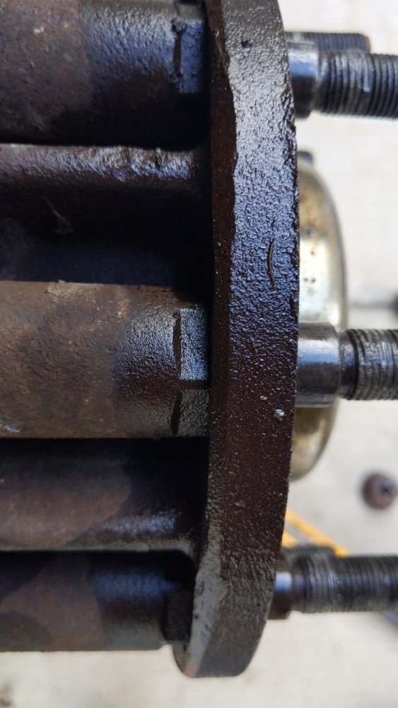

I got my spacer off with a jam nut technique that I am not a fan off at all. If the threads fail on the lug stud (which one did on the driver side) you are basically screwed. I had to weld a lug nut to the stud to be able to remove it. (I had been wanting a MIG welder and knew I would need one on this project so I picked up one at Harbor Freight yesterday --> https://www.harborfreight.com/weldi...essional-welder-with-120240v-input-64805.html and did flux core to get me through).

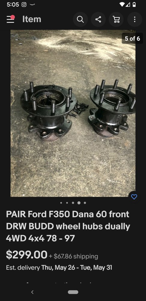

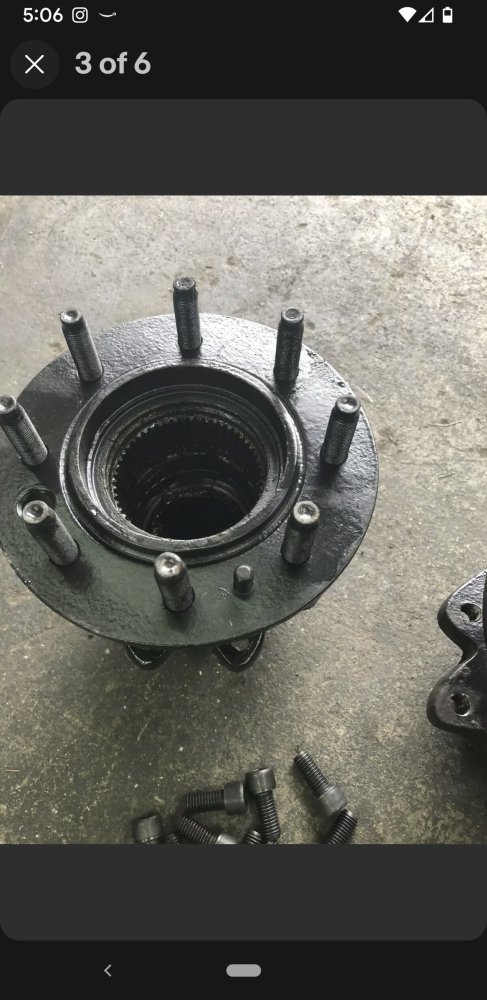

So to Ebay I went and found OEM set of hubs, sort of pricey, but they are serviceable and basically last the lifetime of the truck and you don't have to use a jam nut to remove them....
These are getting rare and not many junkyards have anything like that around me, so I bought them.
Also, I can sell my single rear wheel hubs as they are sought after to by the 4x4 wheeling guys, so not too bad of an upgrade, and I can recoup some cost.
