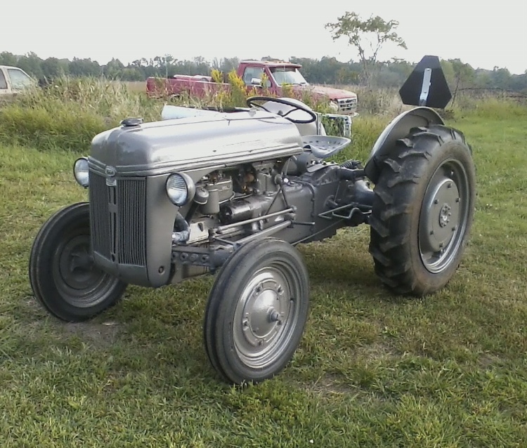

It took weeks to wear off my hands, I coated my rear frame 5 years ago and its still holding up great. I even used por 15 on a rusty ‘46 2N ford tractor before.

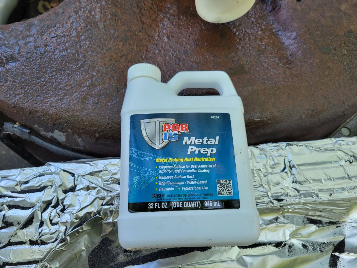

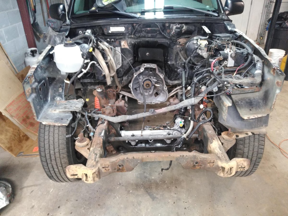

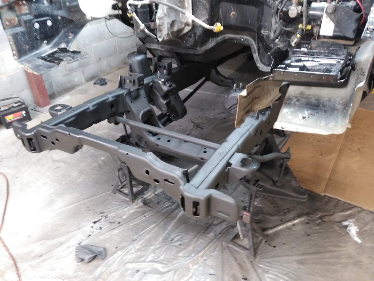

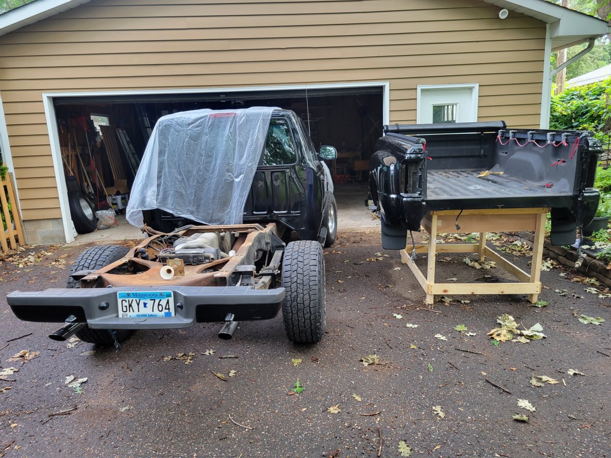

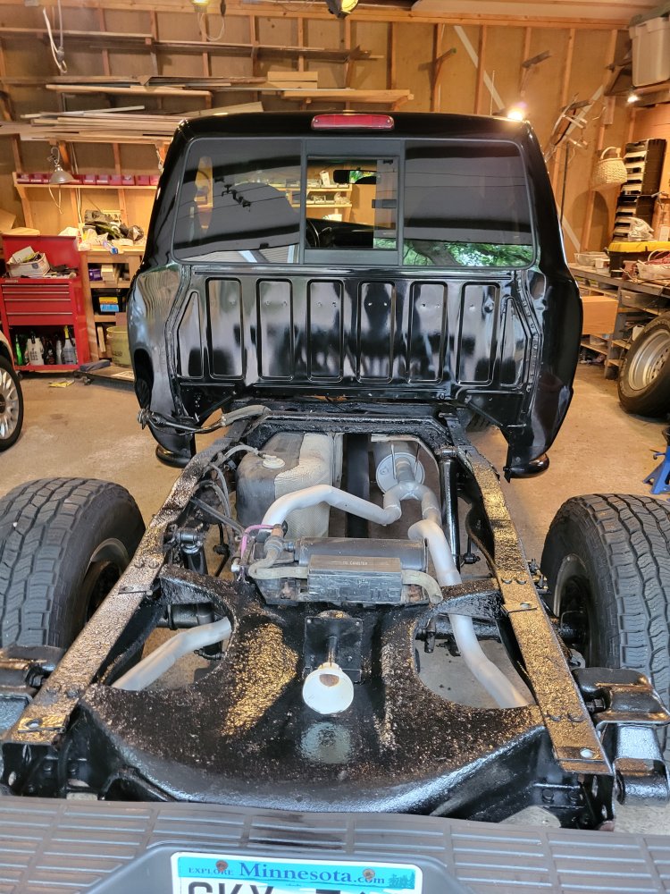

I removed the bed and media blasted the loose rust off the exposed frame. POR 15 does recommend a surface prep. i used.that too. I crawled under the front end to paint the rest. the guys are right about wearing gloves. POR 15 sets up fast. It is better to purchase the product in small cans (1/2 pint) as opposed to larger quart size. I'm pretty sure it will also last a long time. Here's some of the fotos.

I wrote about POR 15 earlier this year.
I agree, they sell a six pack of small cans that cost more than a big can but it's a better deal unless you're going to use the whole big can in a day or two. You need a stick of dynamite to get the lid off a can that has been opened before. I didn't use their surface prep and it worked fine, I highly recommend their thinner for cleaning up after use- nothing else cuts it.

I've used POR 15 and Eastwood encapsulator. Paint eventually bubbled up with Eastwood on my beetle. I have used POR on many restorations and have not had rust come back through. Use marine clean and the metal prep. I apply the topcoat just before the POR15 completely dries, just when you leave a glove print, but it doesn't transfer to the glove. Way less work than having to sand every nook and cranny.
