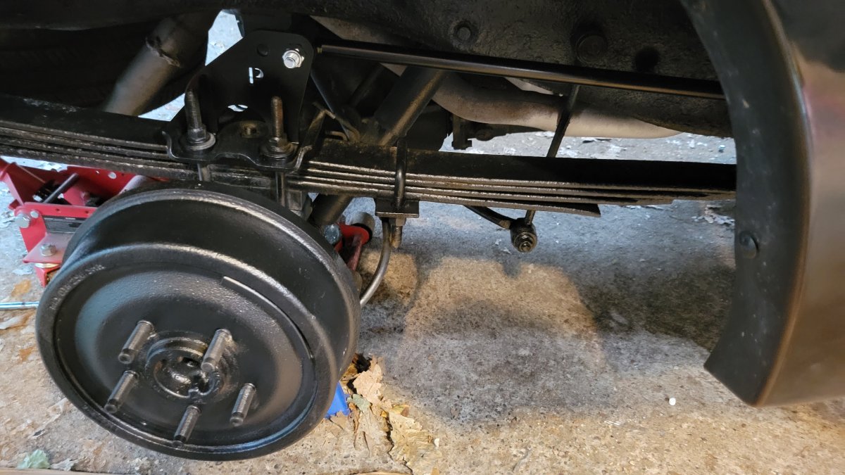

I had repainted the frame last year with POR 15. It's good stuff but not really as good as some would think. Like so many other evaporative paints, it needs a sealer. I chose krylon. It worked pretty good.
Krylon Urethane sprayed over POR 15 lasts longer.

The underside of my Ranger once looked as bad as everyone else's. I went ahead and fixed it anyway: the same dirty job everybody does, removed the bed, sandblasted the rough stuff off, applied 2 coats of POR 15, then sealed it all with a top coat and Krylon urethane. The diff cover looked as bad as the rest. Painting the underside is pretty much a thankless job nobody notices, except the guys at the oil change store.
But that's not the point. The bottom side is preserved and protected, good for another 20 years.
