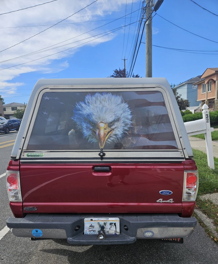

Spray Painting and Clear Coating my new Tailgate.
The finished product.
The original dealer badge , The original Ford badge. And I added the 4x4 badge. They did an awesome job painting it for just $200.
The New Tailgate was $118, New Plexiglass $103 and New Year Window Eagle Decal $38.
Sweet! Well worth $200.00. Body and fender, paint and finish are just as important as mechanical repairs. They help the truck to hold its value.

Turns out a friend at the body shop near me is going to spray the tailgate for $200. A no brainer. Let the pros do it. Thanks everyone for your input.

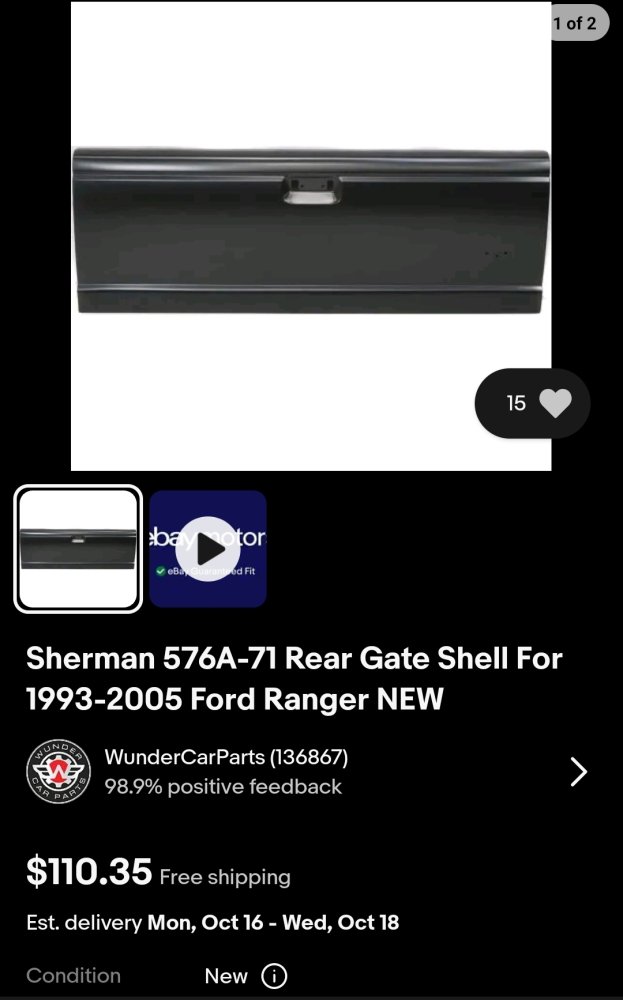

I purchased the tailgate brand new on eBay for $118 total w tax, it didn't need any work to it other than painting, and it was already primed, if that helps. PS I had to put my old hardware on it also.
A good deal on a tailgate!
