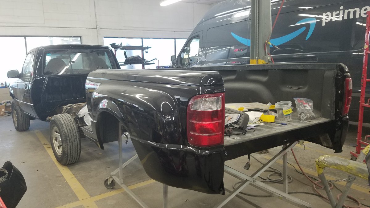

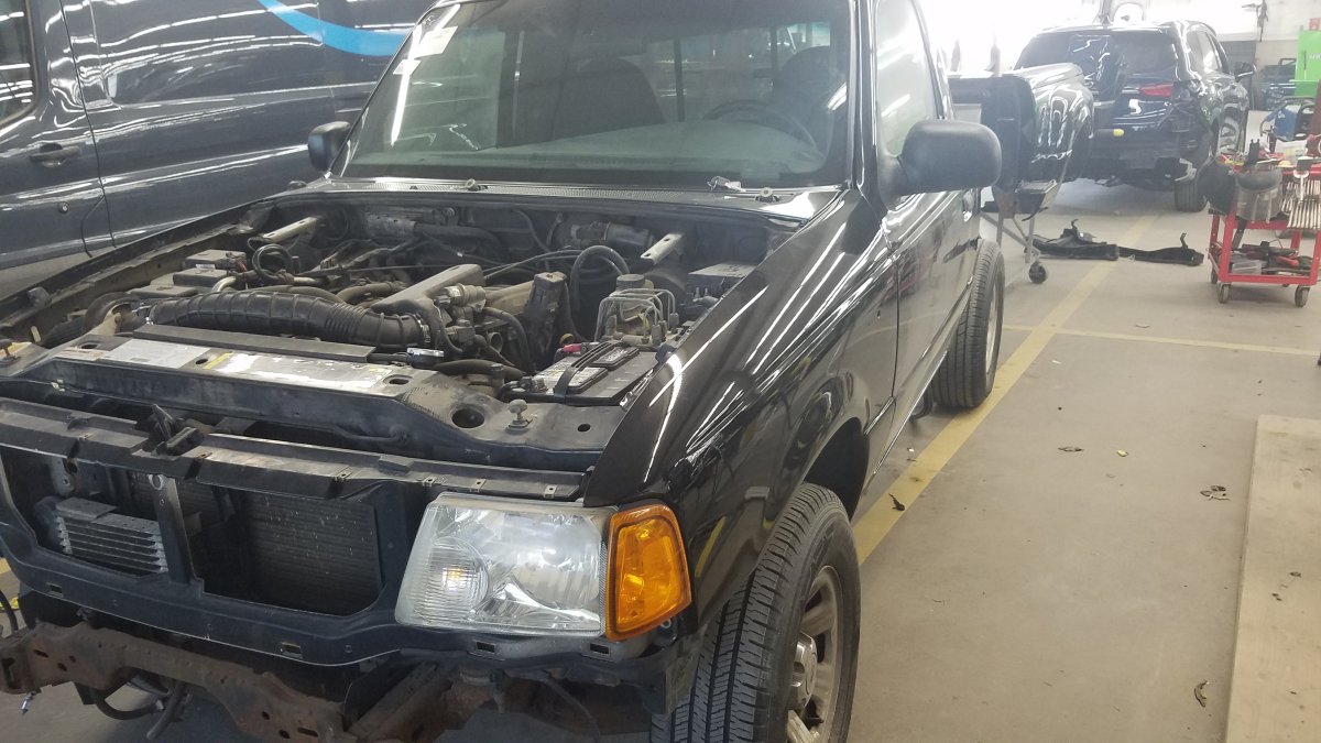

We took most everything apart: hood, front grill, doors, cab, bed, tailgate, even removed the windshield and the rear window. We removed the badges and the lights, even the rubber moldings. It took longer that way, but it was well worth the effort. I repainted the frame and bottom sides too.
Not that anyone else cares, but I'm driving brand new. People think the most expensive part of a truck is the engine or transmission. in most cases,it's not. It's the paint and body work. Good luck, buddy. Post some pictures please.

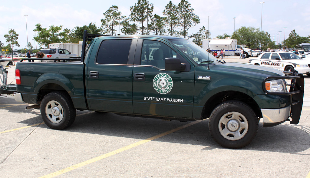

I have always like Game Warden Green

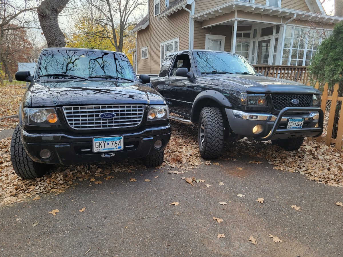

The Ranger in the foreground was painted in a body and fender shop. All the dents were pulled out and the rusty parts were replaced. I painted the frame with POR 15. The Ranger in the background was restored with Rustoleum and a clear coat. the rustiest bits were replaced with junkyard parts. The frame will be repainted next summer.

The one in the back is the one that you fixed after the garage fire, right?
Here's another more recent photo of the fire survivor, the XLT on the right, with a bull bar, nerf style rails, fender flares, blackout lights, 17" wheels, and crazy big Falken tires. All four doors came from the Upull yard along with a tail gate. The front grill had melted so the grill from the smaller Ranger grill replaced it.
Rustoleum rattle can spray paint works pretty good. It's not a perfect match, but no one has noticed. It doesn't lay down as good as 2 part catalysed paint coming out of a gun. It required a lot of "aftercare," namely fine sanding, buffing and a couple clear coats too. Rustoleum won't last as long either, but it's easy to touch up. The XLT has come a very long way since the insurance company wanted to total it out, but it still has far to go.
Next summer the tub comes off. The frame gets painted, and it gets new rocker panels: the real ugly stuff nobody ever wants to do.
