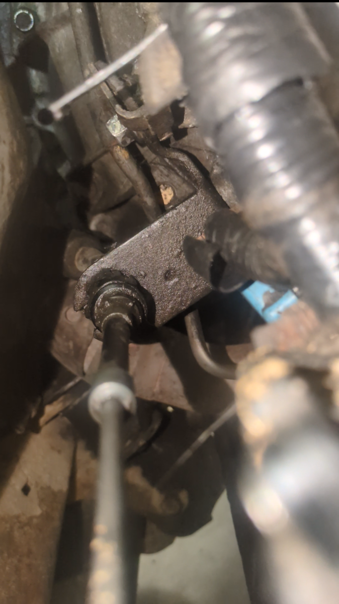

Hey yo! Got a 1998 Mazda b4000 4x4 automatic with a problem. It shifts hard especially 1st to 2nd. The code scanner says "P1900 output shaft speed (OSS) sensor intermittent fault." I looked near the back of the transmission on the driver side near the transfer case and the sensor is not there, nor the hole for the sensor to go into. There is a plug from the wiring harness that is where it's supposed to be. I read some stuff that says they don't have that sensor anymore after a year which I can't find again and the new sensor that does the same job is now the sensor on the back differential. So I changed that sensor on the back differential out and it did nothing. So now I don't know what to do. Don't know if this transmission is the original in the truck either if they put the wrong transmission in here. I wanna know how to fix it and if this transmission for this year should have that sensor in the transmission or not.

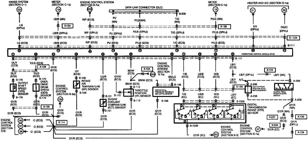

According to the diagram, you should have two speed sensors. What color are the wires on the loose plug? Do they match the ones in the diagram below. Look at the lower left area of the diagram.

The colors look like gray/red and the other wire looks like blue/yellow on the plug. I do see where it is on the diagram with the gray/red wire and I guess the blue/yellow is DL/Y. Not sure what DL stands for. Since its not connected to a sensor does that mean it should have a sensor attached to it? Or does this year not need that sensor?
i see DL as dark blue with fords alot.
dark blue with yellow stripe is the signal wire....the gray/red is the common, should be a twisted pair.

I am going to guess the driveline was replaced at sometime and you lost the spot for that sensor. I was wondering if you could rig it? What would happen you to paralleled these two sensor wires with the other sensor that you have? I would assume this is how they monitored if the transmission is slipping, comparing the final drive sensor output to the overdrive drum sensor in the trans.
So the GY/R wire of that plug that would go into the OSS spliced into the GY/R wire that goes into ODS. The DL/Y of the OSS spliced into the Y/LG(I'm guessing that's yellow/light green). Looks like they got dotted lines on that wiring diagram you sent doing the exact same thing of connecting those sensors. What do those dotted lines mean?
Looks like the dotted lines associate that wire with the connector spelled out in the rectangle box. So in the diagram, both sensor wires run through connector x128. You can see at the top of the diagram, there are lots of dotted lines. Looks like they are grouping the wires together, showing what connector they go through with all the rectangle boxes with x connector numbers. Mazda diagrams are a little different, even though they are showing Ford wiring.

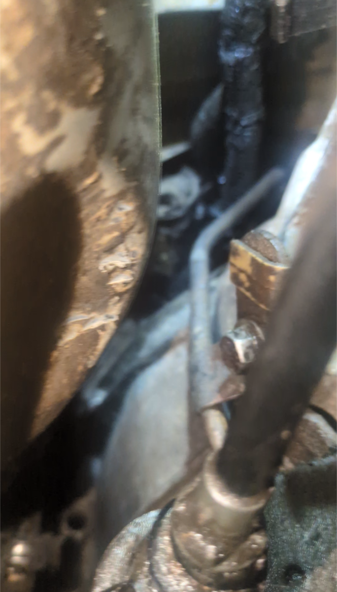

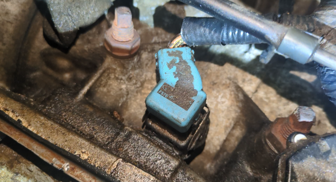

I don't see the ODS. Near the bell housing. That's the best angles I can get.

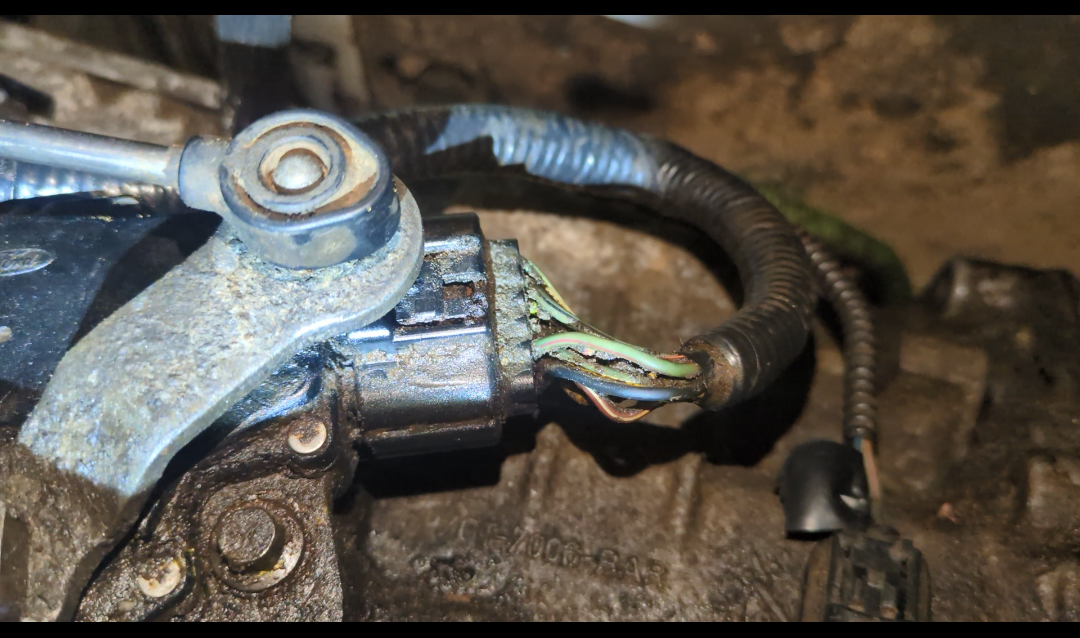

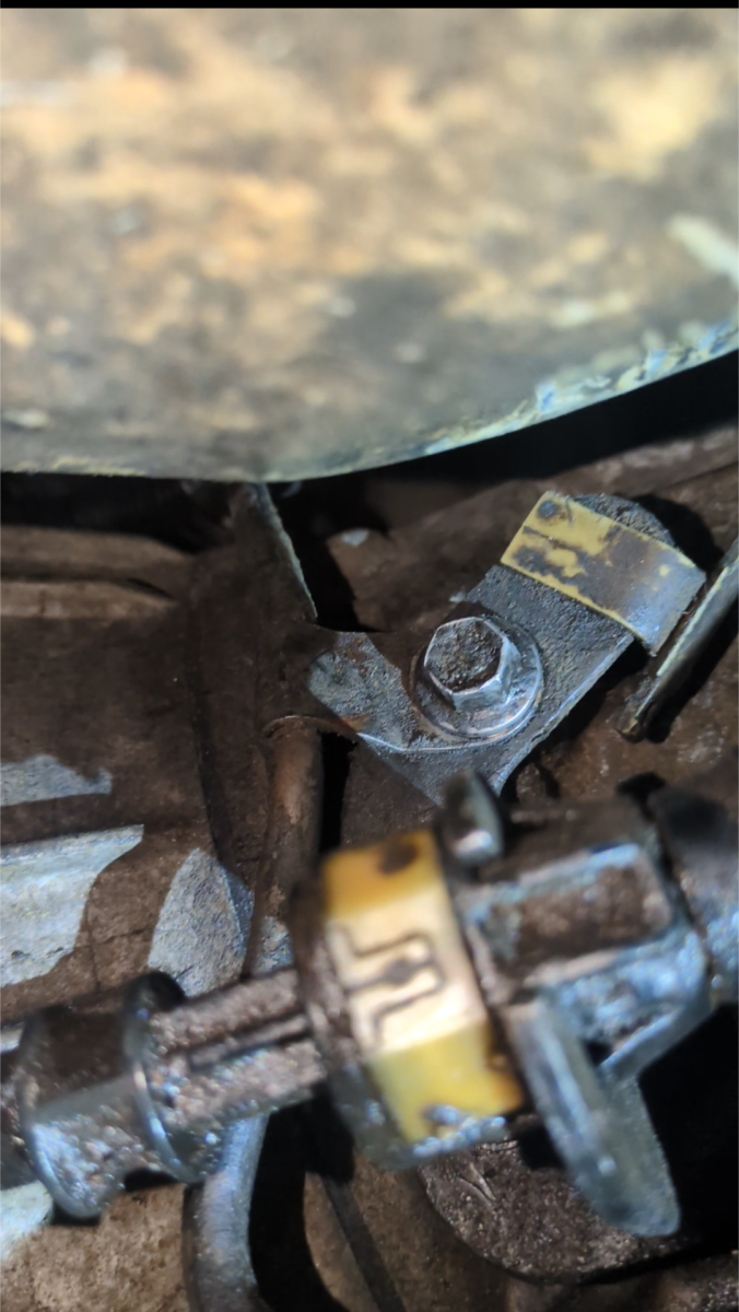

Is the ODS internal. Would it be in one of these connectors

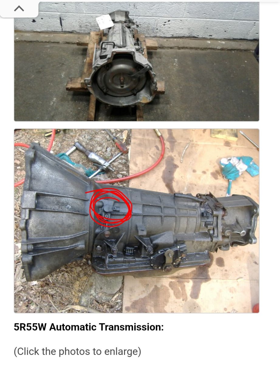

I did a nationwide search for a auto transmission for a 1998 mazda B4000. No interchanges came up, only listed 1998 mazda and rangers as a direct fit. I did another search, 1999 thru 2000 are grouped together. 2001 thru 2005 are grouped together. All of them are the 5 speed autos.
