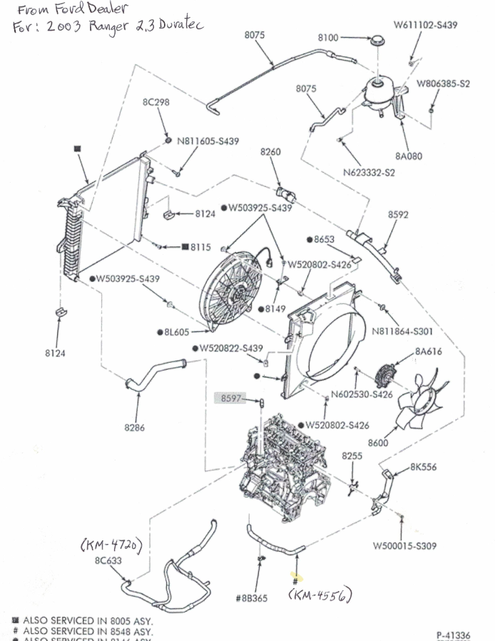

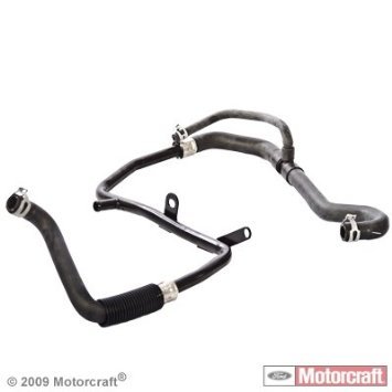

Parts Needed: Coolant Recovery Tank Hose (Motorcraft KM-4720) and companion bypass hose, KM-4556. It's also suggested to replace the KH-56 hose and the heater vacuum bypass valve the KH-56 connects to.

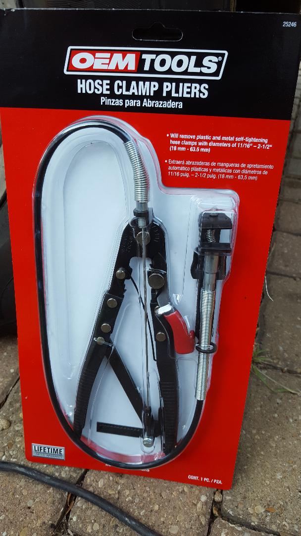

4. It is recommended to use (buy, borrow, or rent) a specialty long-reach clamp removal/installation tool. In my case, I bought a $40.00 “OEM Tools” brand cable operated hose clamp pliers at Autozone. You may get by without one if you can successfully use spring hose clamps that will stay “locked open” before reinstallation. On the new KM-4720 I bought, it came with glued on spring clamps in the open position on the three hose ends. This allowed easier installation, but it was a challenge to use a screwdriver to snap closed the clamp on the small hose branch end that connects behind the motor and above the tranny.

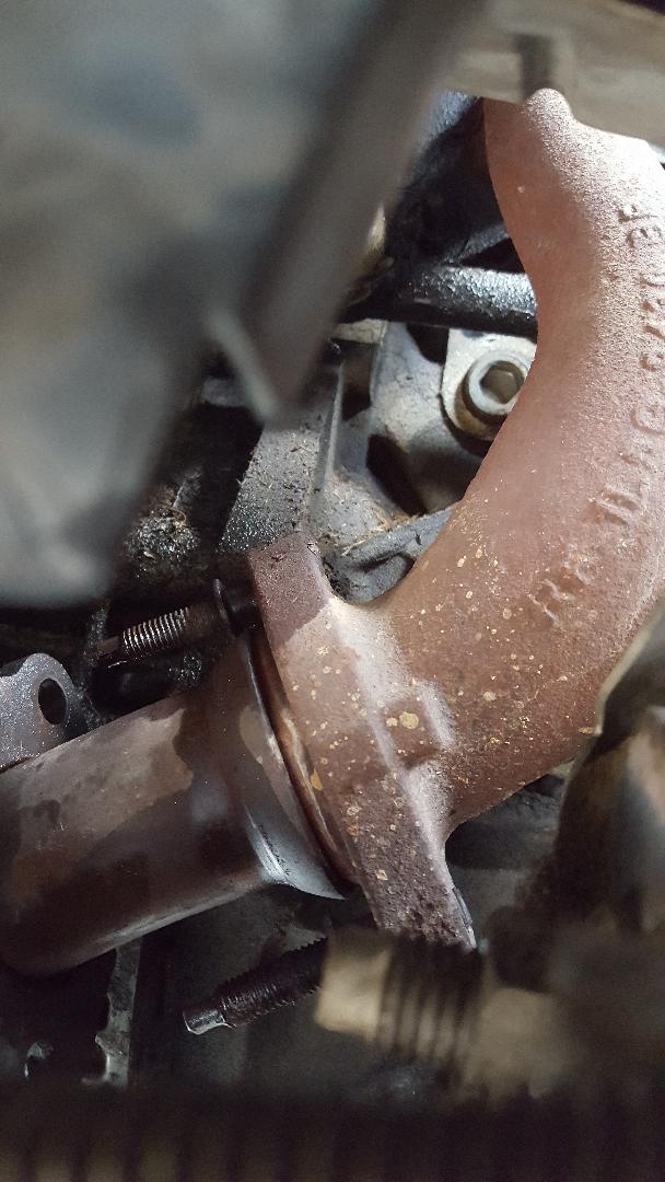

5. Like JMarlowe, I removed the middle exhaust section which connects with two 15mm nuts to the exhaust manifold, and two 15mm spring bolts to the back exhaust section (The two oxygen or CO sensors will also need to be removed unless you can separate them from their electrical connectors).
6. I unfastened the upper and middle bolts holding the dipstick tube, which is essential for access, but I wasn’t able to pull it out of the block, so I just worked around it.
7. Remove the two 15mm nuts on the exhaust manifold studs that are holding the metal pipe section of the KM-4720.

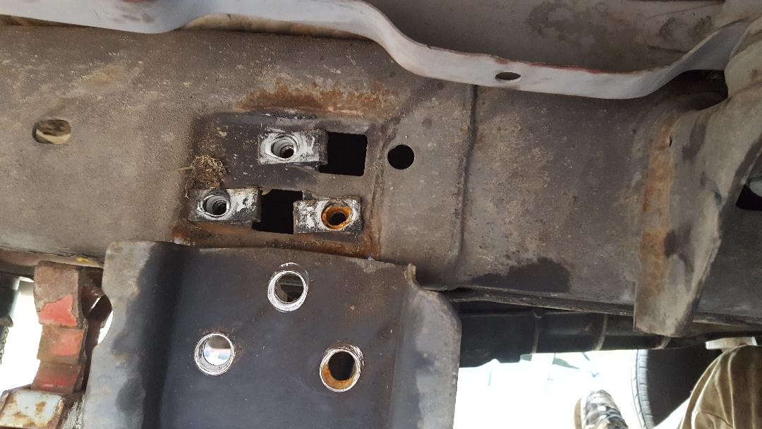

8. Using a reliable jack under the tranny , remove the three 13mm bolts on each side of the tranny crossmember to enable lowering the tranny and crossmember by about 4 inches. At about 4 inches, the engine rests against the firewall and won’t drop any more. You will probably need this clearance for any hope of removing and reattaching hose clamps on the two hose connections at the back of the motor (one for each of the hose units).
9. After all hose connections are unfastened, you can eventually wiggle the KM-4720 out and through an approximate 1 in. space between the bottom of the exhaust manifold and engine block. In my case, I removed the old and also inserted the new KM-4720 from the exhaust manifold side of the undercarriage. I had to sharply bend the rubber part of the hose and tee that goes to the driver side connections, to get it to squeeze over the top of the tranny when reinstalling.

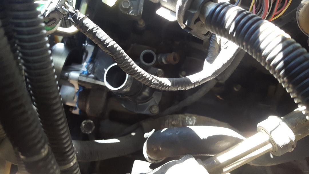

10. The KM-4556 is mostly positioned on the intake manifold side and should also be removed and installed from that side. NOTE: It will be easier if you install the new KM-4556 once the old KM-4720 is removed and out of the way before the new replacement KM-4720 is installed. And if for some reason you decide to position the KM-4720 in first, definitely don’t bolt it back on the exhaust manifold before the new KM-4556 is attached and clamped in back—to give yourself needed working room.
11. The only way I was able to detach the old and attach new the small hose segment of the KM-4720 on the back metal nipple was to lay down with my head pointed towards the front of the truck and reach around the tranny “barrel hug” style and do most of the work by feel rather than sight. You will likely get a fair amount of fiberglass into your arms from the disintegrating old insulation material on the firewall.
12. With the KM-4556 you can get a partial visual of the back connection point by shining a light into the opening on the driver side wheel well opening. But for that one too I had to get under and wrap both my hands around the tranny to force the new hose on, even with the expanded clamp and tool attached. The tool did not compress the spring clamp into a fully open position, and was also fussy about releasing the clamp to allow it to close and allow remove the tool.

  • Outline for changing Coolant Tank Hose KM-4720, and KM-4556 - 2001 and newer 2.3 Dura
    2.3 duratec showing thermostat and KM-4556 hose connection point behind it.jpg

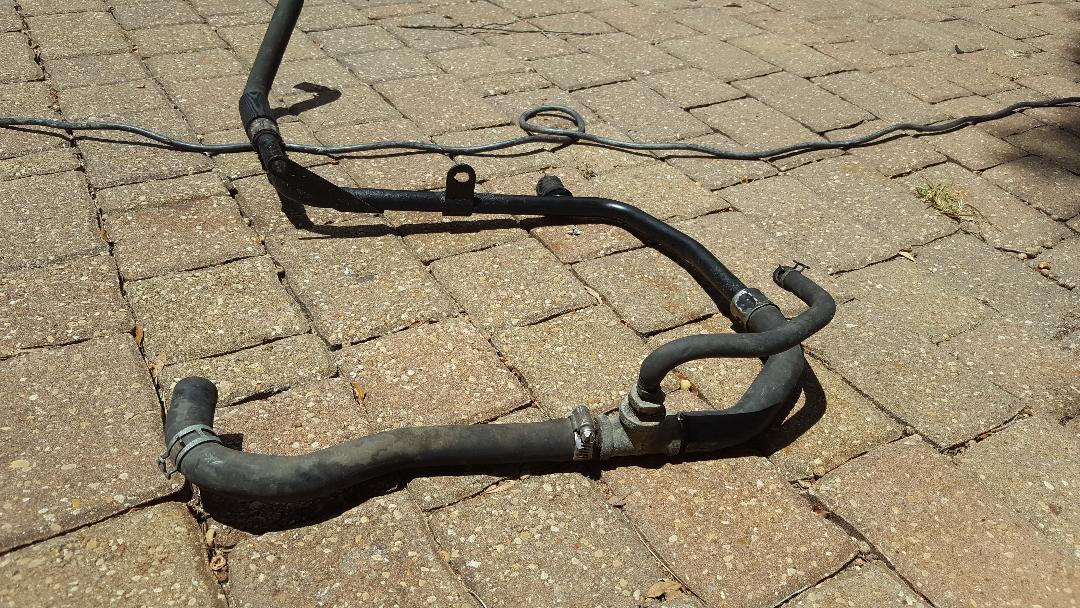

This is an amazing and detailed guide. I already have my trans out for a clutch replacement. I'll be getting this line replaced this weekend. I had attempted it already, but just managed to break the heater vacuum bypass valve while the line remained stubbornly stuck.
This needs to be easier to find considering this is the most common failure for 2.3 ford rangers and B2300s...
Also want to include that there is an alternative part made by dorman that replaces the plastic tee with aluminum. Part# is DORMAN 626-528
It's also cheaper and available on amazon with prime shipping, so I would reccomend that over the KM-4720
