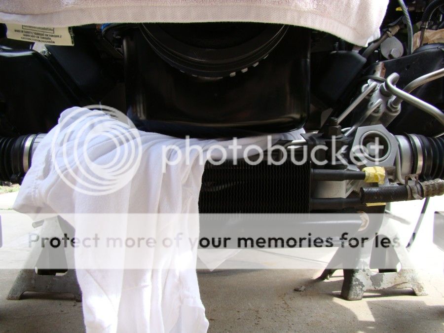

Now let’s take a quick look at oil pan clearance on the steering rack. Several other people have expressed problems in this area and I expect I will run into the same concern. It looks a little tight. Yep, the tee shirt is stuck in place.
So here is the plan, I am going to add a few washers as temporary spacers on both sides to raise the engine slightly. Once the desired clearance has been achieved the washers will be removed and permanent spacers will be cut to the exact thickness and welded directly to the engine plates.
With a little luck I will be able to slip a piece of card board completely under the oil pan between the steering rack.
With the correct combination of spacers on each side the engine sits level just like it belongs in the Ranger.

I dunno about your hood or firewall clearance, but the fit between the oil pan and steering rack looks a bit tight, even with the washers.
Kinda like a $10 bill will just slide in there, but a $20 won't fit.
