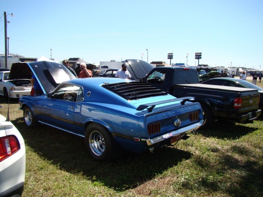

I started going to Fun Ford/NMRA Spring Break Shootout events in Bradenton Florida back in 1997 and have been going pretty much every year since then. I have never been much of the car show type but did enter my 1993 V8 Ranger about 15 years ago as well as painting my son’s 91 Mustang GT for him to enter back in 2009. He was lucky enough to receive an award and was very excited when that occurred.

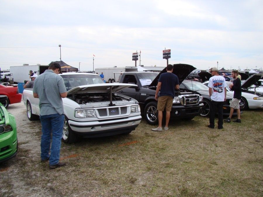

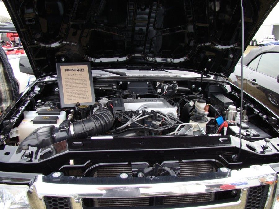

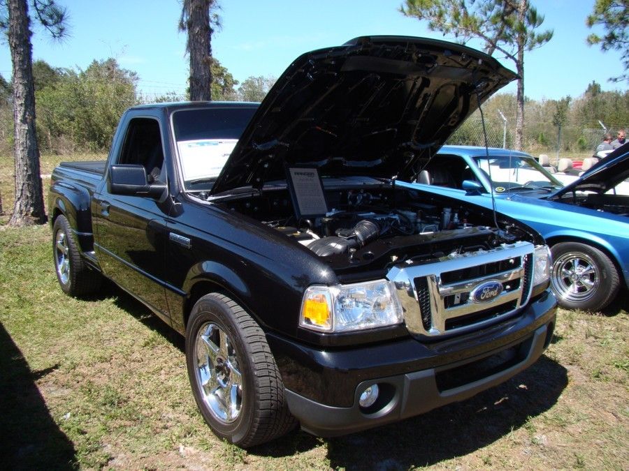

During the five years it took to assemble my current V8 Ranger I often thought about entering it in the NMRA event just to celebrate it being done more than anything else. Several weeks ago I managed to check that off my bucket list.

I even managed to follow in my son’s footsteps and receive a Special Recognition award on Saturday and a Class Event Winner award on Sunday.

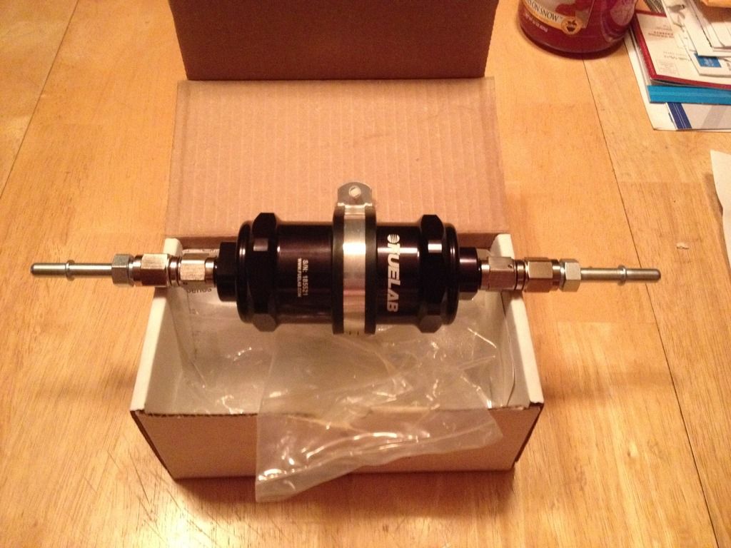

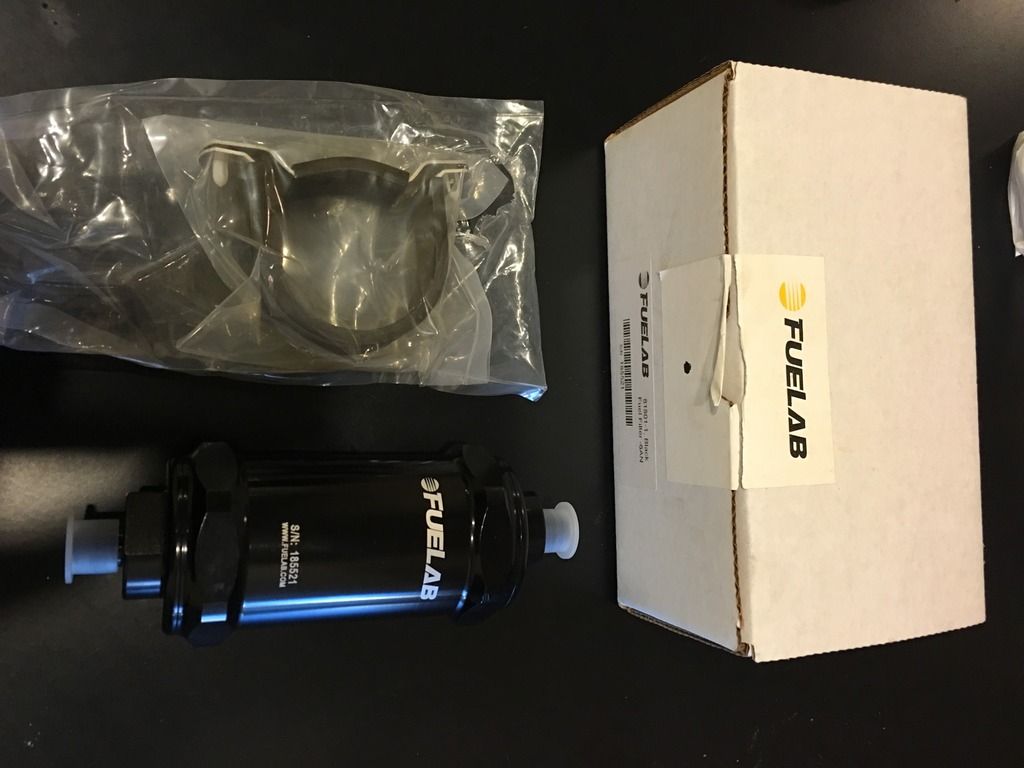

The next upgrade will be a Fuelab Fuel Filter to replace the OEM piece. I am sick and tired of the quick connect fittings on the stock unit. It seems like every time I try to pull one apart something causes an issue. Last time I had to rebuild one quick connect with all six of the internal pieces because they all came out attached to the filter. Some how they fused to the filter and that was the final straw for me. Once the new piece is installed it will be 6 AN swivel fittings and hopefully no more headaches.
