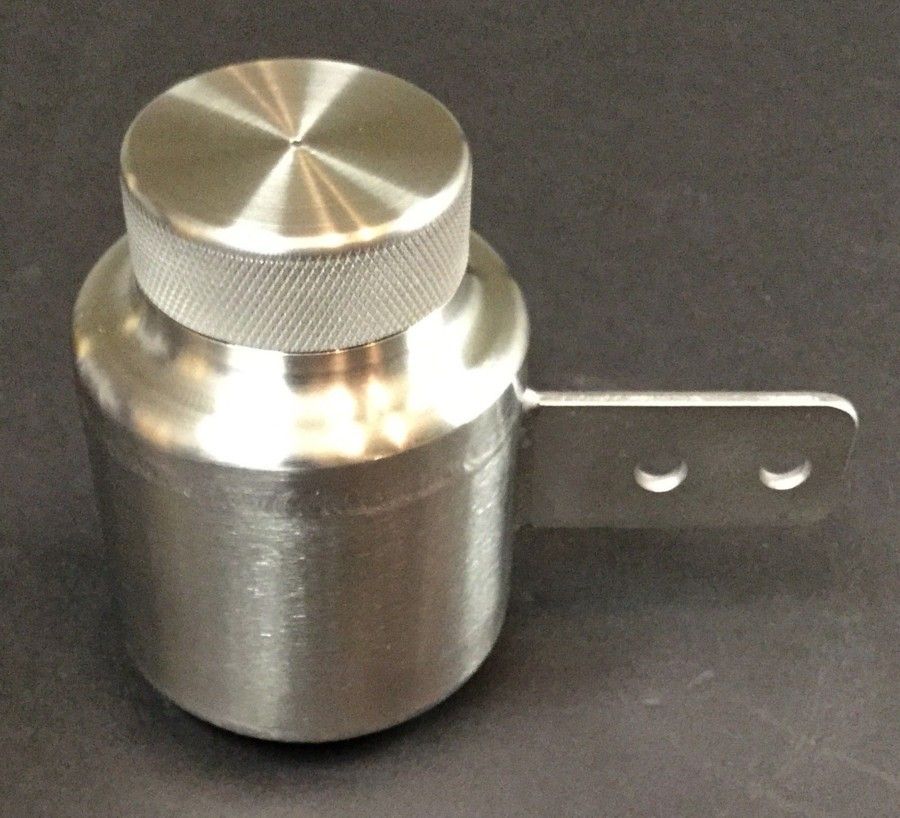

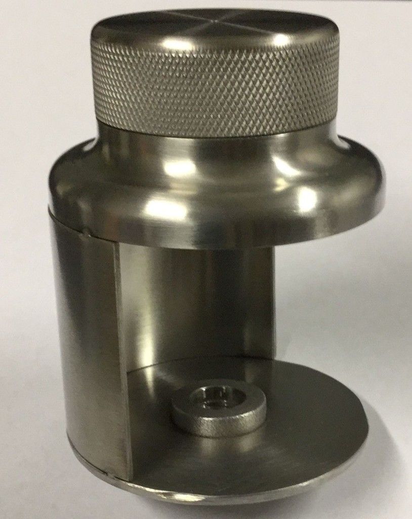

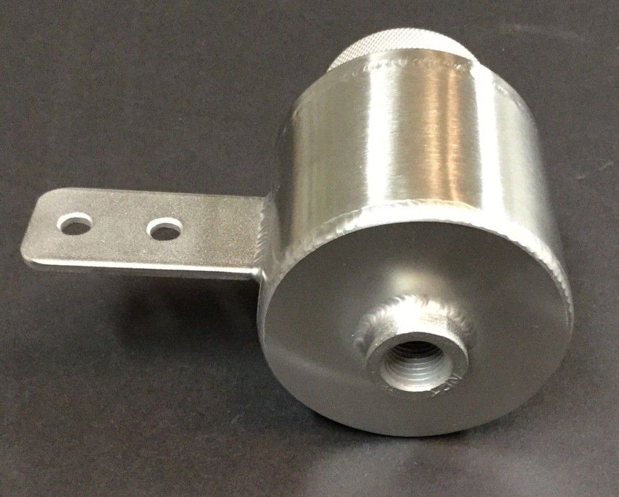

Because I have had to deal with this issue twice now I decided that I should first increase the amount of fluid in the system. This may not solve future issues but will give me a little more warning and wiggle room when first discovering the problem and also in getting home while dealing with the issue. My solution was to have a clutch fluid reservoir fabricated that would hold up to 8 oz. of Dot 3 fluid. The OE reservoir holds about three table spoons!
The one above is the 5oz. version. I had mine extended slightly to hold a full 8oz.

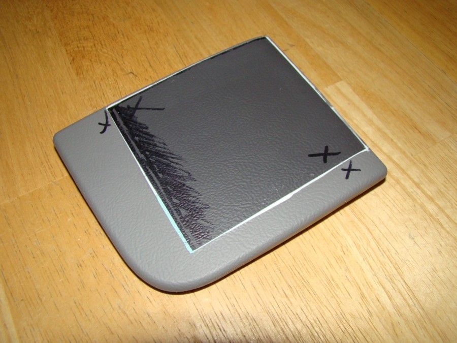

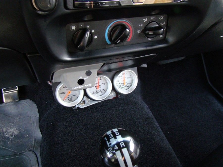

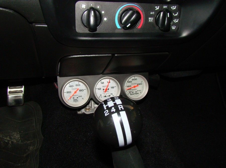

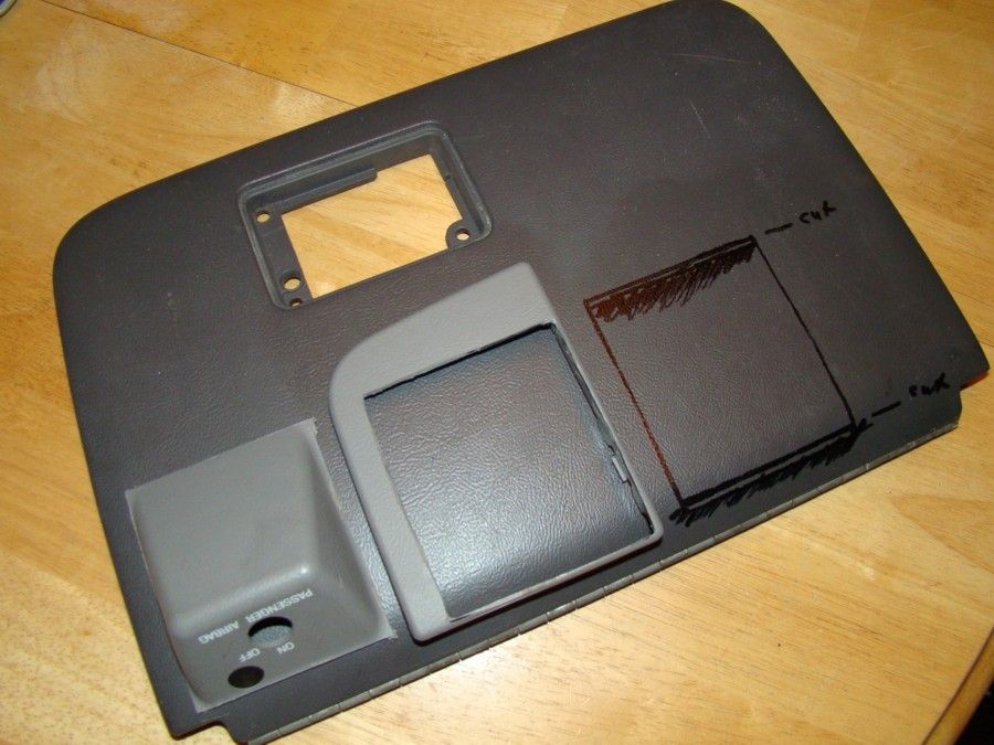

One of the projects I just finished is the modified Passenger side Air Bag switch cover. The cover stuck out in front of my gauge pod and created an obstruction right in the sight line of the oil pressure gauge.
I decided to cut the protruding section out of the removable switch cover and replace it with a flat panel.

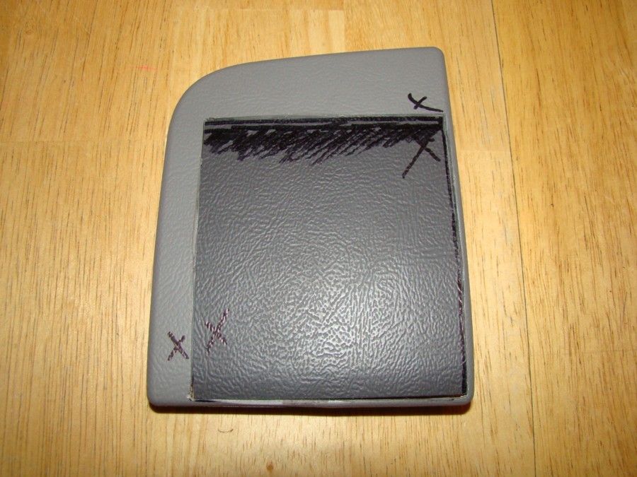

I picked up a used glove box door from a salvage Ranger. This panel had the same contour as the switch cover. After matching up the two pieces I outlined a section to cut as a replacement panel for the switch cover.
After a little work with the file the two pieces were fit together.
Then some adhesive and a little plastic filler was used to help conceal the seams.
I refrigerated some modeling clay that had been pressed on to the glove box door to “borrow” the texture of the panel. After being refrigerated for a short time the modeling clay was used as a “rubber stamp” in the fresh paint to help hide the seams a little more.
Once the paint had dried the new panel was snapped into place. Now the oil pressure gauge can be seen from the driver’s seated position and the hole in the dash is covered with an OE style trim panel.

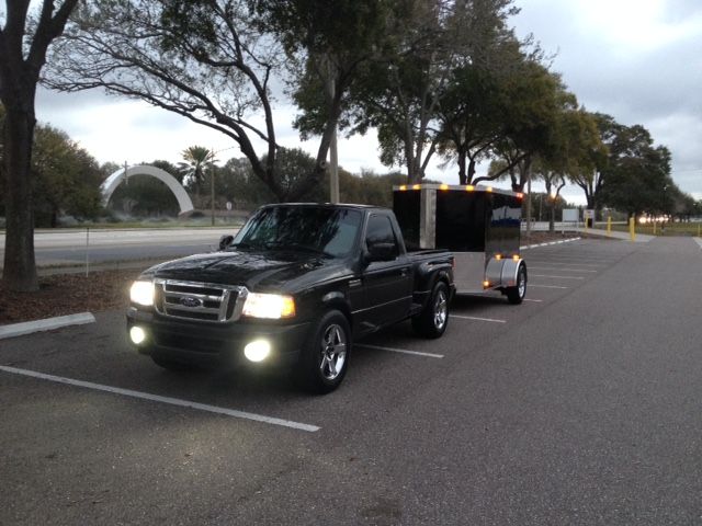

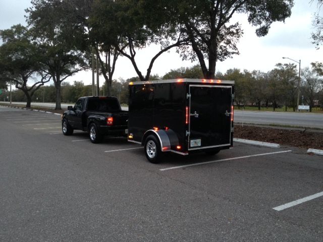

I also decided that the U-Haul trailer situation had to change. Although the U-Haul program worked very well for the past few years I really wanted a matching trailer for the truck and one that was more reliable over long distance.

Whats the trailer for?
