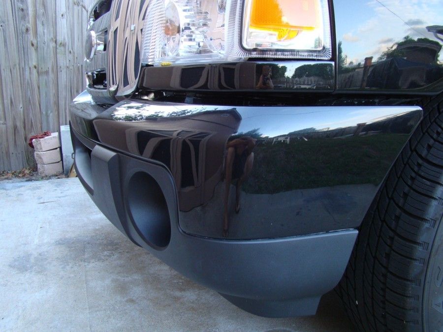

After spot checking a few panels with the 600 grit wet and a polishing wheel I went ahead and color sanded and polished the front bumper cover and header panel to completion. Then I attached the lower valance and installed the fog lights. Once that was complete I positioned the headlights in the header panel but could not finish attaching those as I am missing the mounting clips. A quick search on eBay fixed that issue. Until they come in I will have to get by with the “custom yellow masking tape fasteners.”

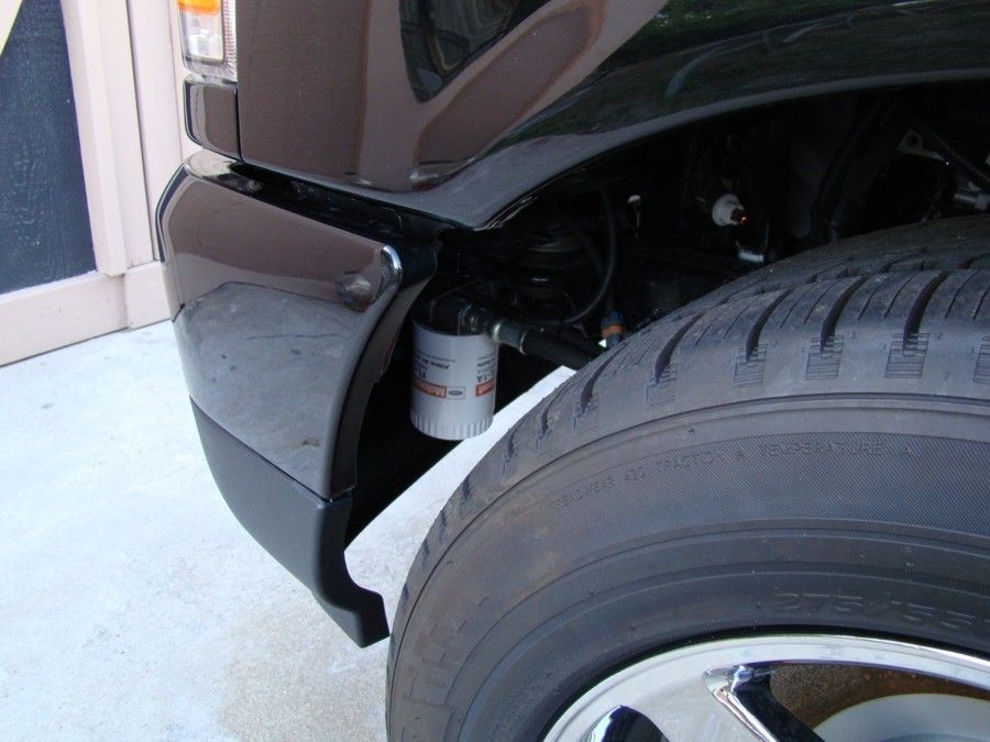

I was hoping the Motorcraft FL1A Oil Filter would be visible from the wheel opening and the front valance. I just thought it added a “non-stockish” look to the job.

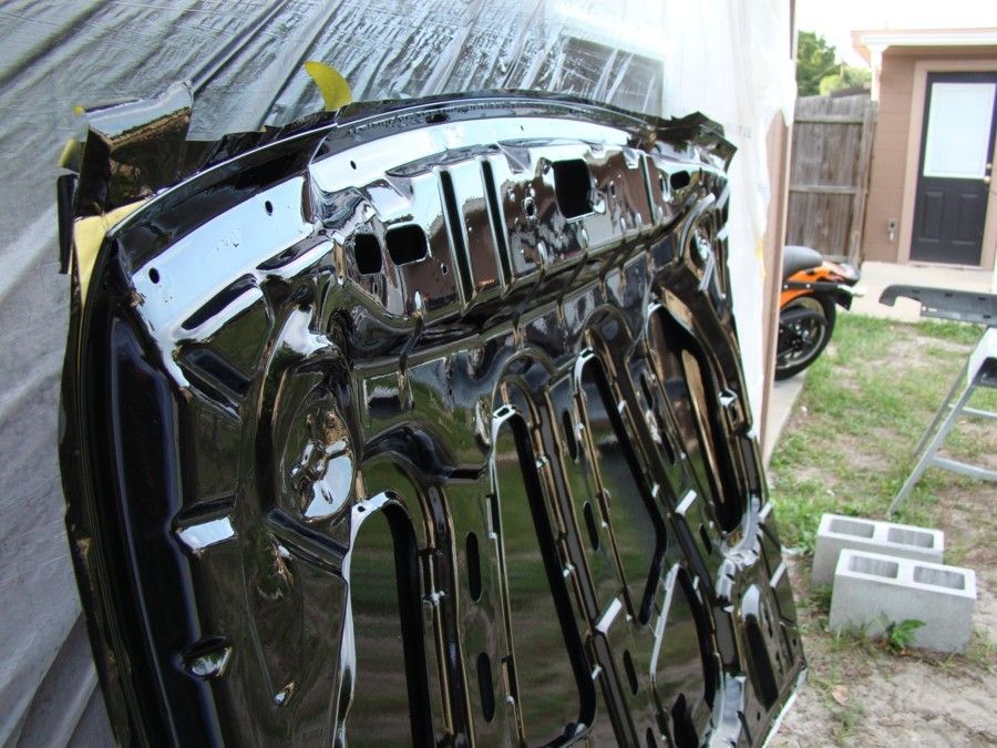

Because of the recent weather changes I have had to change direction a little bit. I wanted to spray the underside of the hood and tailgate before color sanding and polishing the outside surfaces. There was a short break in the high rain chances so I decided to take advantage and shoot the underside of both panels this afternoon. This was only after moving forward a few days ago with the color sanding process.
I wrapped the outside of both panels in Norton Plastic sheeting and roll taped the edges. Then placed both in position to spray the color and clear before night falls.

I will let them set up over night, then flip them right side up tomorrow afternoon and finish the polishing process. Once that is complete I will mount the hood and set the tailgate aside until the bed has been removed and painted. I can’t wait to see the truck with the hood polished and mounted. That is going to feel like a big step forward. It will complete the front of the truck as far as appearance goes.
That new Sata Jet throws it down nice but sure runs through the material quick. I have been playing with the air pressure, fan control, and distance to the panel to try and cut down on the consumption. I blew through 1.25 gallons of clear in the past 10 days. I admit I did put on 3 heavy coats and sprayed the inside and outside of several panels as well as 15 assorted pieces. It just seems like the material is going fast!

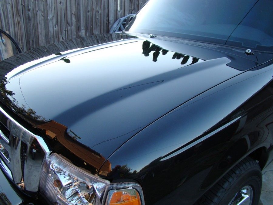

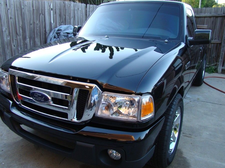

I finished the last step of polishing the hood today and went ahead and mounted it in place. Setting one of these heavier hoods in place alone is a very nerve racking job. Getting it in place isn’t the issue, getting it in place without bending or scratching something is the hard part. I had planned on pulling the front pieces and both fenders just to be safe but I got a little lazy at the last minute. I took my time and was very careful. Everything turned out fine, no scratches or dents.
It feels good to get the 1999 Red Hood off and the 2011 Black junk yard hood in place. I didn’t get a chance to take many decent photos today but will try to get a few full view photos tomorrow when the truck is out front. I plan to take a short test drive if all goes well. Here are a few of the close up shots I did get before the day ended.
