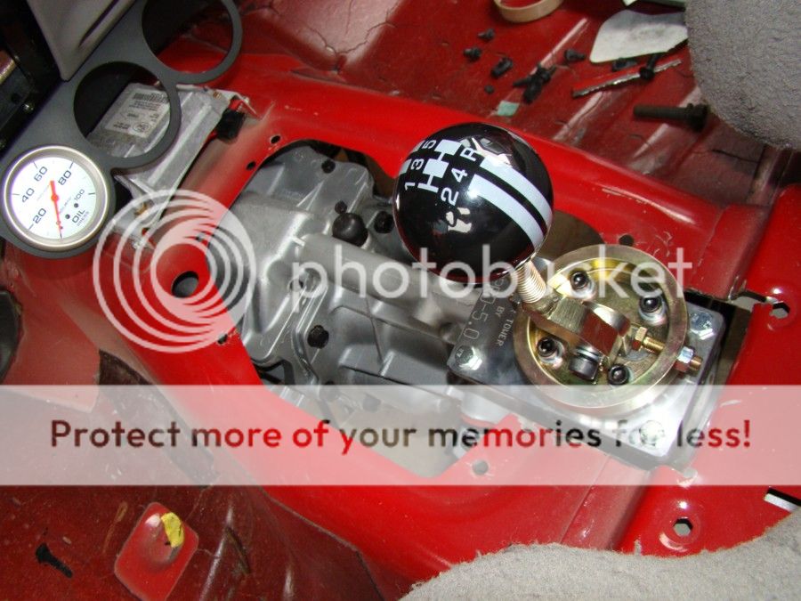

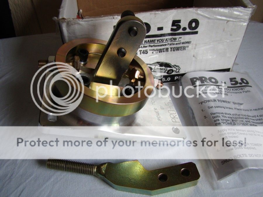

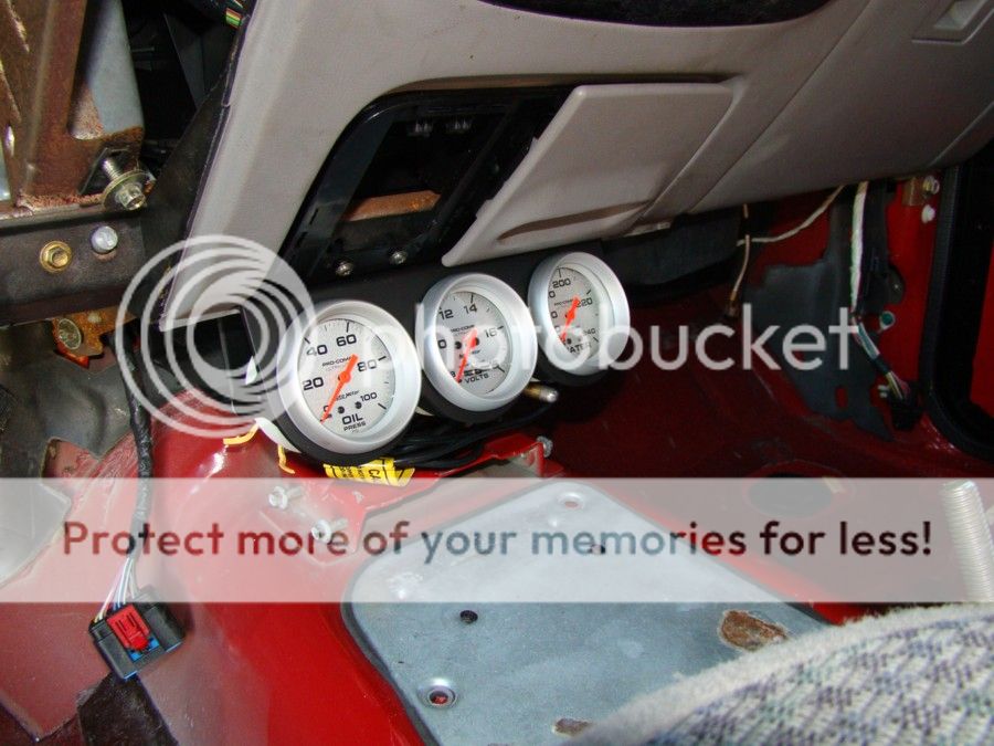

The new parts are still trickling in every few days. The PRO 5.0 shifter arrived along with the black and grey shift knob and the Autometer gauge pod. I also picked up a 2 5/8 inch Oil Pressure gauge from a local supplier to test fit the clearance against the Airbag module on the trans tunnel. It looks like this piece will need to be relocated in order to install the three Autometer gauges I would like to use.

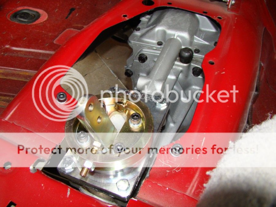

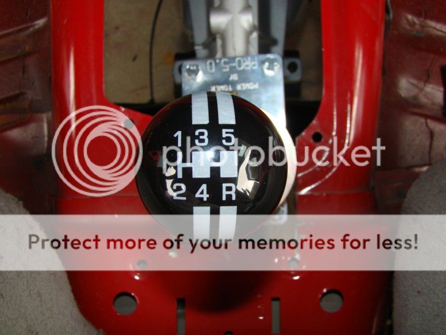

The PRO 5.0 shifter fit right into place and looked like it was made for the Ranger.
One more 2wd 98 coil spring 5.0 swap.
Now with the shift knob installed.

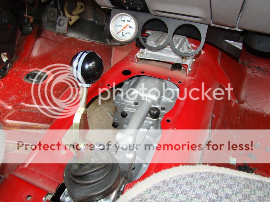

Chris Neighbors from Neighbors Industries, who did the front Cobra brakes for this truck, is designing and crafting me a shift lever that will bring the shift knob up and back into a comfortable position.

The rubber boot that came with the shifter that was on the World Class T5 fit the PRO 5.0 shifter well and was transferred over to help seal the new piece.

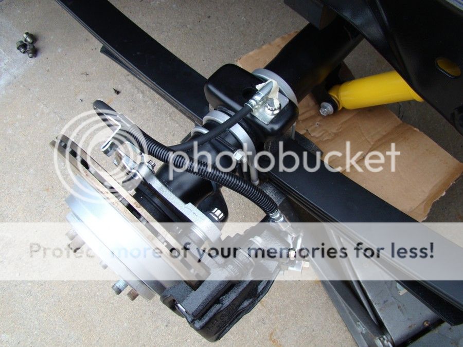

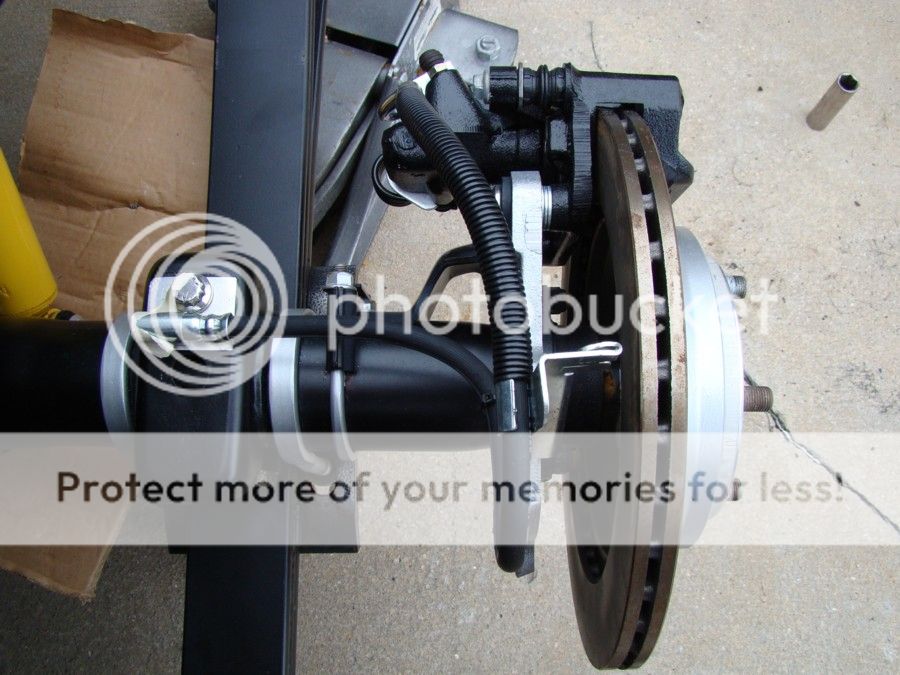

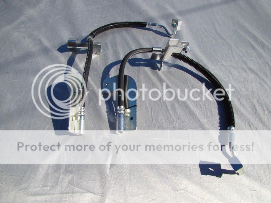

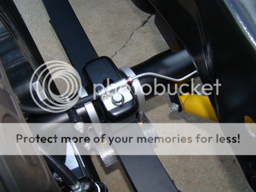

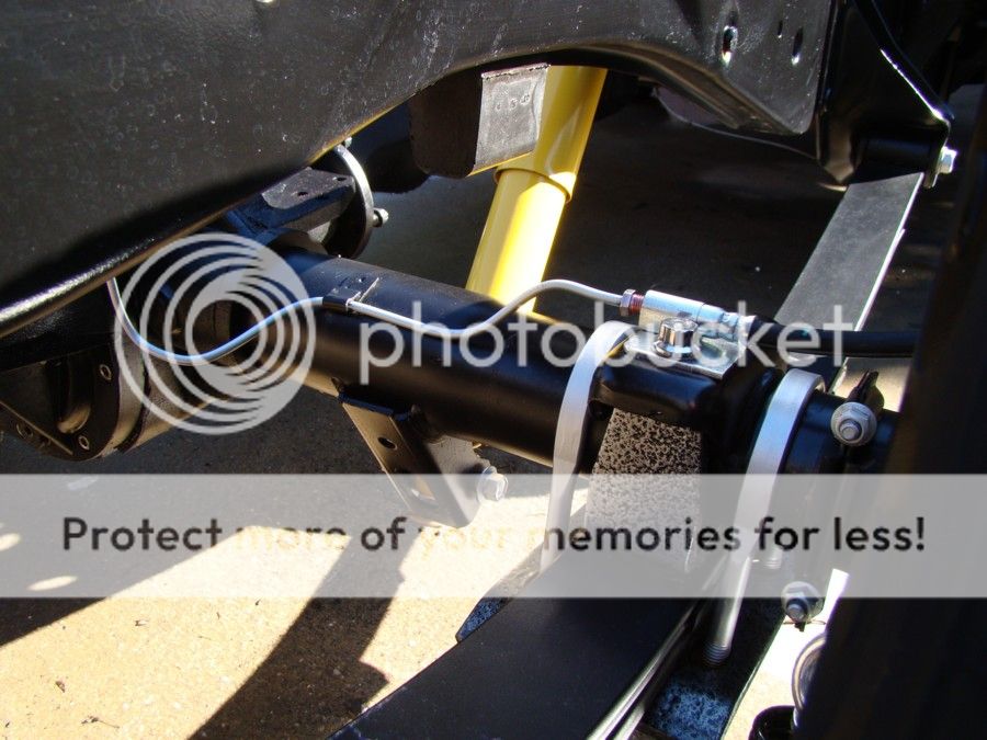

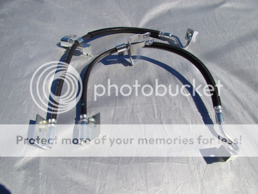

My son and I tackled the rear brake lines earlier this week. We started with the soft lines going to the rear Cobra calipers first. After a few trials and errors we decided on the lines for a 2003 Cobra fit the best. With a couple slight modifications to the large brackets the lines were ready to be installed.
I marked where the cuts would be made and knocked off the excess bracket material before drilling a mounting hole in the portion that remained.
The small in line bracket allowed the soft lines to be bolted to the caliper bracket like they were made to fit. The larger bracket was bolted directly to the spring pad on the flipped rear end housing. I know the ARP fastener is a little larger than needed for this application but I wanted to use the existing hole in the spring pad. I just tapped the hole as needed and run the fastener straight into the pad.

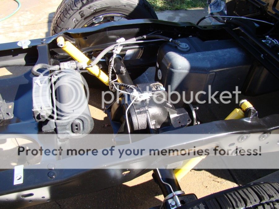

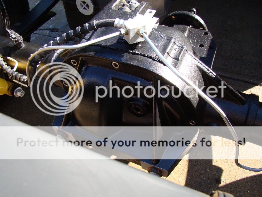

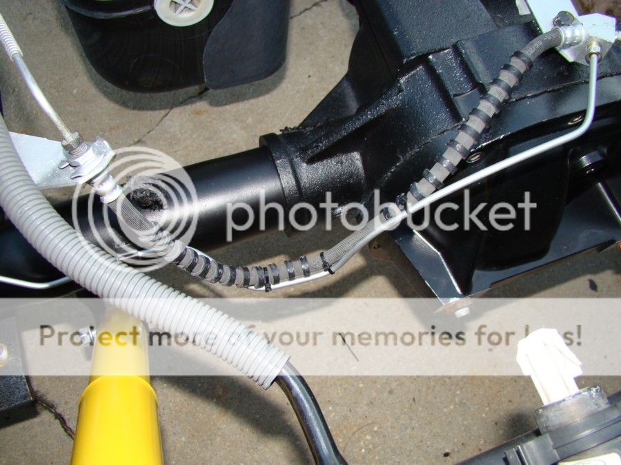

My son fabricated hard lines to fit the Ranger 8.8 housing and to meet the soft 03 Cobra lines at each end. He left plenty of room to service the differential and bent the lines so the U-bolts for the sway bar would clear.

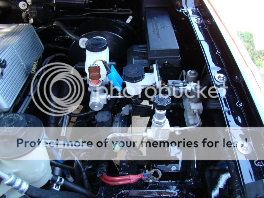

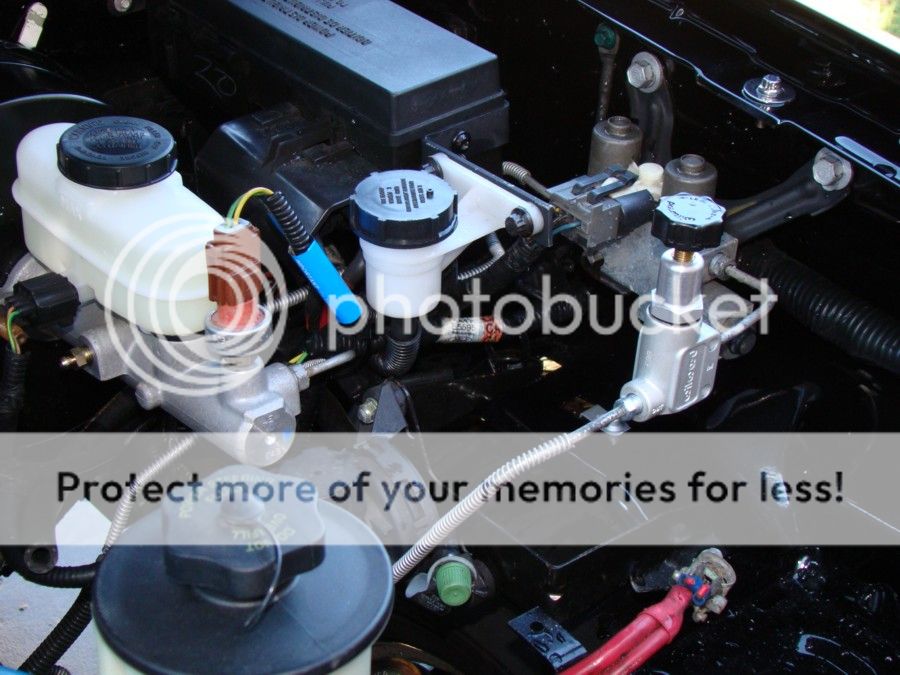

Then we moved up front and installed the adjustable Wilwood proportioning valve. I had not planned on using one of these but a few forum members and my son convinced me it really would be necessary. I still need to fab a bracket to hold it securely in place.
After the proportioning valve was installed we loaded the system with new brake fluid and bled the master cylinder and all four corners. It feels good to have the brake system completed.

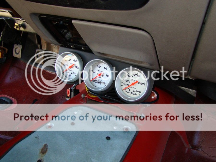

I am still sorting out the gauge pod and interior trim in that area. The ash tray will stay but the passenger air bag key switch obstructed the view of the oil pressure gauge and needed to be moved.
