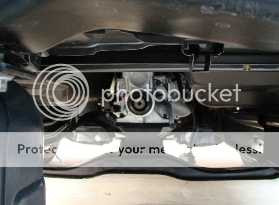

Thanks for the pics i know i made the passenger side correct so all my issues derive from the driver side since my mechanic didnt remove the oem spacer between the engine mount and frame. Any one have a pic of this done properly.
I don't have a photo but it is very straight forward. Just remove the spacer (attached by a single nut) and install the mount back on the frame. You made need to drill one hole on the frame for the guide pin. That should correct the issue and keep you moving forward.
Yep, that spacer has to go. The bite is that to remove the spacer, you've got to pull the spring out of the suspension to get to the bolt.
If the engine is already in the way, its not going to be fun pulling the mount and drilling for the alignment pin.
So true. I fit mine before the engine and front suspension was installed. I guess the guide pin could be shaved off to make the process a little easier. I don't think it is really required. I think it is only there to make R&Ring the nut easier.
Ughh, thanks for the info again....
Under the circumstances, I think I'd simply trim off the alignment pin and save a ton of hassle.
Pretty sure the only real purpose of that pin is to aide in initial assembly at the factory, it sure won't make any structural difference.
Thats what i planned on doing.... Anyway thanks for all the info and solving my small issue next is all the fun of matting a 98 harness to a 2000 ecm. Threadjack over for now

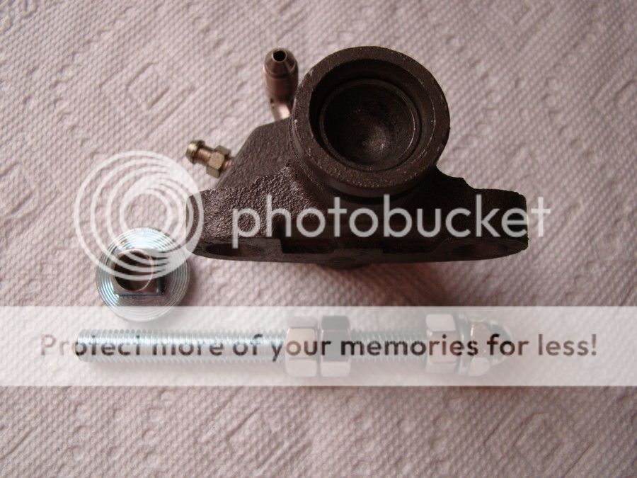

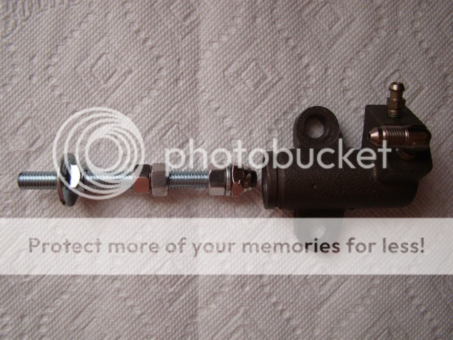

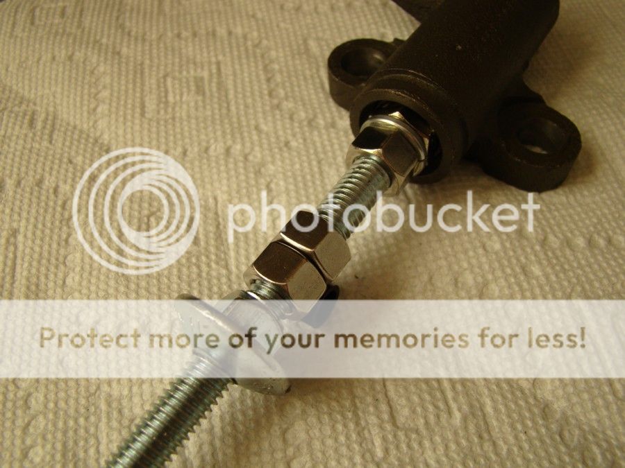

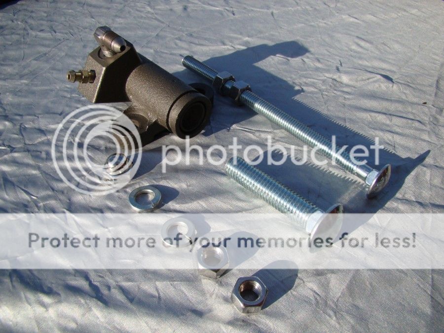

I have been working seven days a week and spending time on household duties at night since the last update. I have not had much time lately but I am looking forward to getting back into the truck project full force very soon. Today I spent a few minutes cutting and grinding the clutch slave cylinder push rod assembly out of a few misc. items I picked up at Lowes.
The parts list consisted of a couple carriage bolts, one in 3/8” and one in 1/2” a few regular nuts, one cap nut, and a couple washers.
One more 2wd 98 coil spring 5.0 swap.

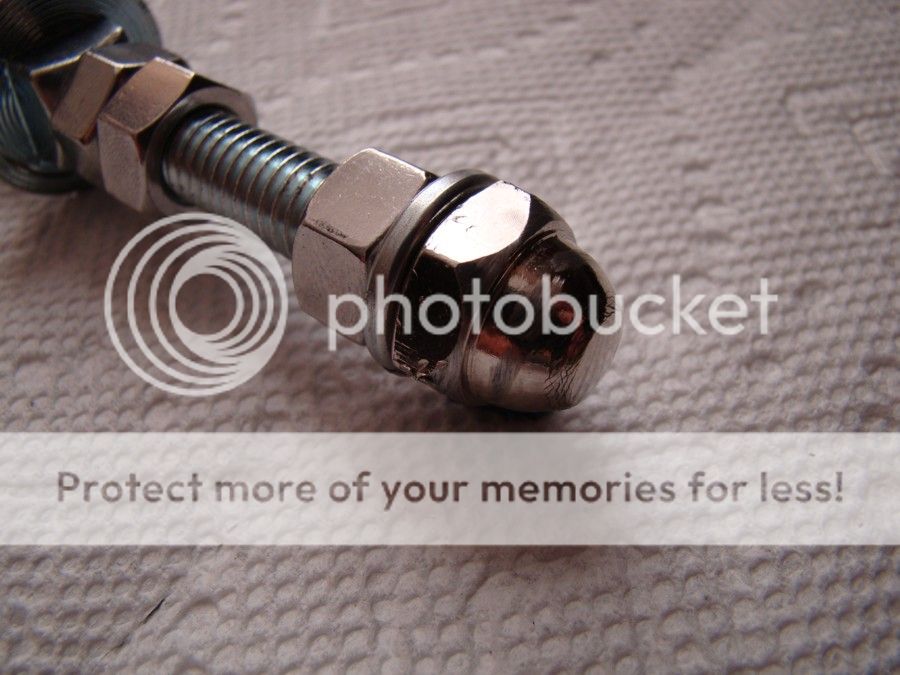

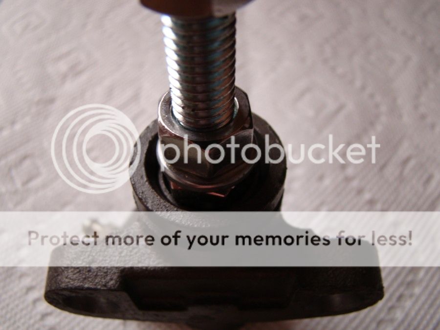

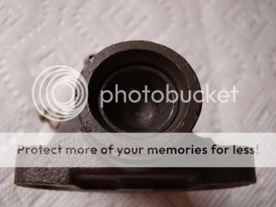

I started by rounding off the sharp edges on the cap nut. This allowed for a nice fit in the cup portion of the clutch slave cylinder piston.

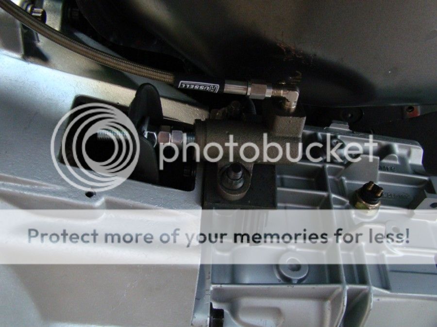

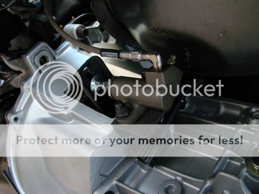

It took a little fine tuning to get the push rod to line up straight and even through the entire throw or travel of the slave cylinder. I had to "build in" some adjustment to the bracket and the slave cylinder mounting holes to get it right. Now no forward movement will be lost straying off in another direction.
The assembly is fully adjustable with locking nuts and is also self centering on both ends.

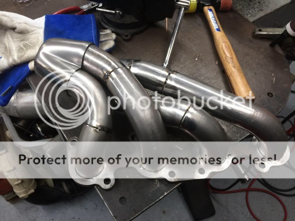

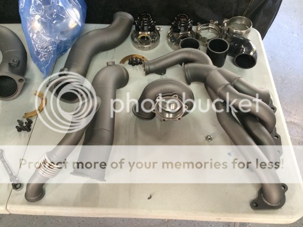

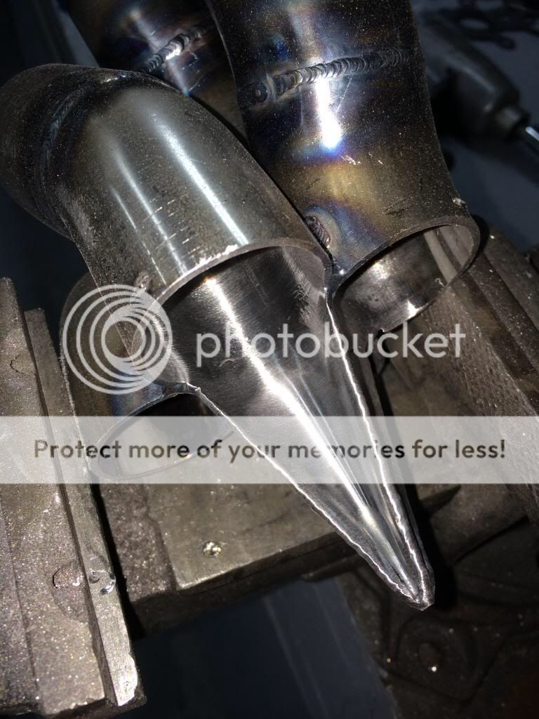

What are you doing for an exhaust system?

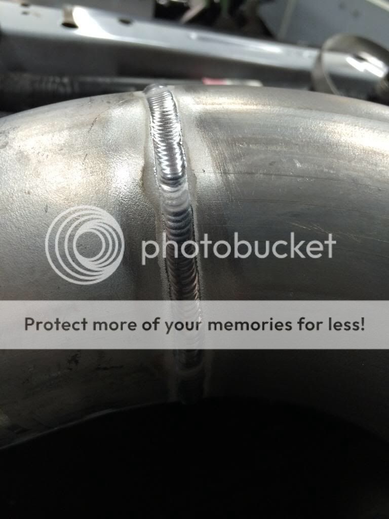

From the Torque Monster headers back it will be 2 1/2 or 2 3/4, not sure yet, no cats, removable mid pipe with cross over to passenger side, x pipe going into two Flow Master 44's and then out the back center spaced about 2 feet apart. All custom mandrel bends (cut and welded). A friend introduced me to a guy here in town that does some custom work on the side out of his home. Here are a few photos of his work, (not my vehicle).
