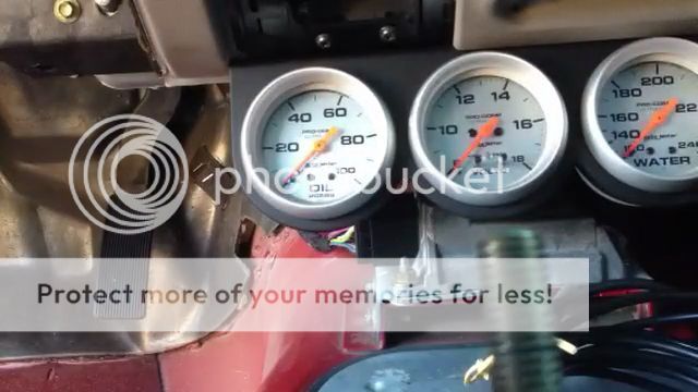

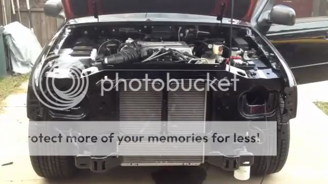

As promised here is the first start up video. I admit I have been playing around for the last few days trying to get the truck to where it would crank when the key was turned. Once that was accomplished my son and I worked on getting it to start. This is the first attempt at getting it to run under its own power. It does not run well but it does run!
I have several codes popping up already,
P0135
P0155
P0176
P0708
P0743
A couple auto trans related codes, a couple o2 sensor codes, and a flex fuel code.
Ok, Ok, on with the video, just remember, this is the first start and it does have open headers and no o2 sensors!
http://vid256.photobucket.com/albums/hh168/jbrown1238/IMG_0955_zpswo889blc.mp4
I will not have any time to work on the truck until after the Christmas holiday. However, if any of you have any comments or suggestions on what might help with the rough running of the engine please feel free to reply. Any help would be greatly appreciated.
My son and I decided to set the balancer at “true” TDC and not the “0” mark on the balancer for TDC. At the same time we went ahead and moved the cam sensor/synchro one tooth and realigned. The truck has run four times for approximately 40 seconds each time. I am trying to keep the exhaust/head temperature down until I have an exhaust system installed. It has not yet been brought up to operating temp. It has good oil pressure and good fuel pressure.

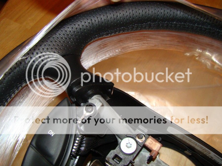

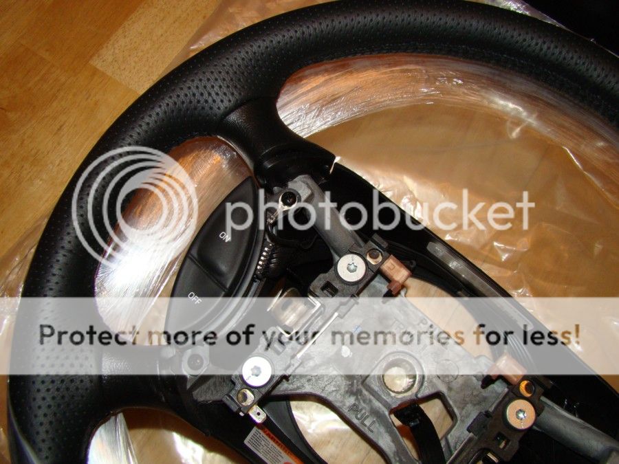

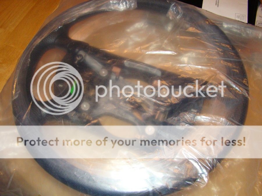

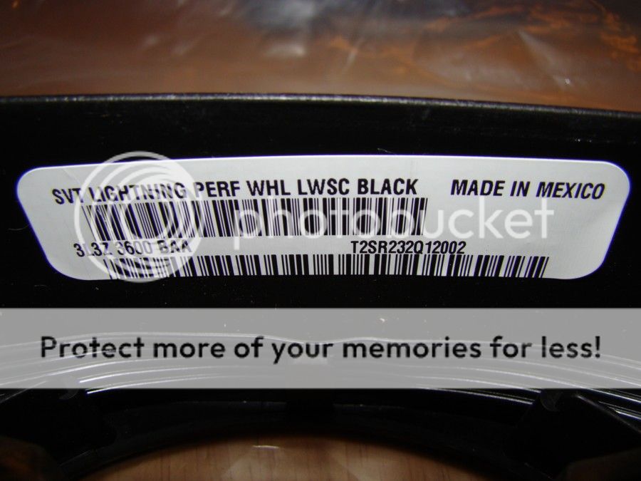

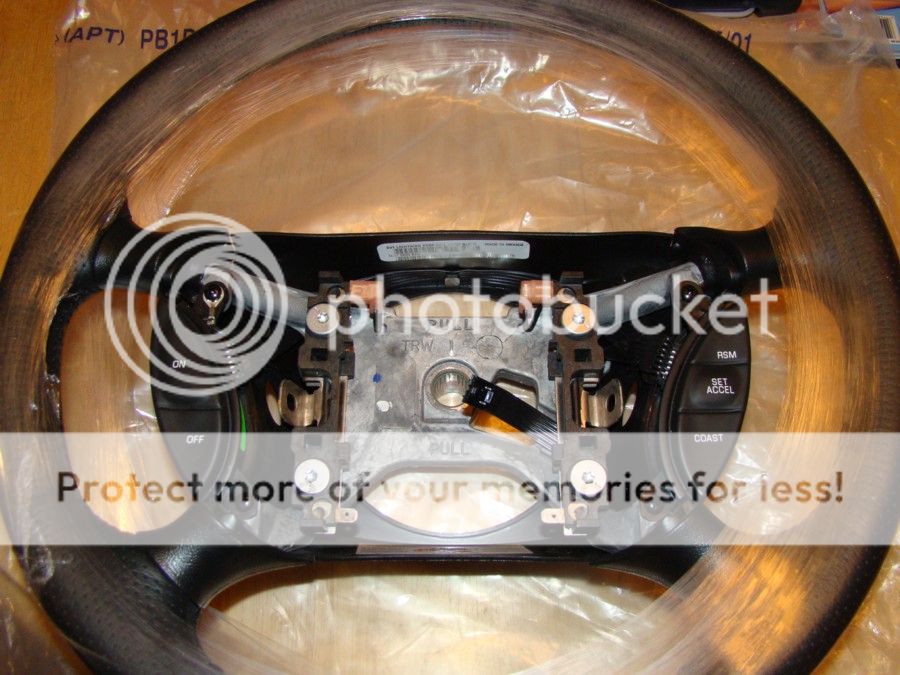

Well Santa showed up today and had the perfect gift set aside for the 99 Ranger! One of the last three brand new 2004 Ford Lightning Leather Wrapped Steering wheels Ford has in inventory. They have been discontinued recently and are on the verge of disappearing for good. I have been sweating bullets for the last month or so!

I felt confident that everything else in the cab could be made to look brand new or be replaced with new pieces but the steering wheel issue has always concerned me. Other than a brand new piece, that part of the restoration would never have the appearance of “new”. Without it the rest of the interior would suffer.
A few days ago I celebrated my 4 year wedding anniversary, a few days later I was able to spend the afternoon with my son and start the 99 Ranger for the first time. December has been a very good month to me. I can’t wait until the day comes in a few months when I can mount this steering wheel! It will be the very last piece installed before the truck is tagged and placed into service.” Thank you Jandi for the perfect Christmas Day present.”

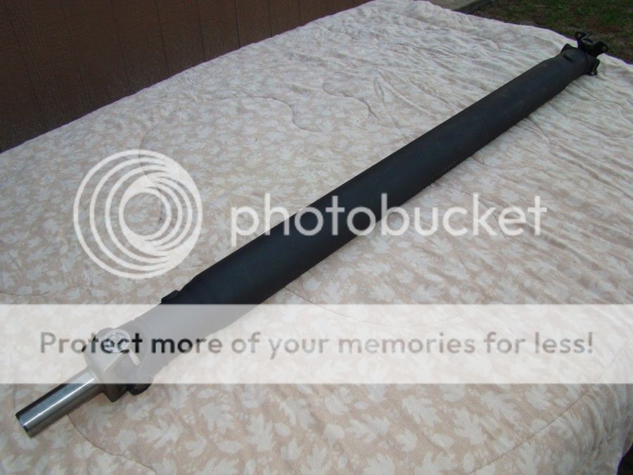

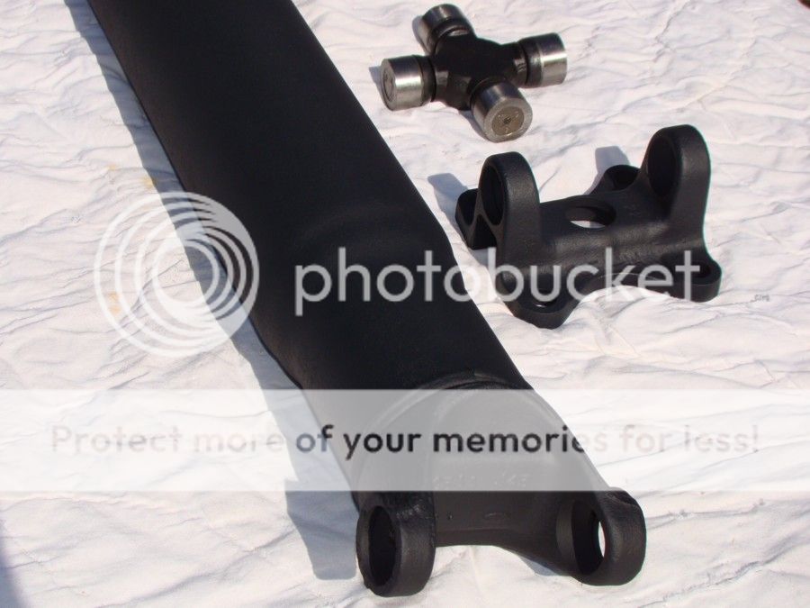

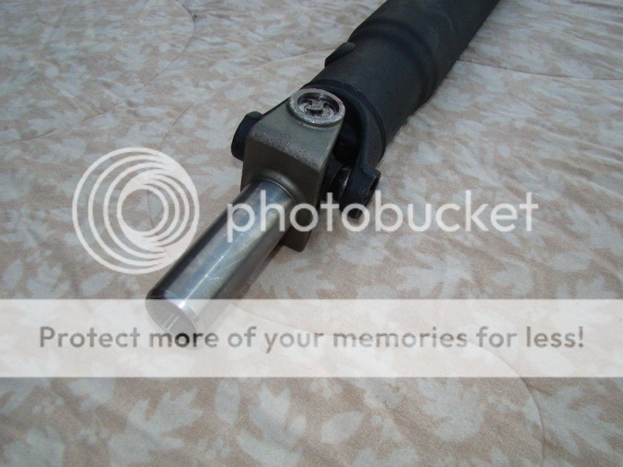

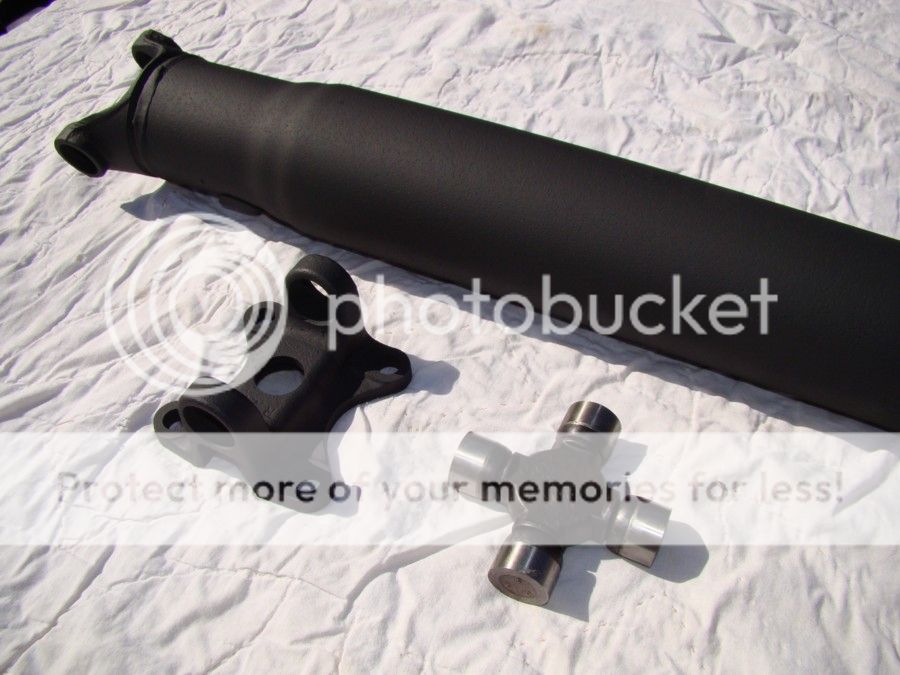

I missed the opportunity to take photos of the drive shaft after it was media blasted. It looked really nice and I wish I could have caught a few images of it in that stage of assembly. Once I got it home I sprayed it with epoxy primer and then a flat black top coat.
One more 2wd 98 coil spring 5.0 swap.
After a day or two of drying time I went ahead and pressed in the new Moog U-joints and attached the new T5 slip yoke. Now it will go out for balancing and after that it will be installed into the 99 Ranger.
