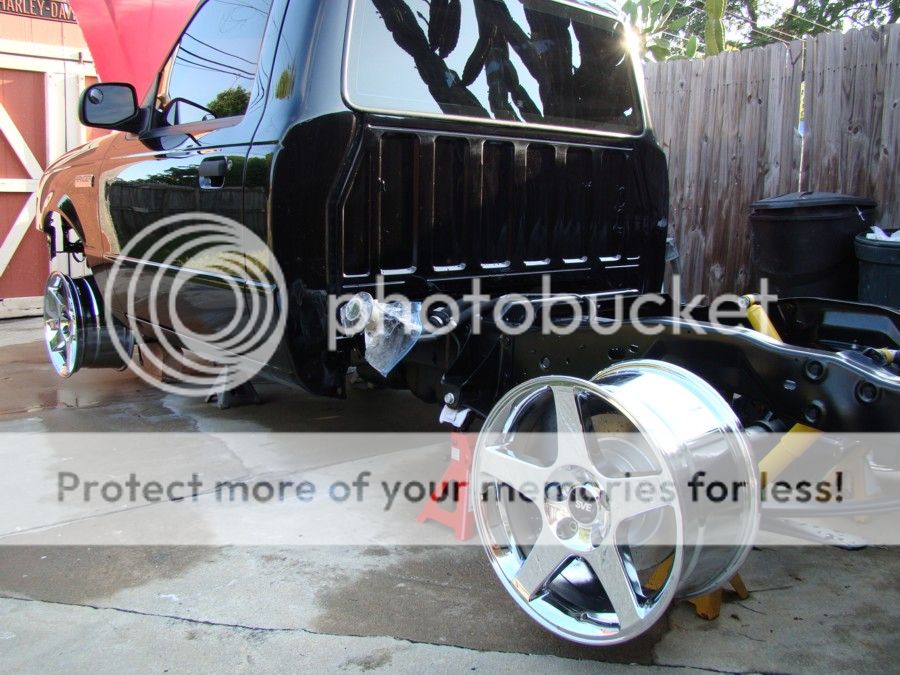

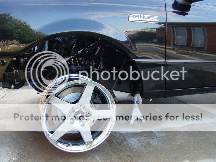

I didn’t want you guys to think I gave up! I took a little time off from working on the truck while I wait on tires. I could not resist today getting out there and washing the truck as it has been collecting a lot of dust under the cover. Before I knew it I was test fitting the new wheel spacers in an attempt to get the center caps to fit. I also went ahead and installed the front fenders (again) to get them off my wife’s sofa and out of the family room. I have included a few more photos just to keep things moving forward.

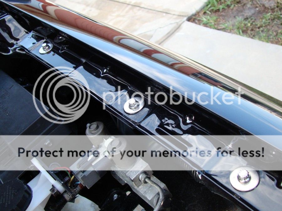

Here are the new 12 pt Stainless ARP fasteners I went with for the front fenders.

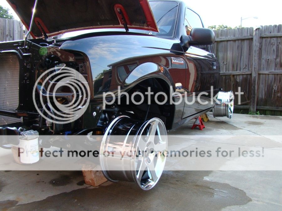

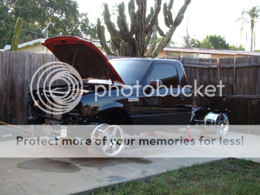

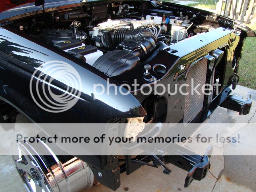

Just a couple shots with the fenders back on. Most of the engine work is done and not much leaning over the fenders should be required in the near future.

The center caps finally are able to be installed with the wheel mounted.

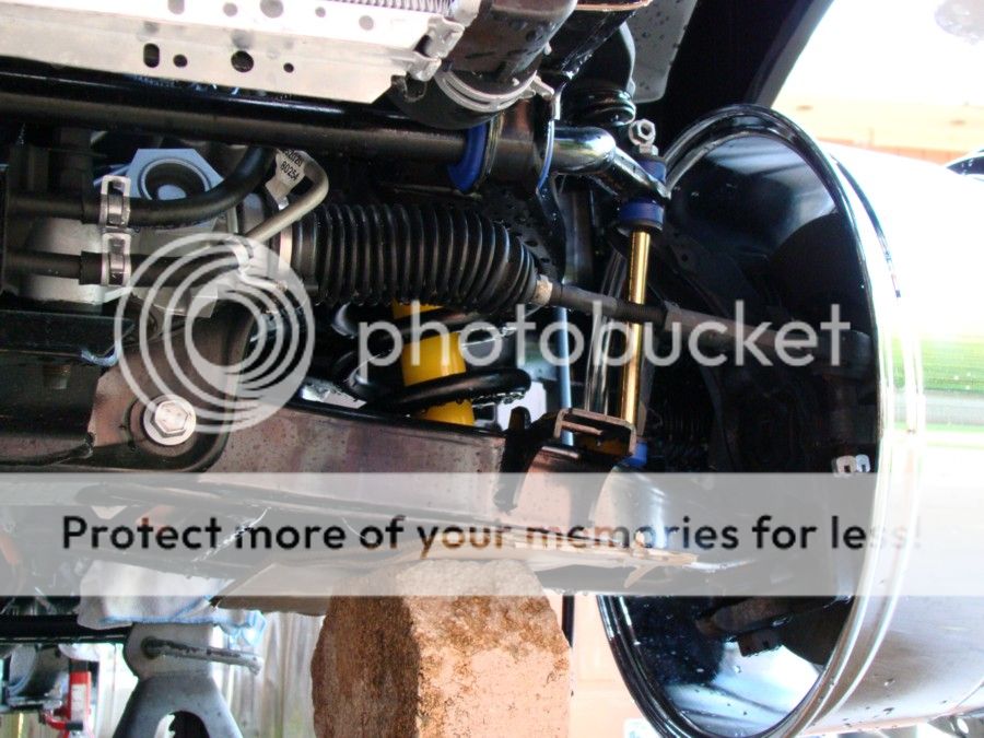

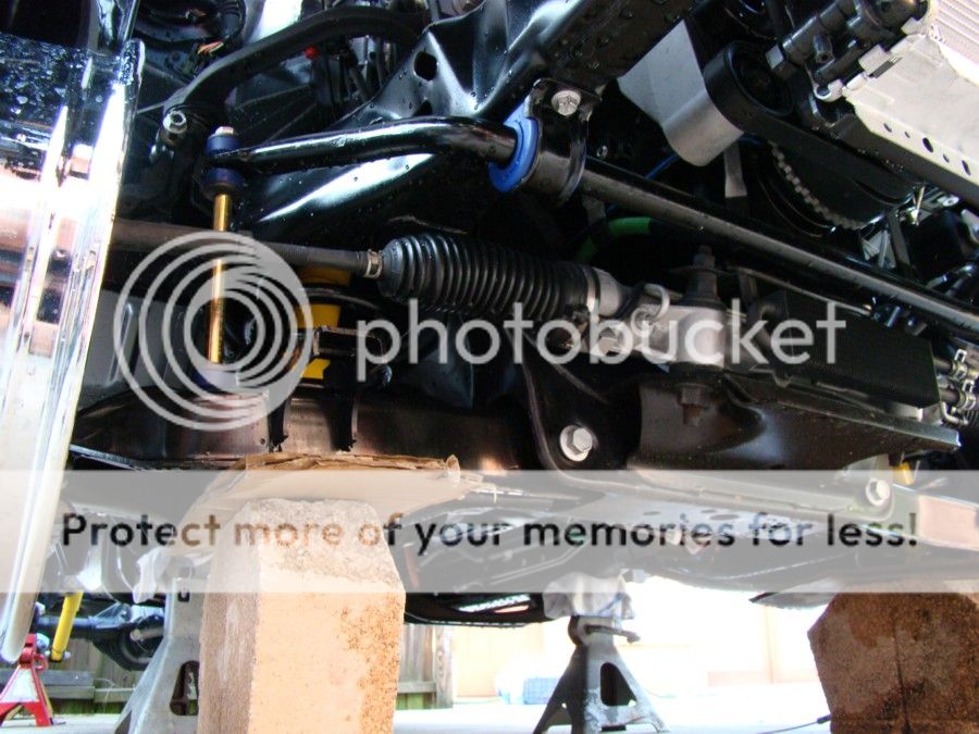

I still need to torque the front suspension pieces but everything is lining up very nicely.

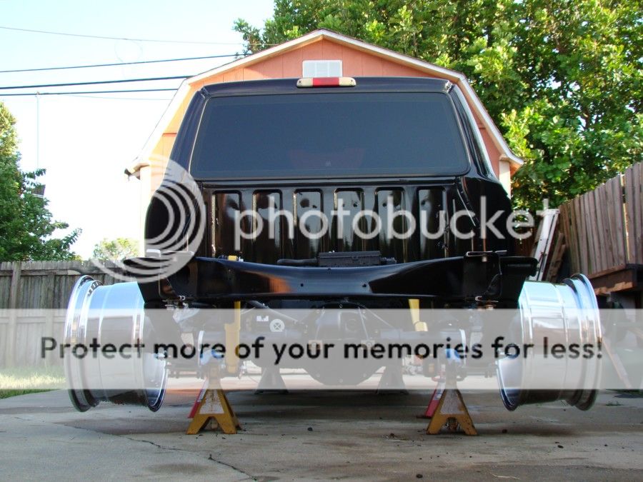

Here are the last few misc. photos of the bunch.
