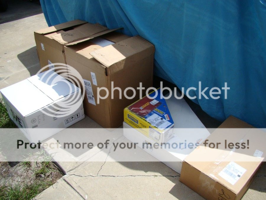

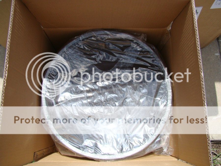

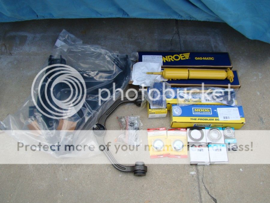

I got home from work today and found several boxes sitting at the front door from UPS.” Oh, goodness, what could it be? Next month’s parts budget I imagine!”
I was pleased to see most of the parts arrived but a little disappointed that a few are still on back order and coming in the next few days. Not to worry, I have enough to get me started and to be honest I am still preparing and painting a few of the front end pieces.

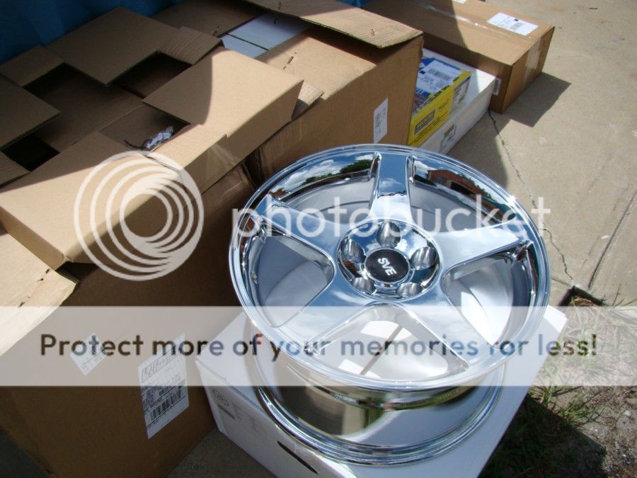

“Let’s open one of the boxes and check out the new wheels.”
I wasn’t sure about the 03 Cobra wheels at first but once I decided on the color for the truck I thought the chrome would go nice with the Tuxedo Black Metallic.
Looks like I have enough pieces to finish one side but I am still missing an upper and lower control arm.

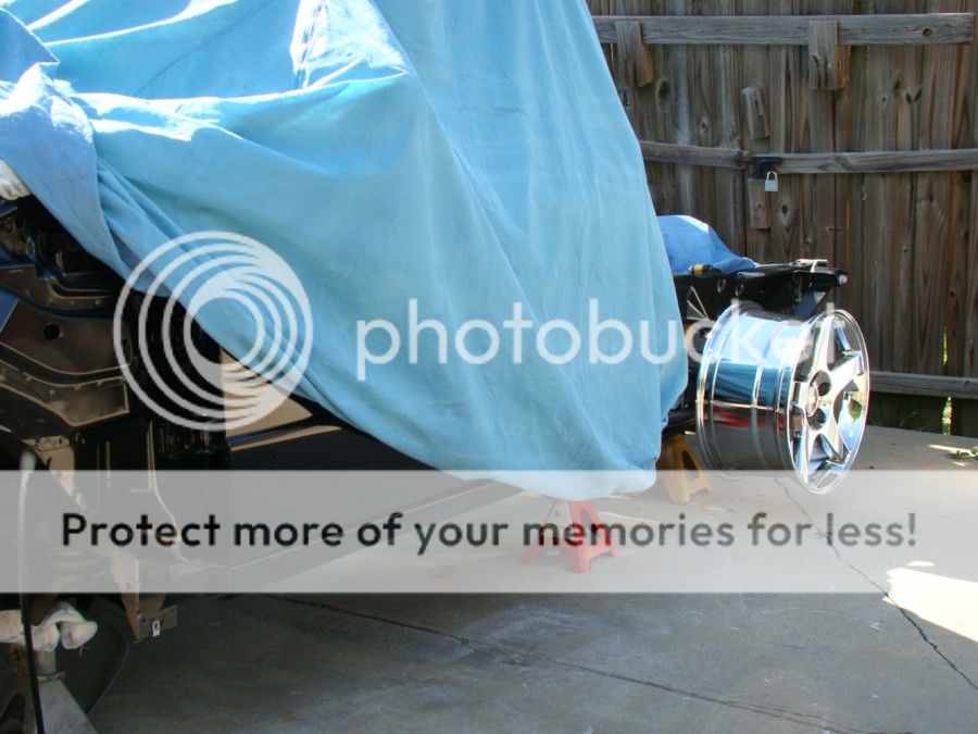

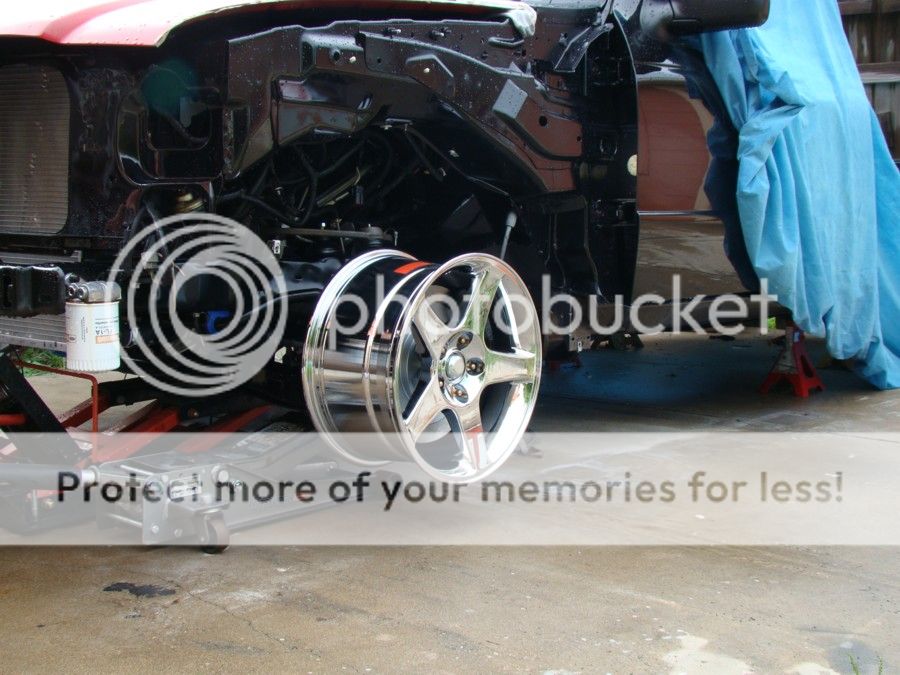

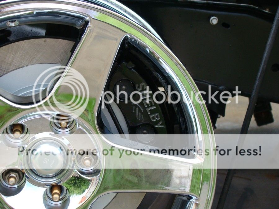

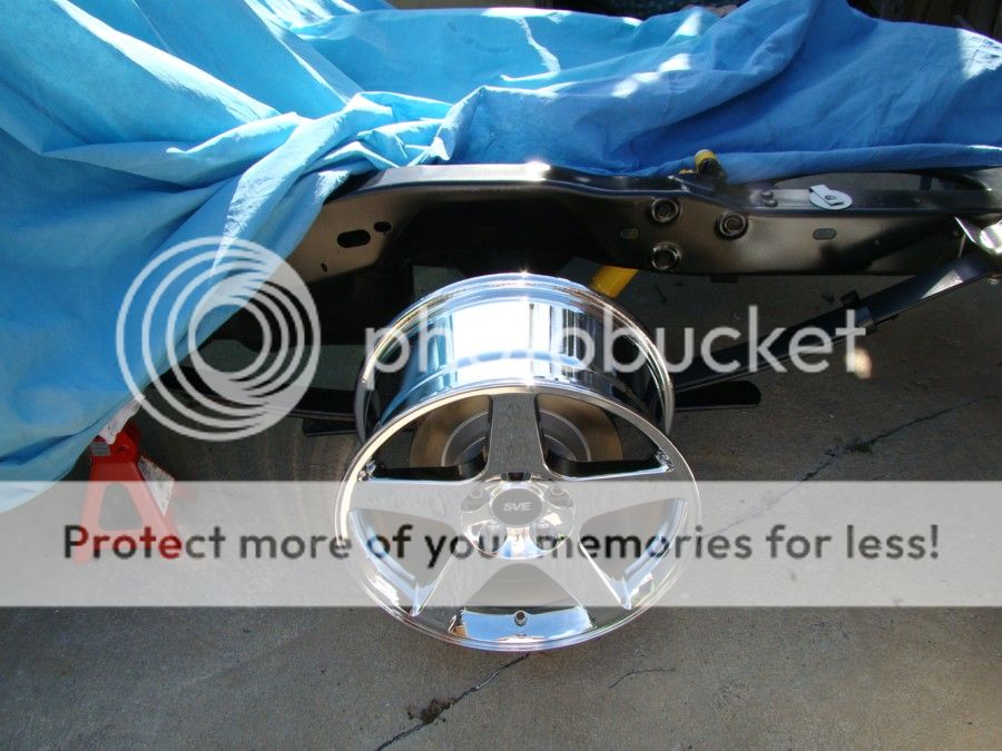

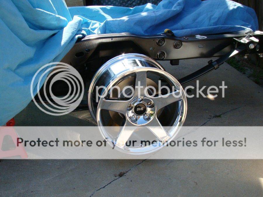

After the frustration started to wear off I decide to test fit one of the wheels on the back so I could get a couple of measurements. The outside of the wheel sits 17 inches from the frame of the truck. I compared that to my 98 Ranger with the stock wheels and it measured the same. So with this offset the wheels should set very close to stock. However, I already know I am going to have to use at least a ½ inch spacer on the front to clear a couple tight spots. I want the offset to be the same front and rear so whatever size spacer I go with I will do the same on all four corners.
The plan is to go ahead and order the tires then mount the wheels and tires on the 98 Ranger and check appearance, stance, and offset. Then find where the clearance issues are and adjust as needed. By using the 98 Ranger I can get an idea of how the wheels will look with the bed mounted and various size spacers on a completely assembled truck. The 98 and 99 I own are somewhat identical in appearance.

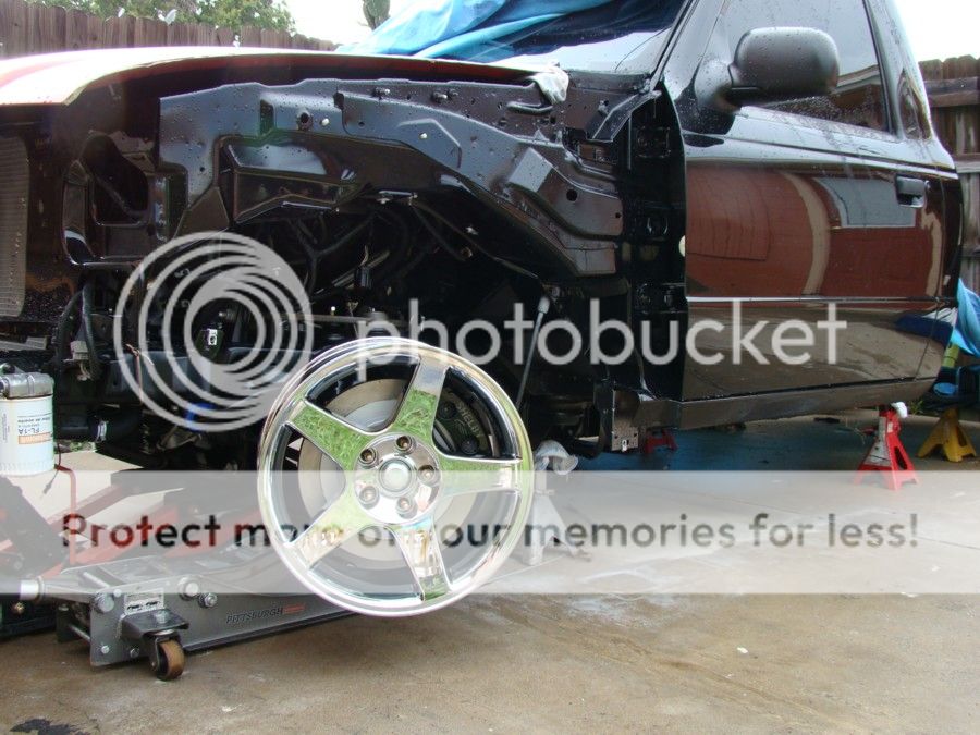

Progress over the past few days has been a bit slow. It seems that the rain sets in each afternoon just when I get started and forces me to work between the showers. Along with the rain I have also had several issues with incorrect parts which required a couple extra trips to the parts store to make exchanges. Then the right side Moog lower control arm was a special order and didn’t ship to the correct location. Just stupid stuff all at one time that ended up costing me a couple days of work.

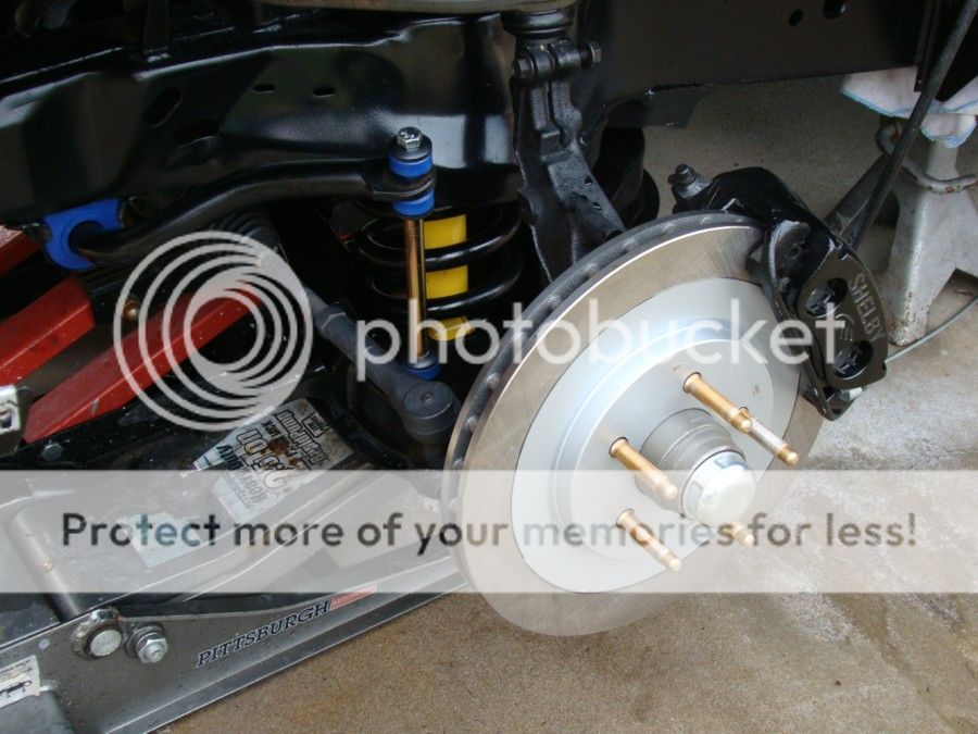

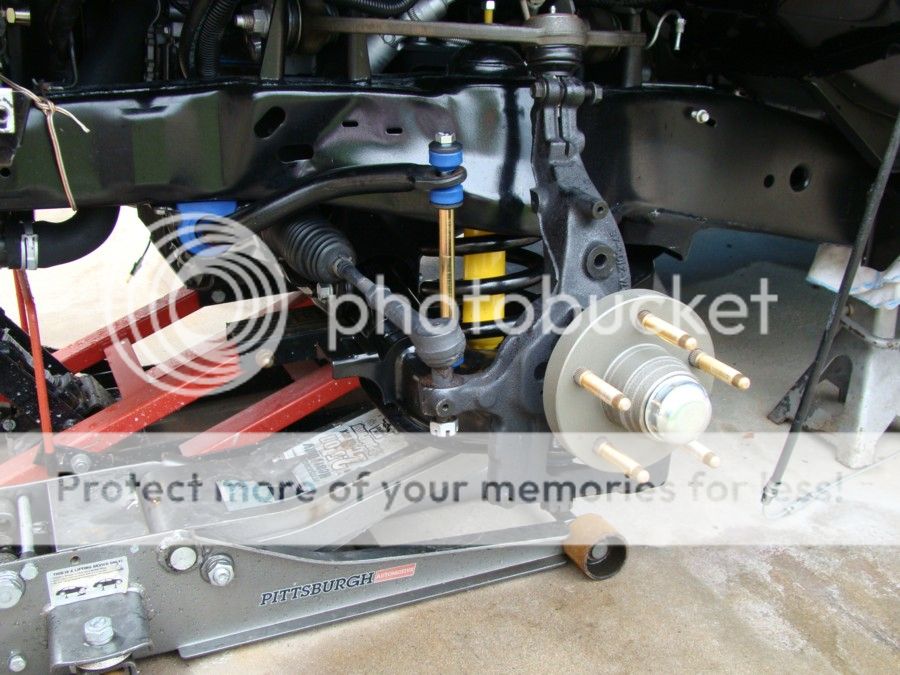

I was able to lightly mock up the driver side front suspension and brake assembly to check the fitment and make sure I had everything I need to move forward.

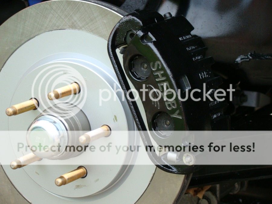

The hub assembly was cleaned and new bearings were packed with grease prior to installation.
Then the brake rotor was added along with the new driver side front caliper. The new hubs and brackets fit flawlessly and the fasteners threaded into place with ease. A perfect precision fit. I could not be happier with the pieces Chris produced for this project.

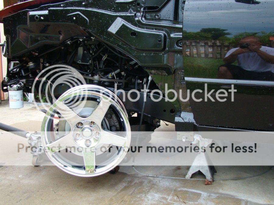

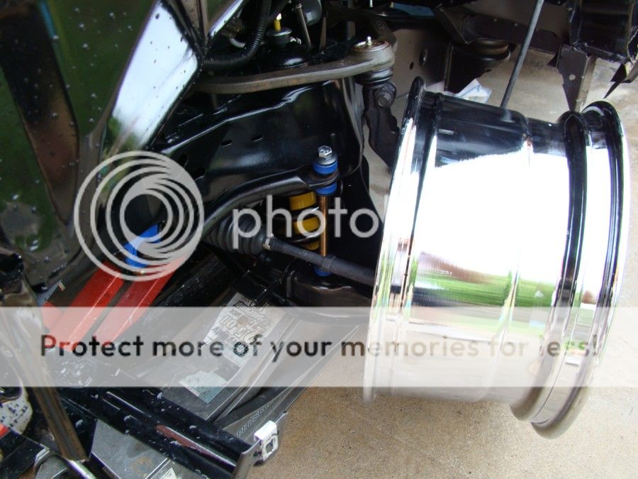

I test fit one of the 17x9 Cobra wheels to double check clearance. There is a slight amount of contact between the dust cap and the wheel when mounted without a wheel spacer. There is also no chance of the wheel center cap fitting without at least a ½ inch spacer. This comes as no surprise as many threads I read while working up to this point described the issue. I am going to stop by the parts store today and compare the diameter measurement of the OEM Ranger dust cap to the 03 Cobra dust cap. The 03 Cobra dust cap isn’t as tall as the Ranger dust cap and may save some space in this area. I am still planning on using at least a ¼ inch spacer and probably will just go ahead and get the ½ inch spacers for all four corners.
I turned the wheel lock to lock and didn’t find any problems with clearance. Of course this is with the suspension fully extended and no tire mounted. I still plan to wait to order the spacers until the tires are mounted on the wheels and the clearances double checked on the 98 Ranger when the suspension is loaded.
