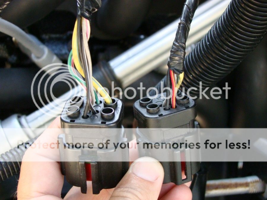

I was hoping you might drop in and lend a hand. I think I may be missing the small harness for the A/C compressor clutch and the A/C high pressure switch, or at least part of that harness to include those connections. I used the 2001 5.0L Mountaineer Engine Harness and Battery/Starter Harness.

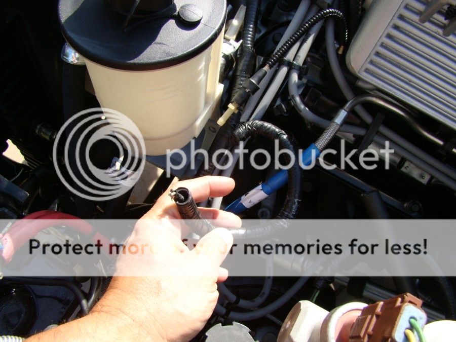

Here is a photo of a cropped pigtail that runs off the alternator portion of the harness near the AC compressor location. I am not sure what this would have included other than ac connections. This is from the salvage harness that came with the salvage 2001 Mountaineer 5.0L I purchased.

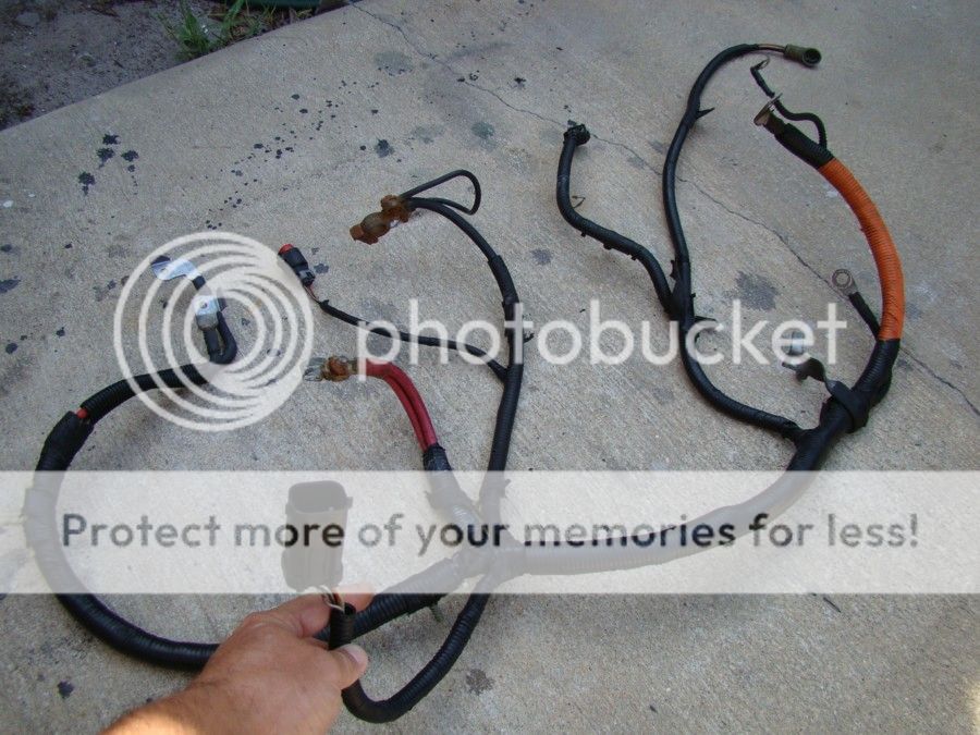

Here is a photo of the 1999 Ranger 3.0L Starter/Alternator harness I saved from disassembly. It includes one of the male 12 pin connectors discussed in your previous post. I installed the 2001 5.0L Mountaineer harness to replace the one pictured here.

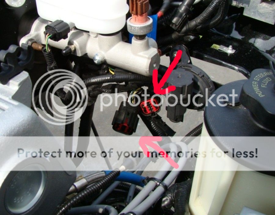

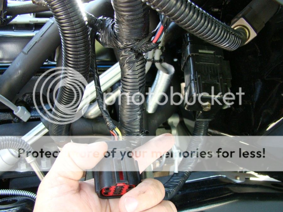

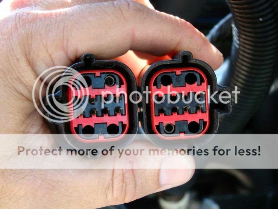

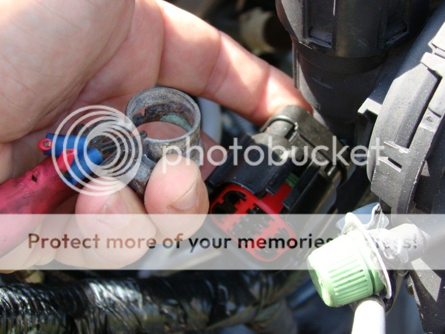

Here are two better photos of the 12 pin connectors in question located on the truck.
The first runs directly off the positive side of the battery cable/harness (2001 Mountaineer 5.0L harness).
The second one runs directly off the harness that includes the 42 pin connector on the chassis side (1999 Ranger 3.0L Harness).
Thoughts?
Questions:
The Battery Harness I removed from the 3.0L Ranger had a male 12 pin connector. The Battery Harness I installed from the 5.0L Mountaineer has a female 12 pin connector. Is it possible these connectors are for the same circuit? I am wondering if the two female 12 pin connectors remaining on the truck should be “connected”. I am going to pull the EVTM’s for both and start reading but once again I would feel better with a second opinion.
Are you sure about c125? I show it as c139 in the Explorer EVTM, same as Ranger c184. However, I am new to this and I am not 100% sure of my findings.
The heavy gauge Y/LTB wire is your starter solenoid wire. The R/Y and BK/W are the AC high pressure switch wires (vehicle side) and will need to be removed from the engine harness and installed in the fenderwell harness, along side the driverside of the radiator, to the new location of the high pressure switch. The remaining grey (GY/BK or GY/W, cant remember off the top of my head) and black wires are for the AC compressor clutch, which go to the 12 pin plug....
The one on the right is the Ranger C184 and should have all you need except the DG/WH to the oil pressure sending switch. Easy enough to add or route through the main engine harness.
The one on the left looks like the 5.0 Explorer C125 except I don't see a RD/YE. Somewhere in my foggy memory, I seem to remember that the 01 5.0's had a couple of wire differences compared to the 99~00 but I don't have a 01 Wiring Manual to confirm that.
I have seen this before and I believe that I had to change connector shells on mine (99 Ex in 2003 Ranger). So, yes, possible.
