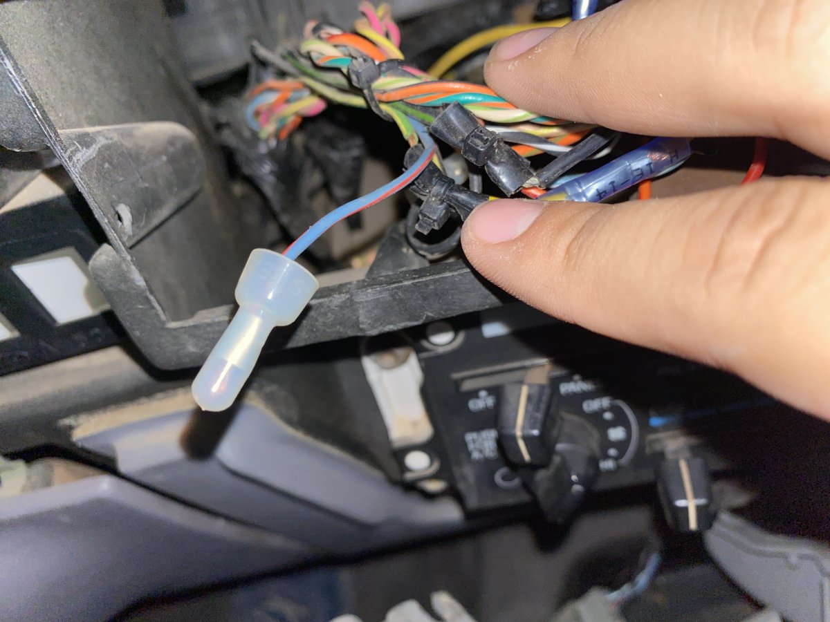

Hello everyone, This is my first post here. I have a 1993 Ford Ranger XLT 3.0 2wd. i'm not sure where to begin with my issue and i could use some assistance. I recently got a new head unit installed by a buddy and since then i've had no dash lights and no running lights but the dash lights work when i push the headlight switch in between the 1st and 2nd mode and only at full brightness. Im not sure where to begin and what to check.
The instrument light dimmer wire at the radio is Lt Blue/Red. Pull the radio back out and check and make sure that your buddy didn't connect that wire wrong. I've seen people use the dimmer wire for a ground before, as it looks like a ground when the lights are off.

Would it be this cable?
No dash lights and no running lights. help needed.
Yes. It's good that it's capped.

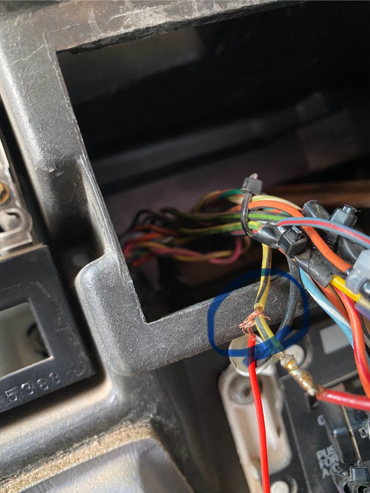

But I see bare copper on the Lt Green/Yellow wire behind it; that is a constant power wire, so that needs tape or reconnecting so that the copper is not exposed.
Have you checked all of the fuses?

just got those cabled wrapped up with some tape. changed out some fuses and that did it. the dash lights work again and the running lights as well. only thing that doesn't work (dont really mind) is the dimming. thank you very much!
