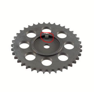

I still think the camshaft sprocket has slipped, no way to tell without removing it.
He said he took the cover off and valve timing is correct.

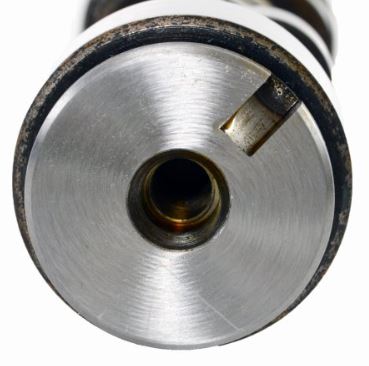

According to the timing marks it would be, but is the camshaft sprocket still timed to the camshaft?
Is the keyway still lined up properly on the sprockets? , no way to tell with out removing and inspecting
.View attachment 84667View attachment 84668
He said it ran after he put it together. If the cam gear slipped on the cam... good chance it would have never started and ran.

But you could tell me how it would have started if the cam gear actually spun on the cam...
