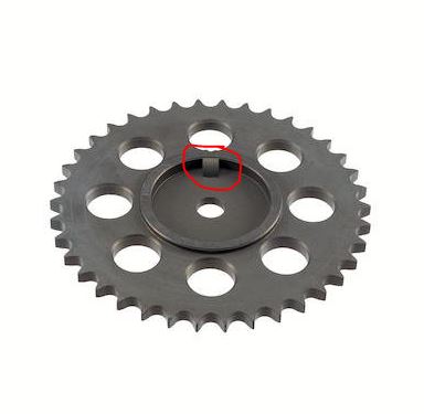

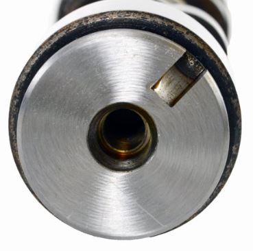

I still think the camshaft sprocket has slipped, no way to tell without removing it.

But you could tell me how it would have started if the cam gear actually spun on the cam...
The little nub that holds it in place caught just long enough to run for a few seconds.

According to the timing marks it would be, but is the camshaft sprocket still timed to the camshaft?
Is the keyway still lined up properly on the sprockets? , no way to tell with out removing and inspecting
