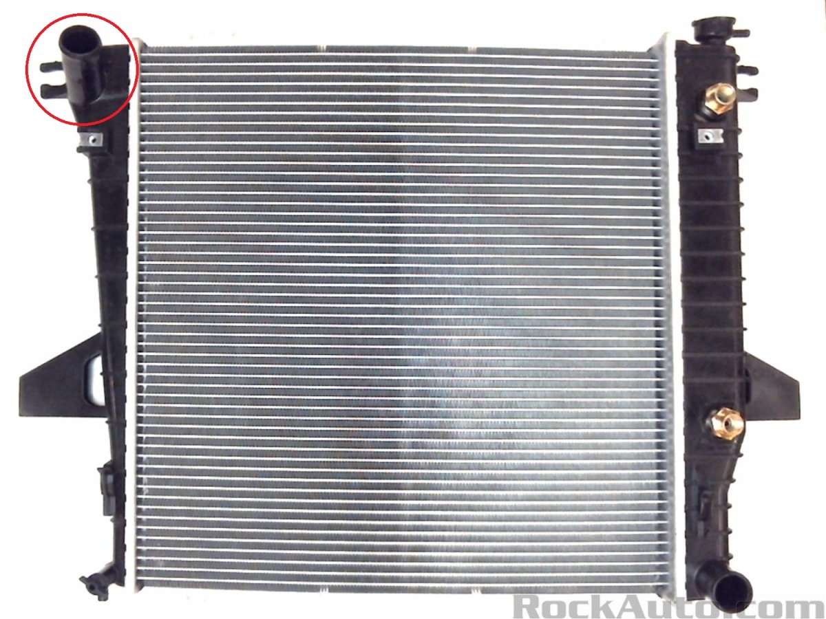

My biggest question is why don't any radiators have the same plastic part that I'm fixing? They're all rectangular without the black plastic goose neck thingee. Do I buy that separately? Do I even need the rectangular radiator? I'm very confused that I can not find the black plastic part. 🥺

Radiator or just the plastic leaking part?? 🥺🥺🥺😞
Is this what you're meaning by "gooseneck", in the red circle? This image is the $79.99 radiator on RockAuto.
The radiator that you buy should look like this one. The black side tanks are plastic, like what you have now. It's not really cost-effective to replace or repair a side tank, so the radiator is replaced as an assembly, just like what you see here.
You might be having trouble seeing the details of the radiator on the web page that you're buying from. See if there are multiple views or zoom functions on the website you're using, so that you can get a better look and be confident before you buy.

Yes those things! Ok. So they are part of the radiator? Hmm...ok
That's too bad. The black part in the red circle is what I was asking about. That's the broken part. I didn't realize that was a radiator part. I thought it was a cover. 🤭
