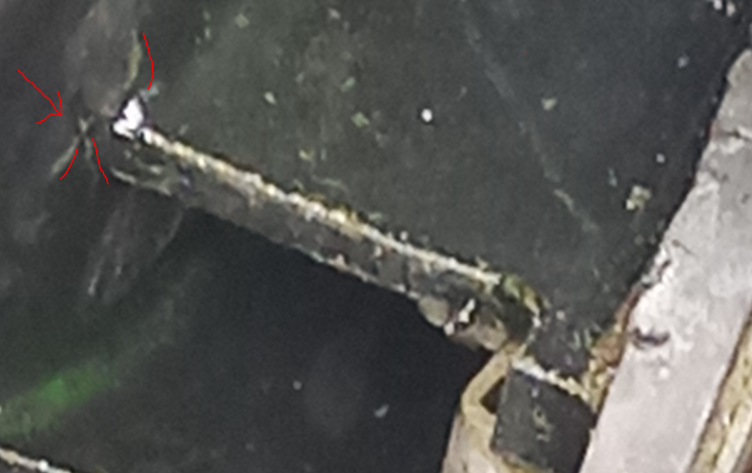

Can you get a picture from other side? Water flows downhill, there's no leak on side shown.

So long as you have coolant in the radiator, you won't have an overheating issue. (Remove radiator cap when cold, fluid should be right there). Wipe up the coolant that has leaked so you can determine if it is still leaking and how fast.
Aside: Not much cooling needs to happen through the radiator when driving on hi-way in Minnesota this time of year. Way back in the day, I put a rock through the radiator of my Dodge Omni. We drove 200+ miles after without even noticing - only when we got into city did we have a problem. (Which wasn't helped by clutch throw out bearing failing at same time). Once radiator was replaced, the car ran fine for 3 more years that I had the car.​
I'm not sure if there is a crack where the fan shroud bolt to rad. If there isn't any green coolant higher than that point, I suspect that is your issue. (hopefully, you can locate what I have blown up in the bigger picture.

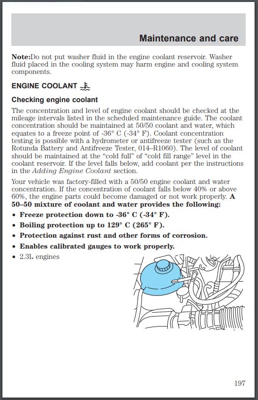

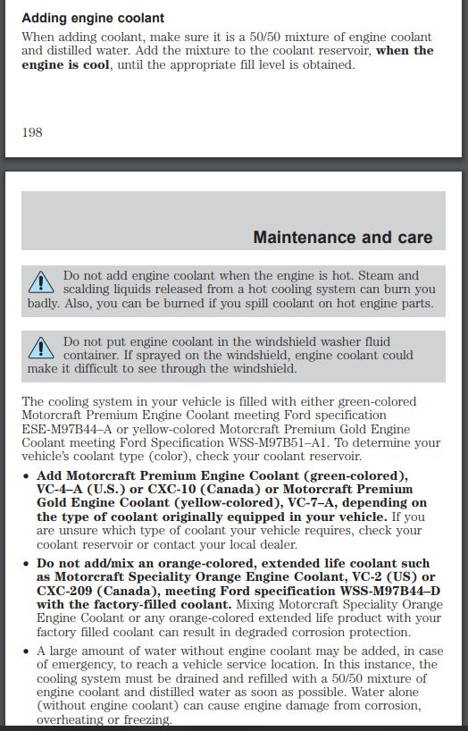

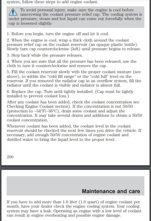

Yes, just make sure that the coolant doesn't get too low, until you can have the leak repaired. As long as you check the coolant level often, you should be able to maintain the level by adding more coolant to the reserviour tank. These are the important parts of the instructions for adding coolant from your truck's owners manual.

Found the leak. Also neighbor re tightened metal clasp it wasn't flush with radiator. Hose was about a quarter inch gap from radiator and yess Robbie the screw was not really tight.
It's on the top of the plastic "gooseneck" if that's the right word
