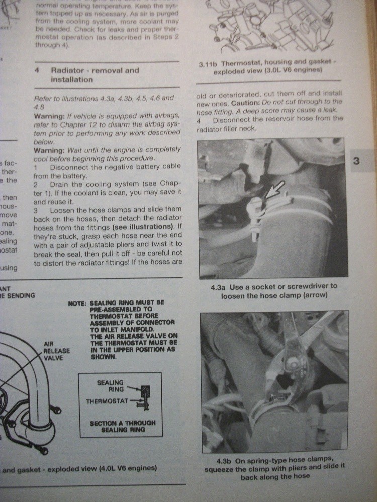

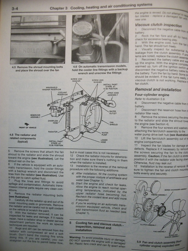

My literature is limited to 1983-1994, but I do have a Haynes Repair Manual for 1993 thru 2000 Ranger models.
Here are the radiator removal and reinstallation instructions, in case they are helpful for you.
These "aftermarket" repair books generalize some, since they cover multiple years, so some text and illustrations may not exactly match what you're working on. But the step-by-step may help you stay better organized.
You can get a repair book like this from a parts store, or Amazon I'd imagine. May be worthwhile for to you to have one.
