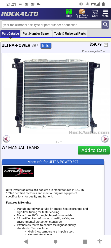

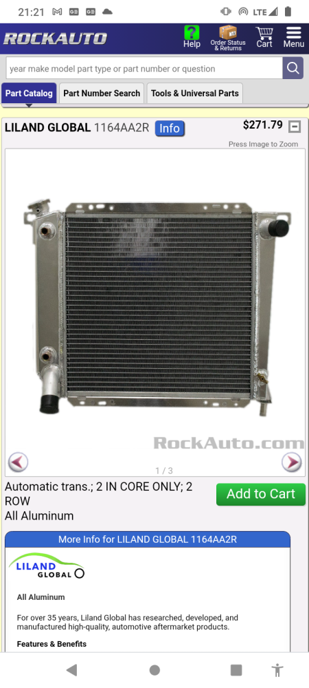

I do not exist to question a professional's estimate; however if the mechanic is using an all aluminum 2" thick, 2 core explorer radiator, it is reasonable. If the mechanic is using a $69.99 K-mart special...then I would purchase my own radiator and pay their $400 in labor.
$279 is all aluminum 2 core, 2" Explorer
$69.99 is cheapest plastic core market

Is the 69.99$ one for my truck? Would it be ok to use?
Yes, it should fit and work. In general, it used to be that a part's cost was pretty much directly related to the materials and processes used to make it. The last few years, though, it seems that replacement parts quality has really gone downhill, and the prices have gone up. I'm afraid that it's sort of a gamble; the lowest cost replacement part may help when the budget is tight, and it should work as advertised to get your truck back in service, but it may not hold up as long as a more expensive one.
The cheaper one says manual transmission. My truck is automatic.
