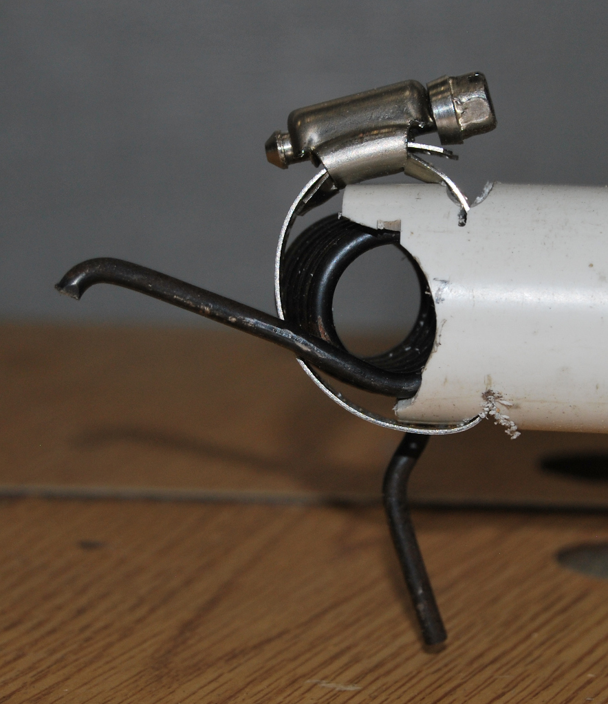

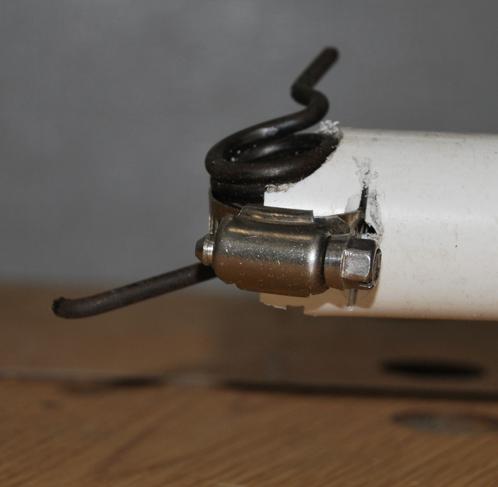

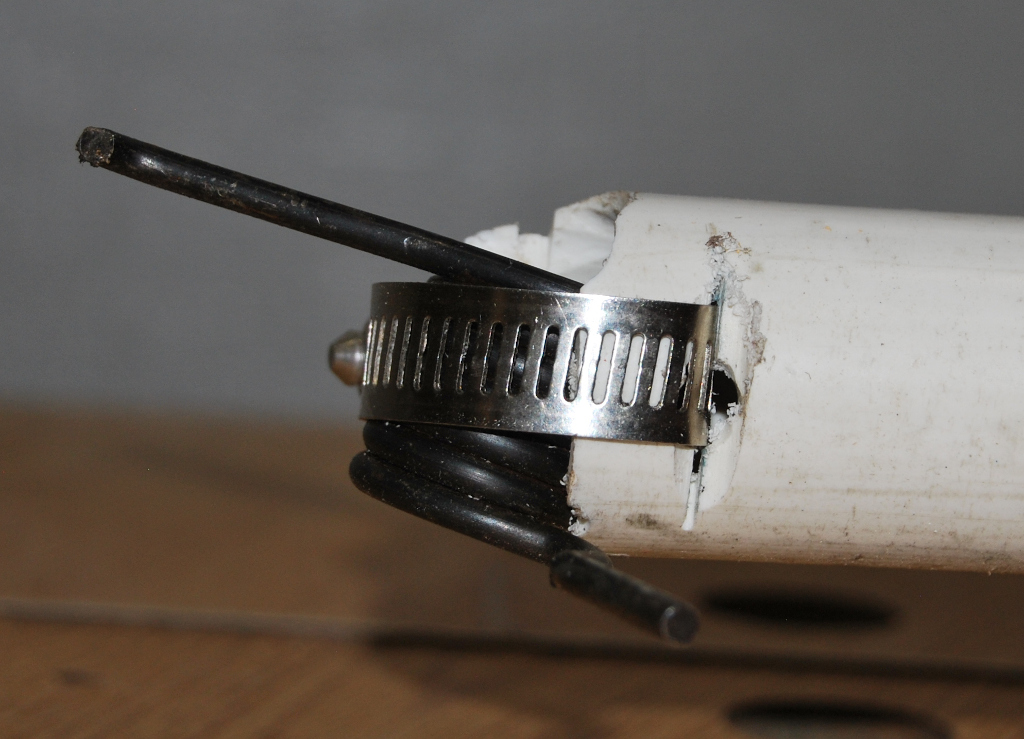

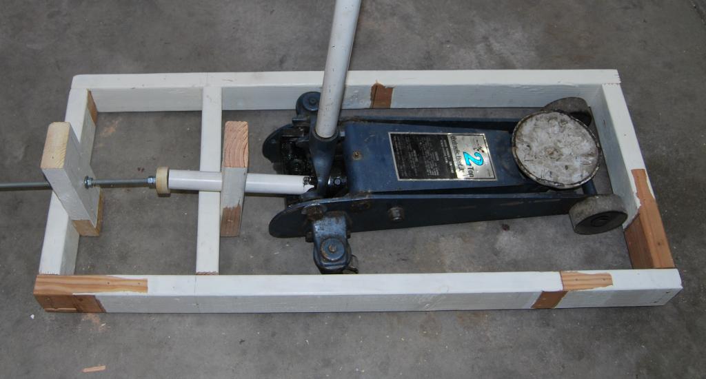

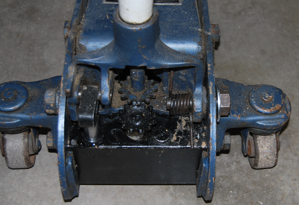

Finally had my 1970's Sears floor jack rebuilt. Unfortunately I removed the handle while disassembly the jack for repair. I see now that the handle did not need to removed.
Now I cannot see how this spring is to be installed. The spring is supposed to help hold the handle in the up position. Any ideas?
Ok. figured it out but had to make up this rig. I simply could not push the spring in, move the ends into place, and insert the pivot bolt with just two hands.
And success.
