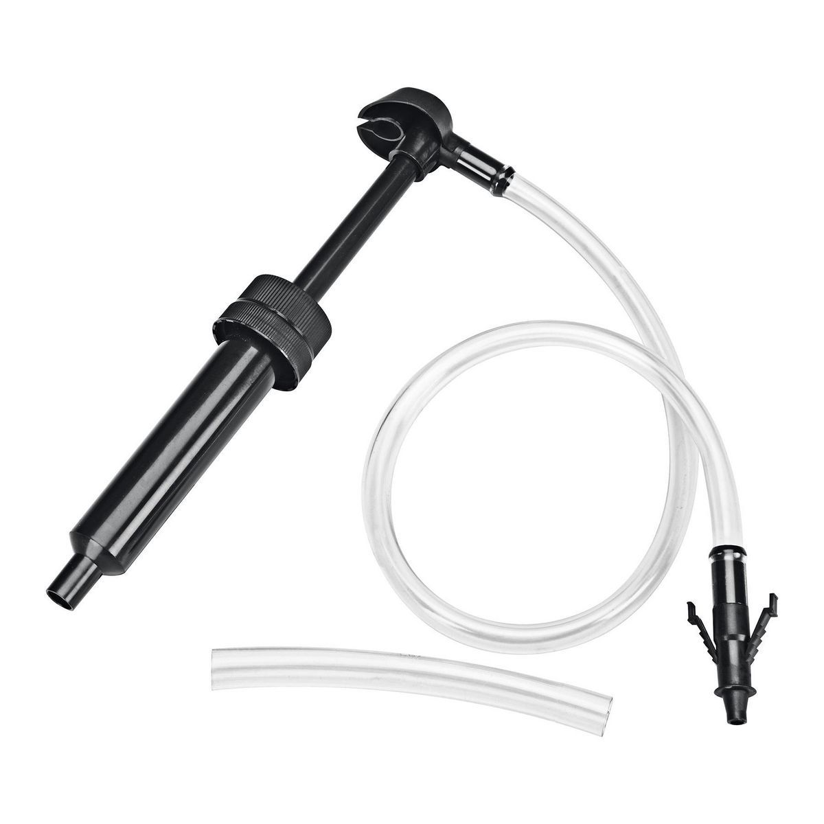

In pregaming for when I go to do the fluid changes on the Escape, I picked up a fluid extractor and a pump for 1 quart bottles.
I bought one of harbor farts hand pump fluid deals awhile back... Suuuuper unimpressed lol.
"Fits most quart and gallon jugs"
I had both.
It fit nothing.
Their claim that it moves 1oz of fluid per pump was also definitely bogus in my case as well.. I musta pumped 112 times to empty my first quart into the axle lol.
I had both.
It fit nothing.
Looking at the "cap" size on it, it might fit a Mercon bottle. They have an odd sized lid. I'm pretty sure it won't fit the standard cap opening on a gear oil or engine oil bottle. I guess I'll find out.
