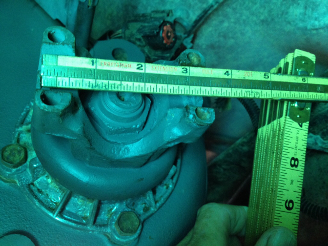

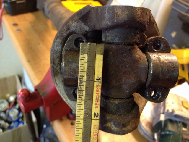

My next challenge is the front driveshaft to T/C connection. Both are 1310 size u joints but the tc has a wider bolt pattern. I can't remember what the donor truck had as a mount on the ds. Options are a different yoke on the tc or a different centering yoke on the CV joint?

The full size cases came with 1330 joint yokes which share the same cap size as the 1310 but are wider and larger body joints. You could run a 1310-1330 conversion joint, fot mine off eBay for $20 or do a yoke swap on either the shaft or tc.
I'd swap slip yokes on the shaft. Easy enough to find those in the junkyard. I have about a dozen different styles on hand...
SVT
Maybe I wasn't clear enough. The bolt holes on the yoke of the tc don't align with those on the centering yoke of the double cardan on the driveshaft. The slip joint is on the front differential and is no problem. The width between the ujoint cap tabs of the tc
Yoke is 3 7/32" which is a 1310. I think the 1978 f150 used u clamps to secure the ujoint to the tc yoke and that won't work with the double cardan centering yoke which is threaded for bolts. So I either have to change the tc yoke so the bolt holes line up or the centering yoke. I found a CV yoke listed on one site for the tc and I'm going to see if they can get me the dimensions of the bolt pattern
Yes the f150 does use ubolts to hold the shaft on. I suggest finding another shaft. I'm lifted and a single joint is doing fine.
