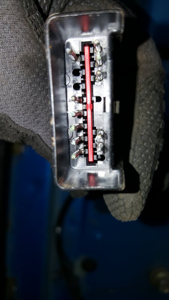

I've been slowly pulling, labeling, and swapping things. I'm getting to the point of putting things back together, and I ran into another snafu. The wiring within the cab, that runs from the dash down the driver's side floor, and powers the speakers, brake light above the window, seat belt sensors, dome light, etc, runs up the wall of the 2 door right behind the driver door. This isn't going to work with the 2+2, as I'd really like to have the door operable. all the connections are the same, so should I just splice the wiring, and add the connecting piece to the older harness? Or am I going to have to have a custom loom built for the dash...? I'll post pictures in a few, relevant to this question. I'm saving my archive to start a build thread whenever I'm finished (don't want to use up a bunch of build time crafting a build thread, haha!).
This is the existing connection, leading to the rear of the cab. Speakers, break light, dome light, seat belts, etc.
