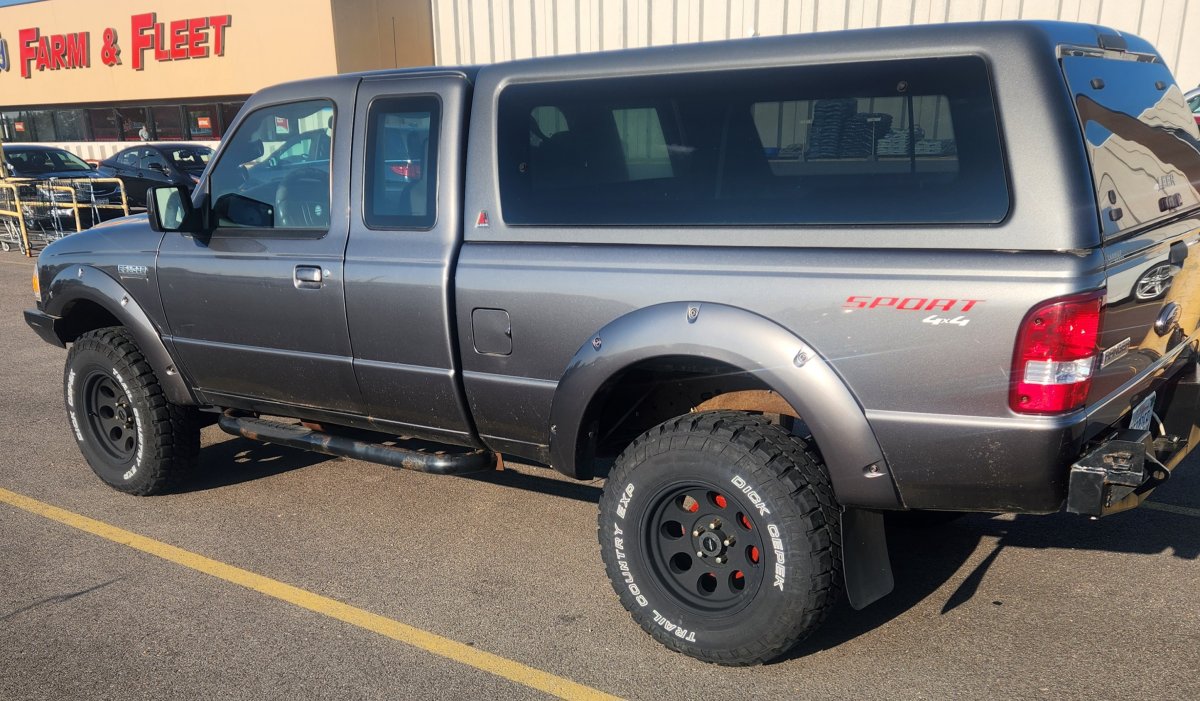

I run a set of Dick Cepek Trail Country EXP in 265/75/16 on my pickup. They actually measure at 31.9 inch tall. They're now the Mickey Thompson Baja Legend EXP. In 16 inch wheel... they're E rated truck tires. But I don't find them super stiff and they weigh in at 50lbs each... which is pretty light for a truck tire.
Road noise isn't horrible... until it's time to rotate. They handle good dry or wet but they aren't super great in snow compared to my old tires. They've worn really well and do have a 50k factory warranty. I have about 40k on mine and they look like they could go another 30k.
I like them enough I'll probably buy another set when it's time... but I'm probably gonna jump up to the 305/70/16 that measure 33 inches tall.
