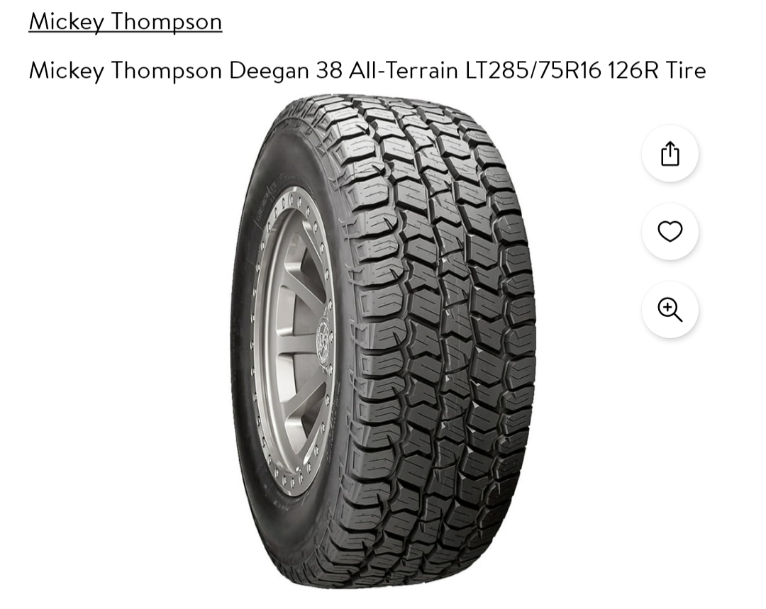

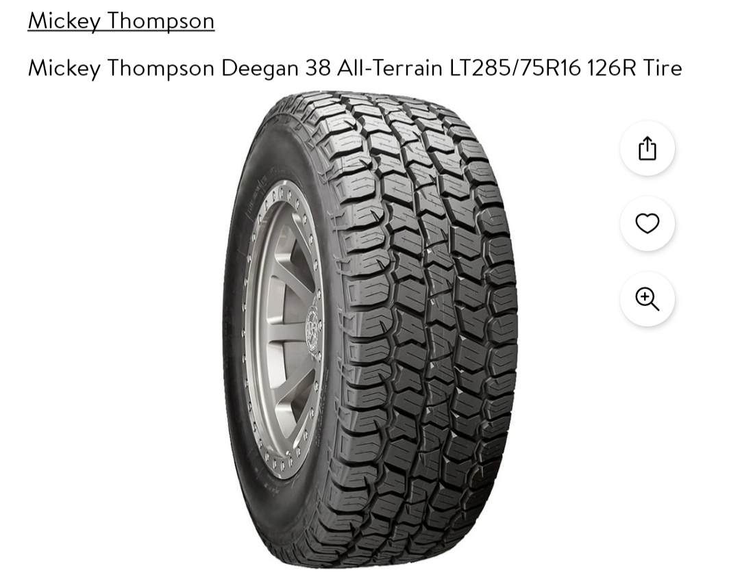

A bunch of great input, ideas and feedback. Once I find either a type of product or specific manufacturer that suits my mission (daily commutes and cross country towing), I will continue to use it until it is no longer available or the quality diminishes.
The current front runner is a newer tire from Mickey Thompson called the "DEEGAN 38 A/T"; the reason for focus on this tire is it most closely resembles, in both tread design and performance characteristics, the former high mileage AT I've used which after 19 years have just started to dry rot. The other side of my thought is that the Mickey's I have are great, long lasting and perform very well in their designed job.
What I do not know is which version is better suited to my mission, the Lt or the SUV version:
• 33×12.5r15
• 285/75r16
Unfortunately for me, I do not fully understand how the load rating will translate to premium function while towing a modest camper (2,500-4,000 lbs).
If I understand LOAD RATING correctly, I may be better off sacrificing ride comfort for strength. For example:
- 123 load rating will be a stiffer tire with improved stiffness/strength while towing
- 107 load rating will offer more comfortable ride when not towing
Do I have that correct?

The load rating isn’t 100% related to tire stiffness.
Tires with more cords in the sidewall are normally stiffer, so you get less sway and better tread wear with a load on.
Tires can have less sidewall cord and still have the same load rating. They’ll ride better empty but May be too soft with a load.
Oh 💩, are the 16" Ranger wheels 7" wide or are they 7½"?
It has been brought to my attention that a 285/75r16 shouldn't be used on a 7" wide wheel; what about a 7½"?
