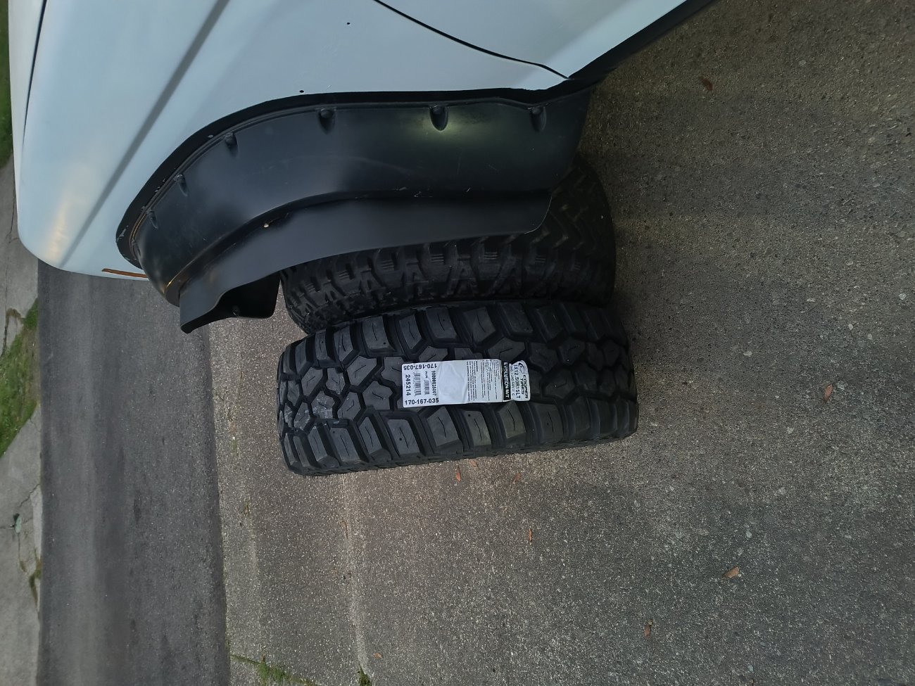

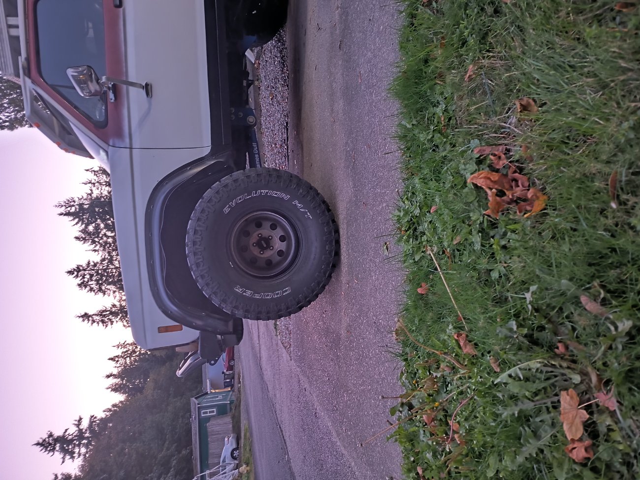

After all the research, daily checks on FB marketplace...I put The A.I. to work for me. As soon as The Amazon needed to clear their oldest set of Cooper Evolution M/T' s in 33×12.5R15, I received an alert. I wasted 37 seconds checking eBay and The Walmart against it, then immediately pulled the trigger.
They were my 5th choice but $300 less than my 1st choice used. Decided (with input) to go raised white letters (RWL) outward.
