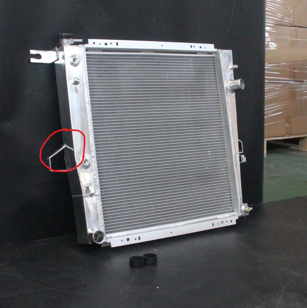

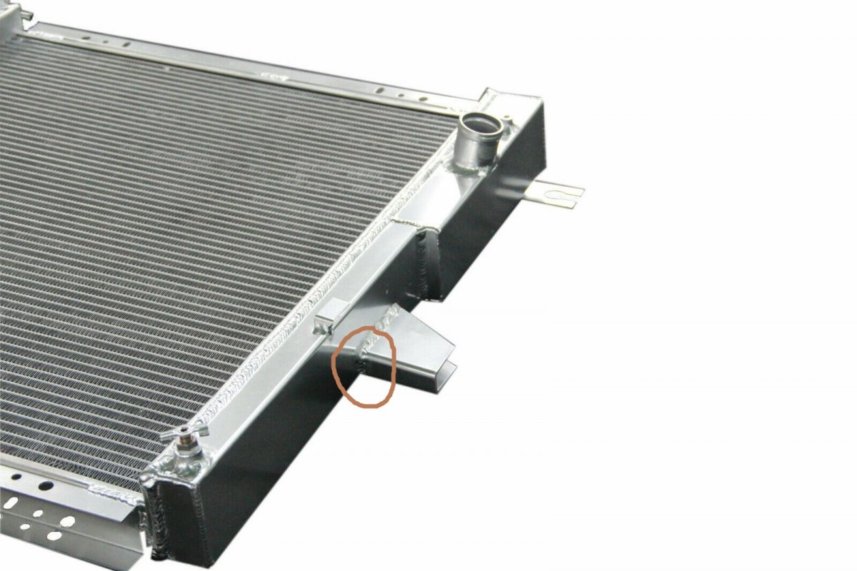

I believe this is the one I should have ordered, and I would have, but I just now found it. Notice that the lower mounts on the side of the tanks seem to be welded on flush with the front of the tank.
63732

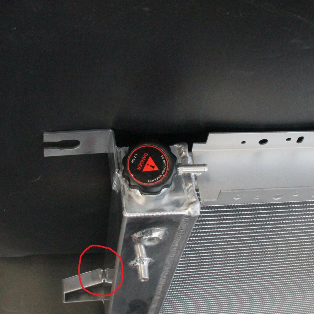

What's odd is that the one I bought, from the pictures on Ebay, the mounts also seem to be mounted flush with the front of the tank, but they're definitely not. I'm wondering if my radiator was welded up wrong.. Or, again, chinese shite from shinola.. Who knows?
Mine:
63733
63734
