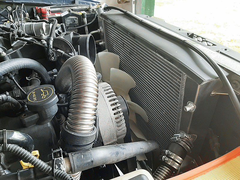

Your 2001 V6~4.0L~SOHC radiator problem seems near identical to mine just a year ago now.
Replaced the original 2RowPlasticTankedRadiator with a new 4RowAllAluminumRadiator.
No regrets,; should have done this years earlier.

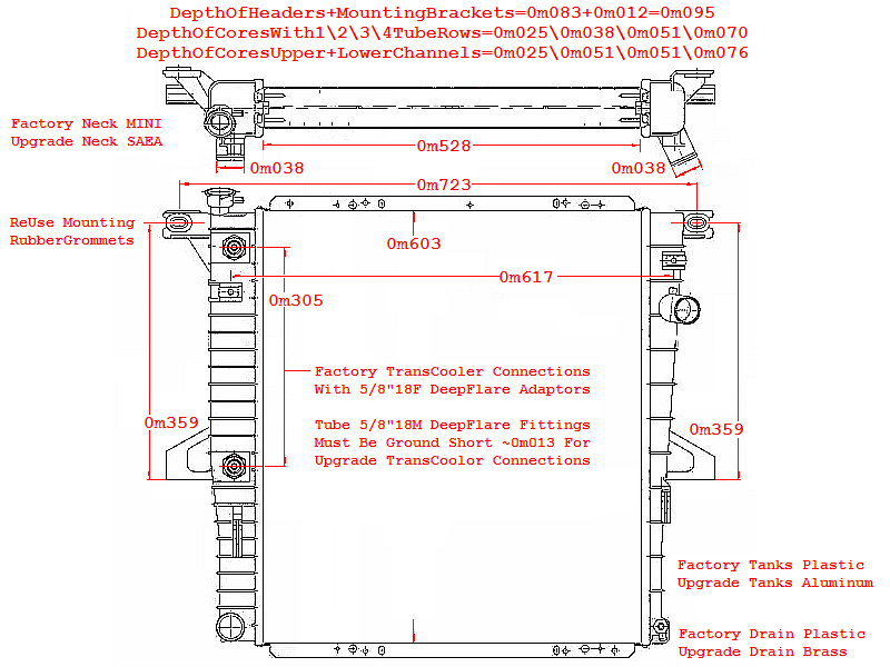

Noticed on another forum, you had a question about the TransCooler fittings;

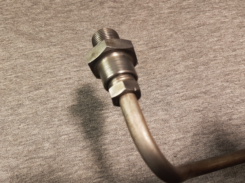

I ground the original compression fittings down by about a 1/2" & then they fit the new radiator,
& can still be used on the old style radiator if reverting back to that for any reason.
See the link below for detail pics on doing this.
Not shown in the pics, but also modified original 1piece fan shroud into a 2piece Upper+Lower;
got tired of wrestling original shroud around fan; easy access to belt\fan\clutch\pump now.
More info at link below

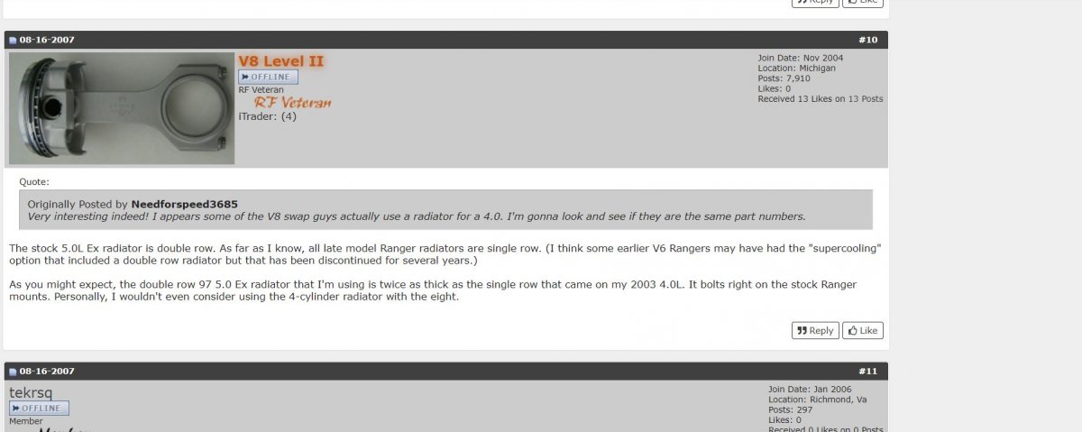

I found a write-up last night that stated the V8 Explorer 2 row radiator was a direct swap to the 2001 Ranger. I can't locate it now from my work computer. lol
O'Reilly's website says the Ranger radiator core is wider than the Explorer, its about a wash, one is 23.xx wide and 20.xx tall and the other is 20.xx wide and 23.xx tall.

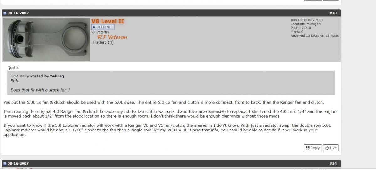

Found the post on another forum..

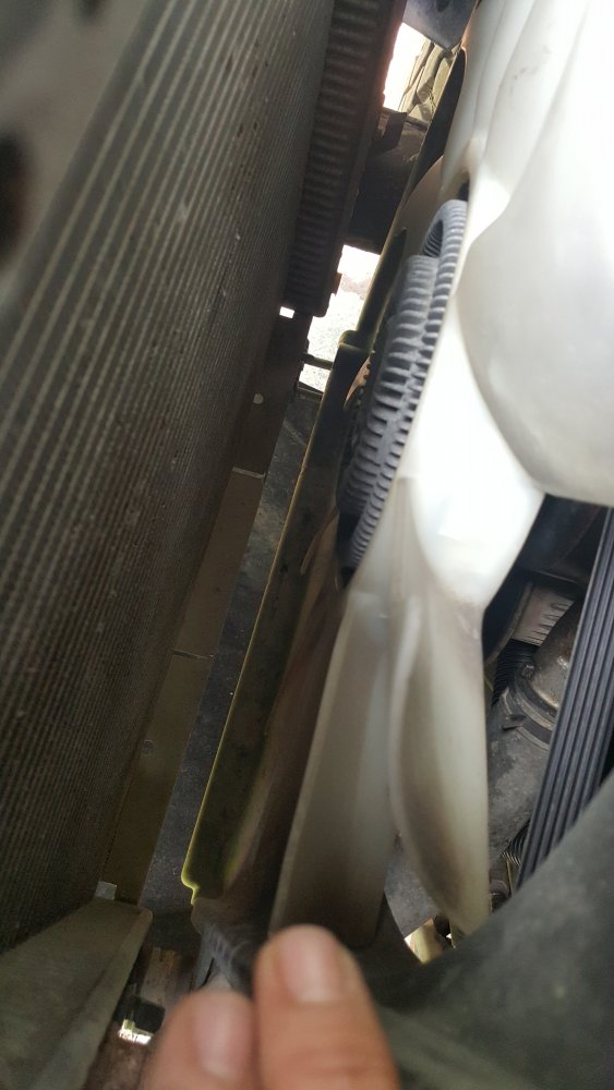

I have confirmed that there is enough room between the fan clutch and the single row radiator on my 2001 4.0 Ranger that I can go with a 2 row unit from an Explorer.

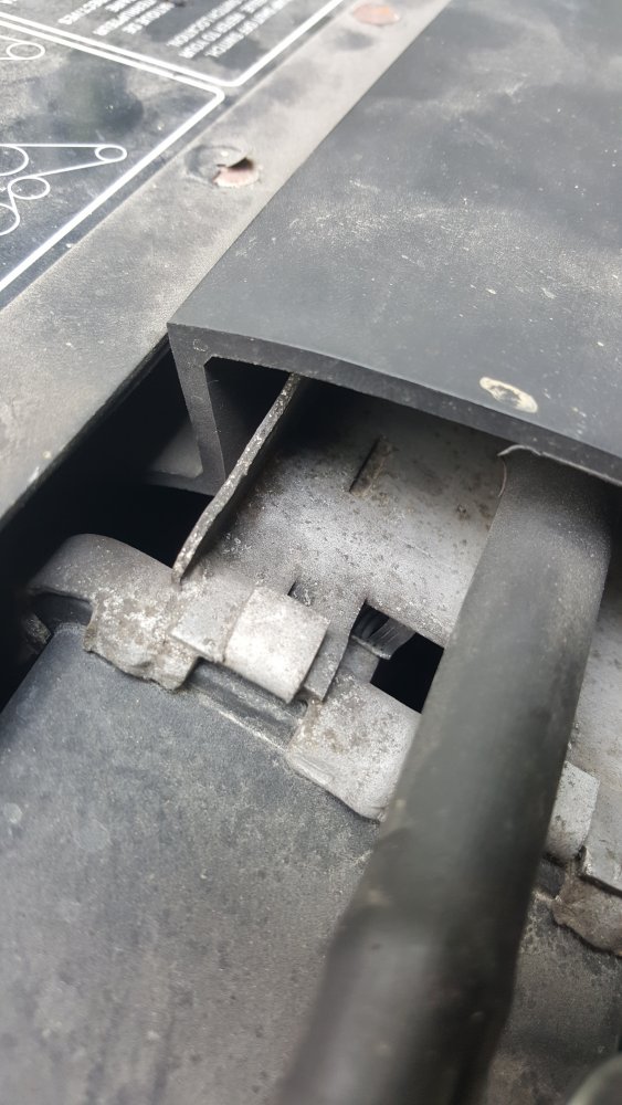

My single row with 2" or 3" top channel.

Plenty of room for a 2 row..

Best to measure & confirm that 2or3inch channel, then buy same channel depth, so shroud will mate up flush against new rad all around.
In your pics, the top+bottom channels look to be 2inch depth, but again "measure twice, buy once"!

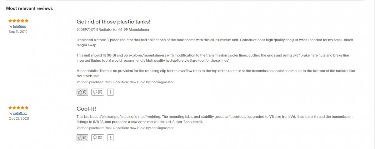

I also found this review from a fellow Ranger owner using the Explorer V8 radiator:

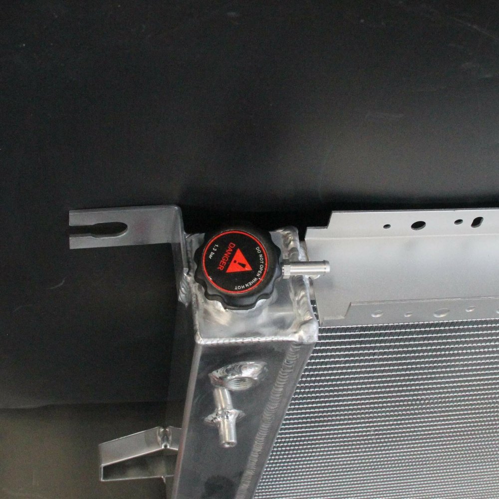

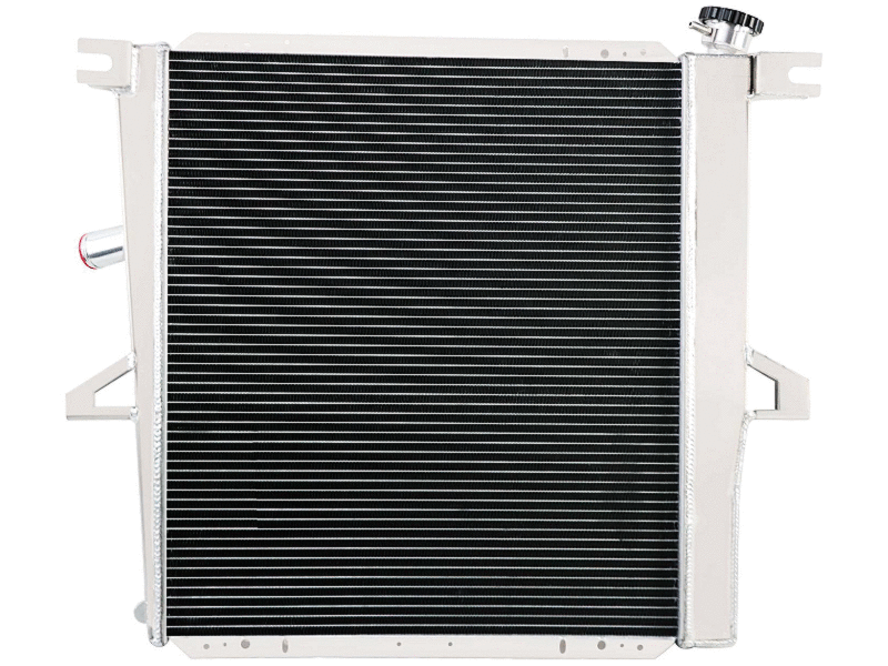

These frickin plastic tanks with crimps. I swear! But all of the Ebay Chinese aluminum units require cutting and re-flaring of the trans cooler lines. UGH! Why can't the Chinese get anything right? Not to mention the Ebay aluminum units also don't have the proper clips/mounts for the factory aux trans cooler lines on the bottom.
63358
Well, I ordered this 2 core all aluminum (chineseum) unit. So we'll see if the trans cooler fittings are a problem or not. I have sneaking suspicion that the fittings (nuts?) on my trans hard lines will have to be shortened some to seat properly. Fingers crossed!
The cores look awfully narrow, but they do look wider overall than my single core. The top channel looks to be the same width as mine. attachment points look the same also.

Very similar to my 4RowAllAluminum installed a year ago;
chinesuem, oh well, 99% of Ford parts are made outside of US these days.
Did have to cut off the end of the TransCooler tubes
grind factory extended barrel compression fittings about 1/2"shorter to the threads
then slip them back on & reflare the tube ends.
