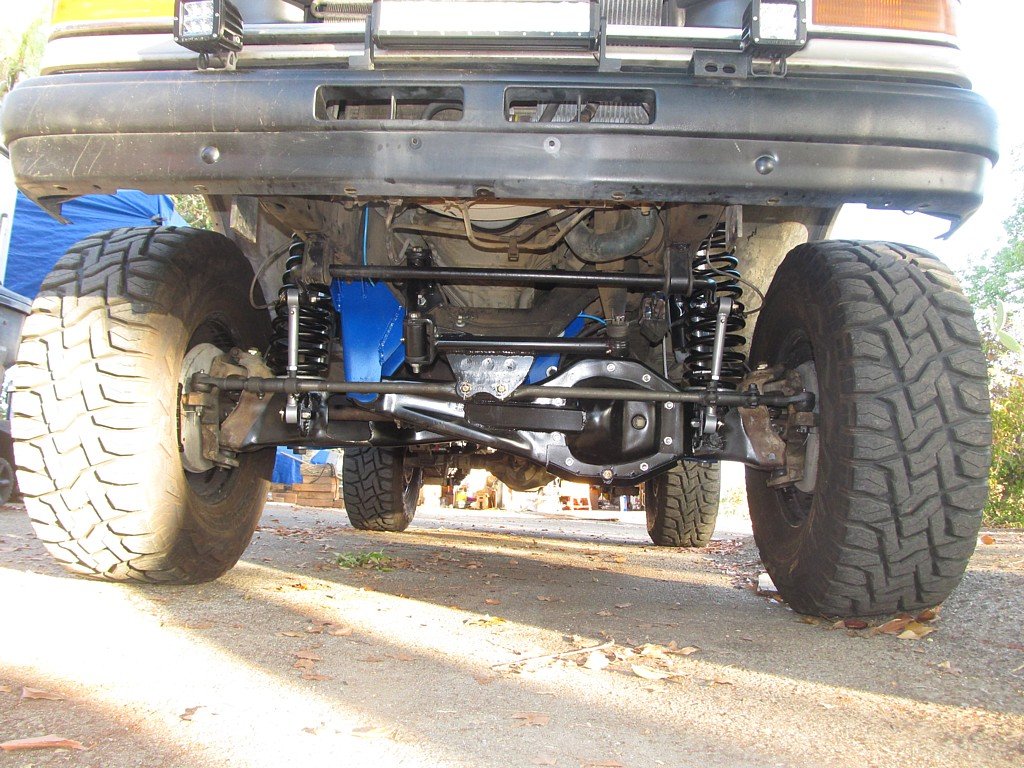

How do you think the easiest way to go about the idler arm is? Super runner is just a bushing setup right? I like how BlackBII did is, it looks strong and should last for a while. I have quite a bit of stuff left over from my SAS on my ranger. Haha So what your pretty much saying is that since the wheels are fighting each other, it’s basically driving up the suspension since toe and caster are changing so much, if I did a K link, that would take care of most of that. I really don’t see any other option. I think the stone crusher steer style isn’t the option from what I’ve read. I could lower it more and that would put my steering closer but I still think it’s going to do the same thing. It just needs more. I wonder how close the big bronco super runner is, but then again, what’s the point to cut down some parts, I can buy the builder parts for half of what that sells for…. Well I really appreciate everyone’s help. I’m just trying to keep this thing on the trail rubber side down haha

Personally what I would do for the idler arm is use a poly sleeve bushing at the centerlink end of the arm and also have a TRE at the pitman arm.
The frame mount end of the idler arm can be another poly sleeve bushing (a longer tube (3½-4") would be recommended though), or maybe delrin or sintered bronze bushings can be used there too.
My thought is a poly bushing at the centerlink end will make it much easier to get the centerlink to move without it binding vs. with a more-rigid setup at both ends. The centerlink end of the arm has far less moment on it than the frame end, and so should not allow significant fore/aft movement of the centerlink.

Like seen here:

That has always been one of the bigger reasons why I've always promoted the idea of building the TTB axle as opposed to jumping on the SAS bandwagon as was often the case some 20 years ago (the other of course being it's already there and (brake size excepted) is nearly as strong in the key areas that count as what many people were using to SAS with... a D44).
Agreed you probably don't want a swingset in the rocks, just due to the bends needed for it to clear the 4x4 diff. The K-link, while not quite "perfect" in the literal sense, can be built much stronger, since everything is straight (no bends) and will better-tolerate the forces put upon it when your tire jams up against a rock.
I think you'll be quite pleasantly surprised how much better your truck handles if you get the K-link on there successfully. :)
